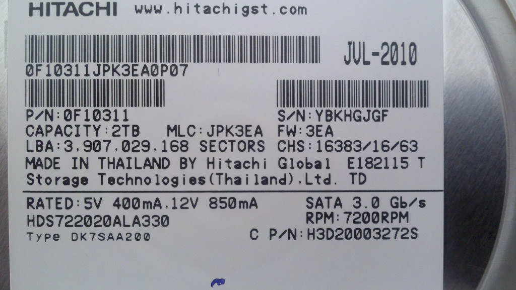

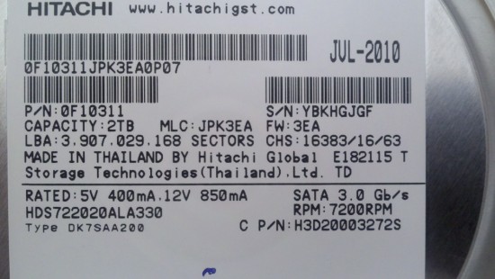

here are the informations written on the drive
HITACHI HDS722020ALA330 2TB SATA
Processor: LSI MUSE-B2B2-L 0A71261
P/N: 0F10311
MLC: JPK3EA
Firmware: 3EA
Date: APR-2010

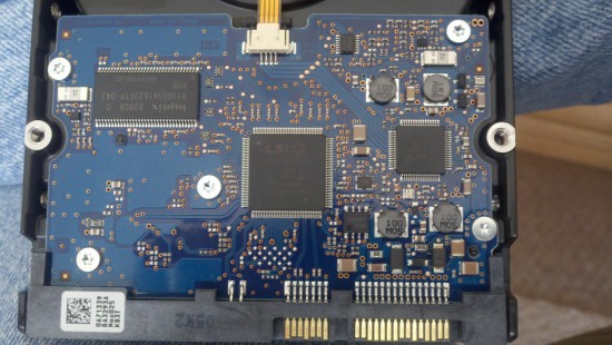

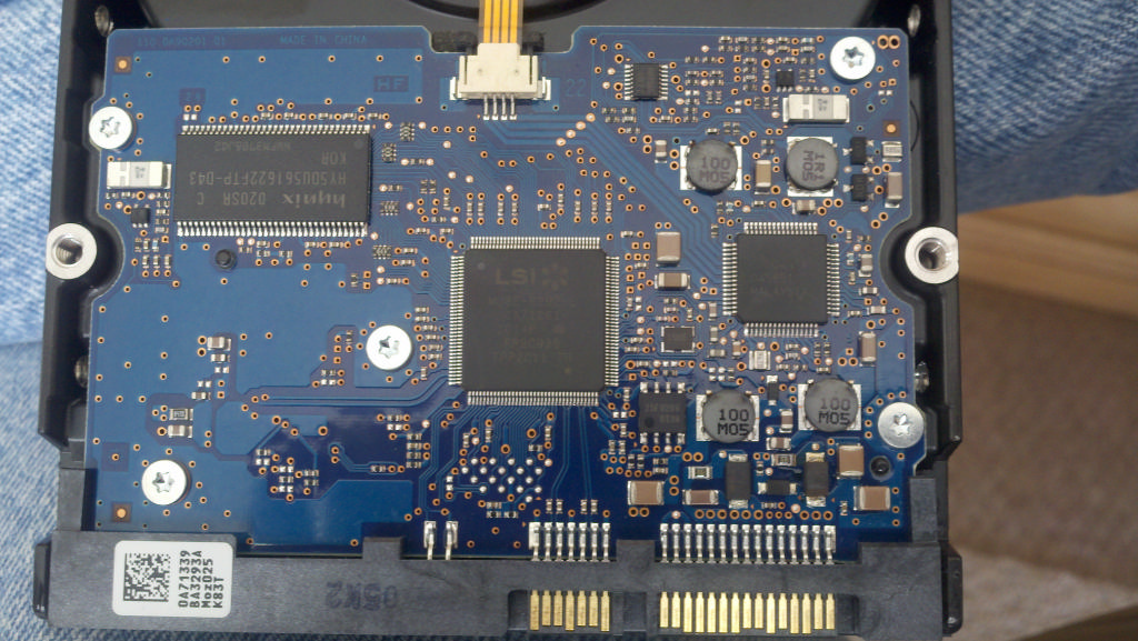

and here is a screen of the PCB
Number on the barcode :
0A71339
BA3293A
So I have another Hitachi HDS722020ALA330 which are currently working properly with close infos
PCB screen
I have tried to swap the PCB board from my working disk to the patient and the HDD starts and spins again without stopping...
So I understood it was probably a PCB problem.
I put back the PCB on my (donor) working HDD which continue to work properly.
I realize after reading this forum this could damage the NVRAM and/or the preamp chips on both drives, is that right ? I do not understand clearly why ?)
Do you think it could have damage my patient HDD (my donor PCB seems to continue to works properly)
After I continue, and had a look on the wrong HDD and I noticed on the PCB that a component was missing or has been torn or unsoldered (surrounded in red)
it looks like a capacitor.
PATIENT PCB
DONOR PCB
In the meantime I have tried to find another Donor PCB closer than my failed HDD mainly with the same firmware version and same MLC and also because I don't want to sacrify my working PCB by swapping the NVRAM from the patient to the donor
I have found one (that I am waiting for)
New Donor PCB
P/N: 0F10311
MLC: JPK3EA
Firmware: 3EA
Date: JUL-2010
0A71339
BA3293A

- Is mandatory to move the NVRAM from the patient to the donor even if the parameters of these two drives are really close ? if yes can someone help me to
found it (I have surrounded in green what I thought the NVRAM)
- Would it be faster/easier to solder the missing capacitor on the non-working PCB ?

Clearly you do have a PCB fault, and yes you do need to move the NVRAM (which you have correctly identified) to your donor PCB.
The reason is that this IC stores unique "adaptive" data. In particular it holds the location of the System Area which is different for each drive.
