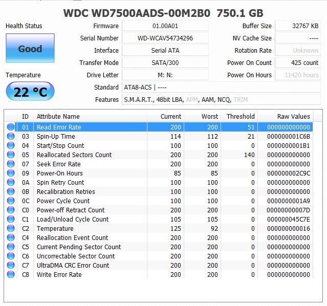

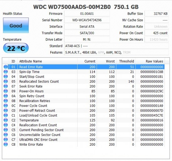

 Post subject: Re: WDC WD7500AADS-00M2B0
PostPosted: March 2nd, 2012, 13:38
Joined: March 1st, 2012, 16:21
Posts: 10
Location: Russia
This is what you needed?
PostPosted: March 2nd, 2012, 14:08
Joined: May 6th, 2008, 22:53
Posts: 2138
Yes thanks. Very interesting - I see no indications of the disk noticing that it has a problem... (I see just the common excessive load/unload cycle count, due to the idle timeout period being too short - but that would not affect speed during a file copy, for example.)
Therefore please reply to my earlier questions (a) & (c) and also I am adding these questions:
d) What is the history to this situation? Has this disk always been installed in this PC? What has changed in that configuration shortly before this behaviour started?
e) I suggest you run a graphical read benchmark on the disk, and look at the shape of the graph. Are there any significant "dips" (slow speed sections)? If you repeat the test, are the dips always in the same place (same LBAs)? Slow areas of the disk (i.e. internal disk problems) will usually appear as "dips" reading the same LBAs when the test is repeated. Problems caused elsewhere (e.g. slow system, SATA I/O problems etc.) will usually cause "dips" in performance to appear at different places (different LBAs), when the test is repeated.
Based on that SMART data from the disk, there might be no problem with it (although such a problem cannot be completely excluded in this situation). That is why I am suggesting to look for other evidence. Another simple approach is to move that disk to another system, and put another disk into that system - does the "slowness" move with the disk into another system? Or does the "slowness" stay with the existing system, even when testing another disk?
I hope that gives you some ideas about how you can make progress with diagnosis :-)

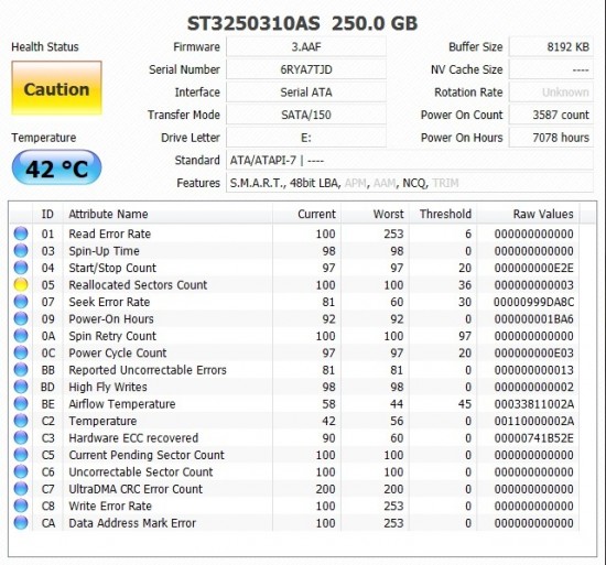

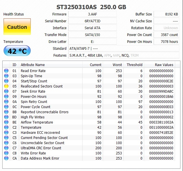

PostPosted: March 2nd, 2012, 14:30
Posts: 10
Location: Russia
Well the thing is that I just bought it from someone, I could return it to him , but it was a fair price especially now with the overpriced market and I really need some storage to clean my other hard disks and a bluray writer its not in the plan right now. The strange thing is that I just saw crystal saying that another of my harddisk has a problem but I never had any errors copying or accessing the data from that one.
PostPosted: March 2nd, 2012, 18:43
Posts: 2138
CrimsonW wrote:
I never had any problem with other disks on my sistem, including some wd. The hdd regenerator test I did it on another computer, so there were problems there too with the "slowness"
You are choosing not to answer several of my questions - that's fine, it's your issue, so you investigate it as much as you want to. :) I will just say that, from your comment above, the cause of the slowness now seems clear. Some of my previous suggestions would help you to confirm your answer above, if you want to.
Good luck with whatever you choose to do!

The 250gb disk , the one that its showing me that it has problems was disconnected when I used the 750gb western digital and experienced the problems I told you about.
