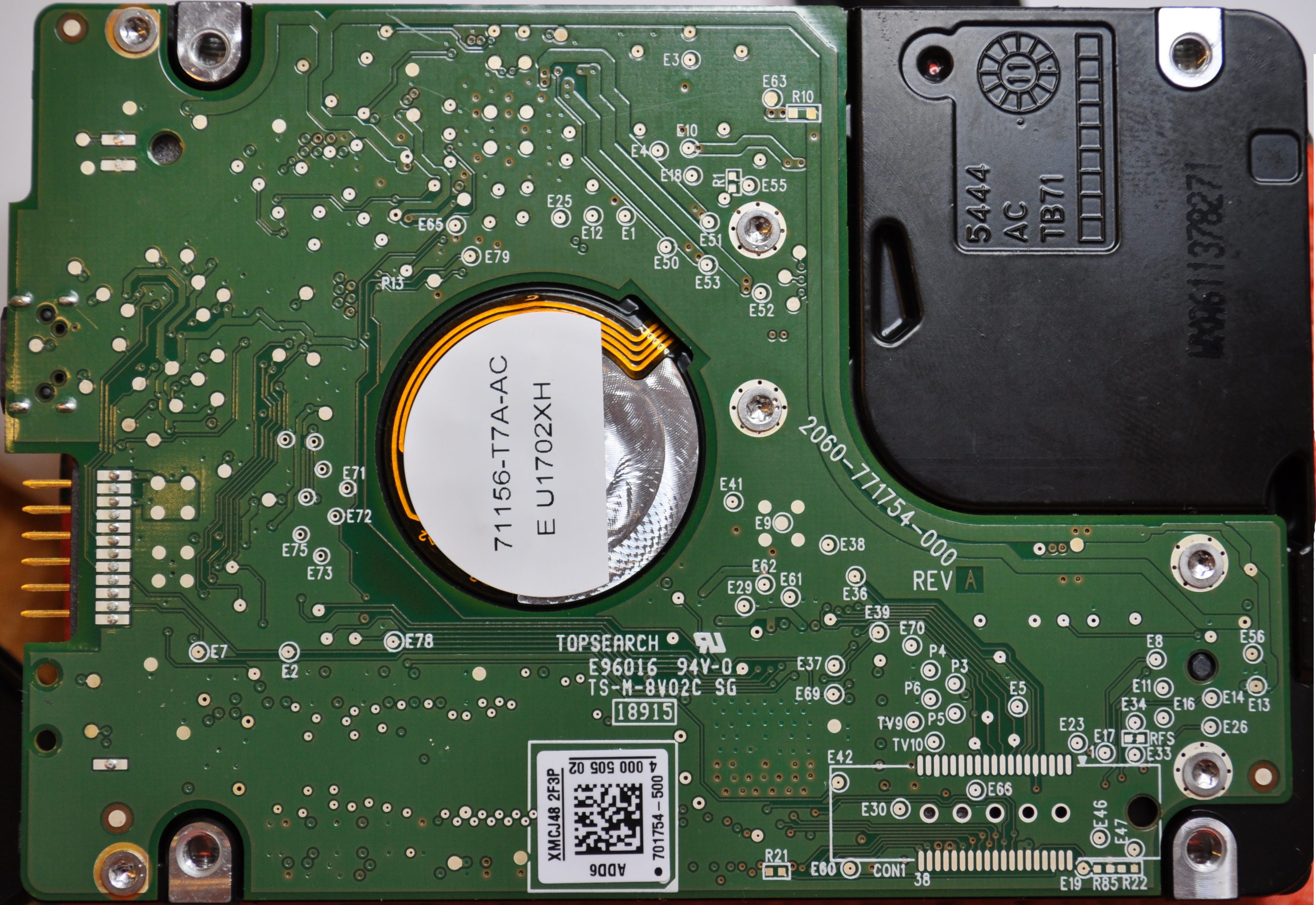

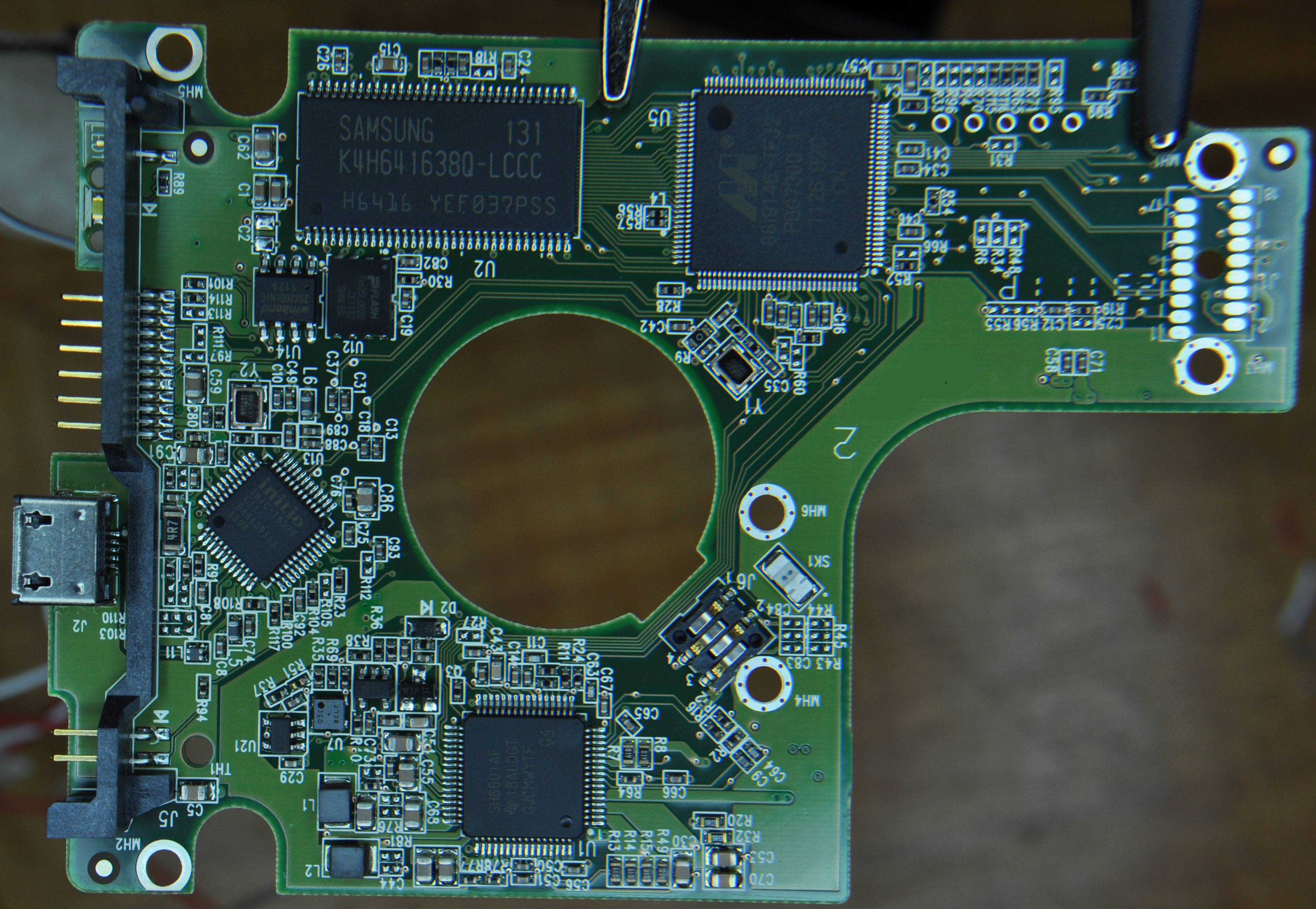

Hi guy i am wondering if somebody can point me in a good direction.
I found tx+/- rx+/- but i coudn't find GND.
THis is a new model of pcb from WD7500

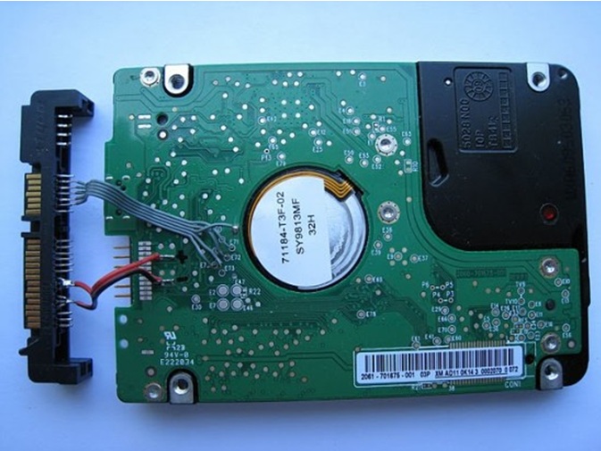

Couldnt you use any ground point?
Or
 Post subject: Re: WD usb to sata new model of pcb
PostPosted: March 8th, 2012, 7:11
Posts: 441
Location: italy
Hi Loki, i did follow that schema indeed.
but i have got no good result. i am thinking this version of pcb has got something different for tx-rx than usually E71,72,73,75 point...
if u look my pcb is different from that one...
PostPosted: March 8th, 2012, 7:58
Posts: 2984
Your PCB has code 771754. You can use SATA PCB from SATA Zephyr model , like WD6400BPVT-22HXZT1 for example. Should have PCB Code 2060-771692-005
PostPosted: March 8th, 2012, 10:00
Posts: 441
Location: italy
thanx, but something is not working.
i used a Zephir-one (what i have in stock is WD5000BPVT-00HXZT1) and drive is clicking.
i also noticed that patient drive is not a Zephir, but a Helios.
