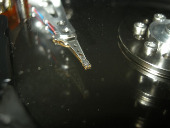

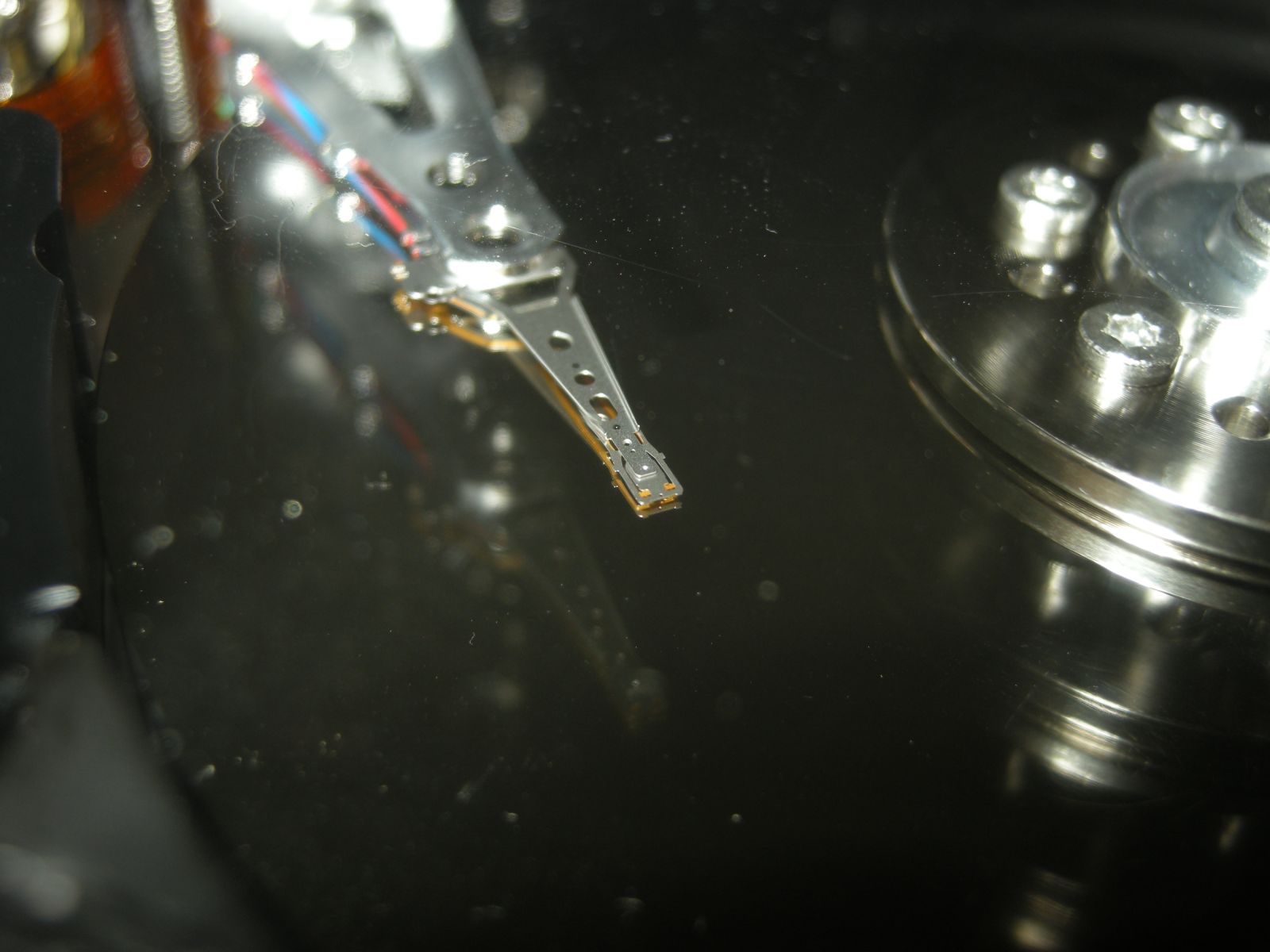

I was at my buddy's inner-city dump apartment and we decided to convert the (A&E's hoarder style messy) bathroom into an impromptu clean-room. Clean enough to operate on a hard disk!
Granted we cheated a little, and used lower density WD 60GB drive. A standard desktop drive, a child of the early 2000's to be sure. We choose this because it is "loud", the heads move with a certain style of slowness, it is big, and impressive. Impressive for a standard-size desktop drive that is. Impressive when compared against a modern solid. And with the low density, we figured we'd have good success with any lingering dirt getting jammed in the heads. And it responds well to acoustic management software, software that changes a setting (temporarily) in the hard disk to slow the heads to a sinusoidal accelleration pattern as opposed to a bangbang square wave pattern.. ah, yeh, well now once the cops cleared out of the other unit we got started.. you know..

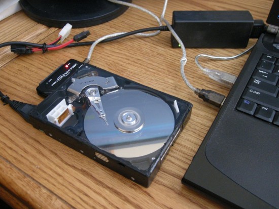

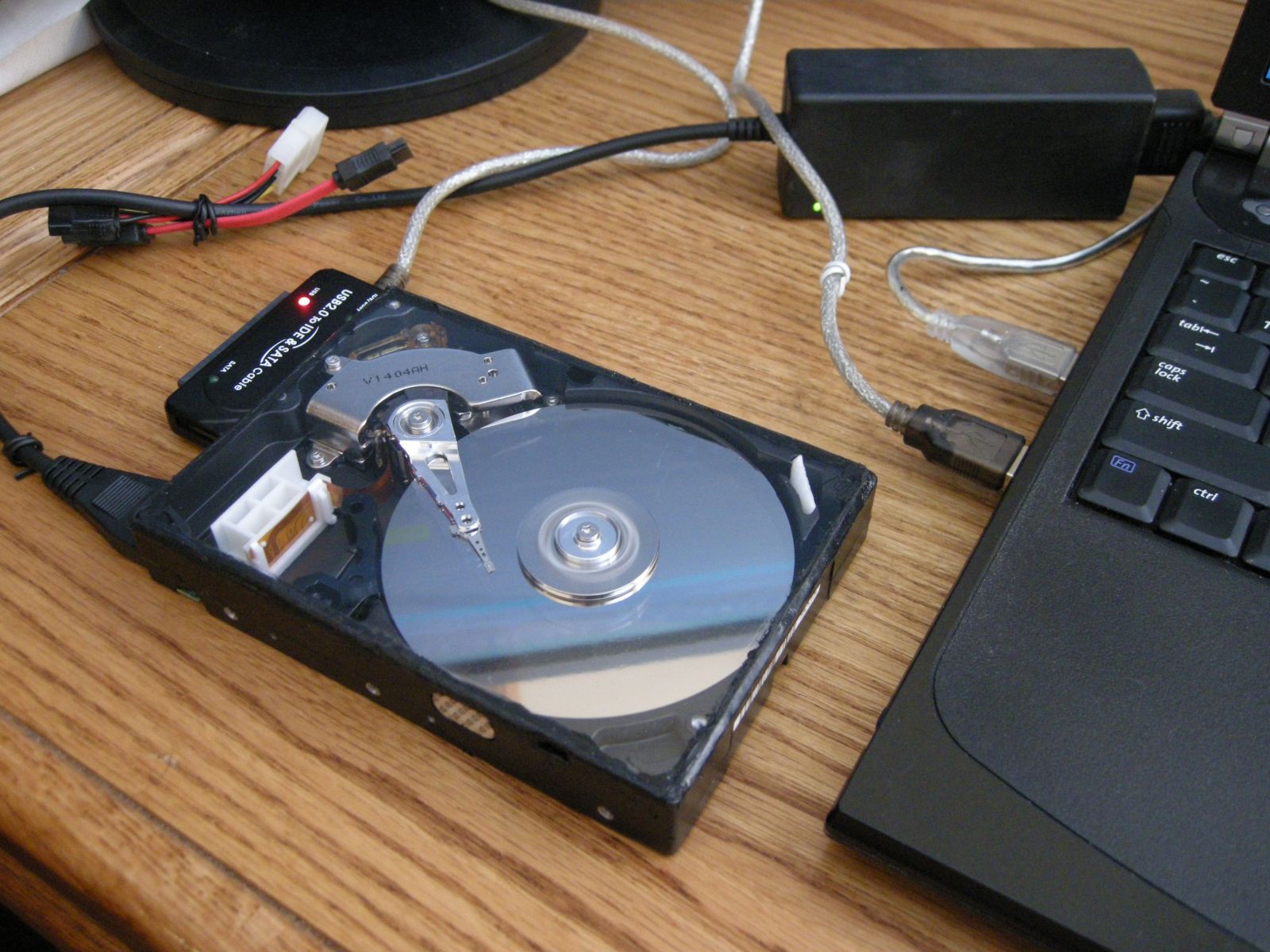

First a few key things first, we cut up the food containers till we got a sheet of plastic the size of the drive, we lined the edges with silicone sealant, and plugged the extra holes (save for one) with silicone as well. Also, I kept the drive's internal air filter sealed and working, though the external one, the one that lets pressure equalization happen, I replaced with a wad of cotton stuffed in the corner, ventilated through a screw hole, and sealed with more silicon.
We made the bathroom room steamy and blasted the dirt out with window fans and pressure nozzle from the air compressor tank. And I worked on the drive upside down. Any dirt trickling down through the air didn't have much chance to hit the platters. Well, it all works cool. I worked upside down laying in the scum on the bathroom floor. We screwed in the screws as if we were mounting the drive; but used that as an anchor point for some twine. We suspended drive, like a helicopter rescue basket thing from the exhaust fan. We suspended it upside down, so that the platters and exposed innards were facing down. This was another precautionary measure against dirt. I don't know of any dust particles that have pilots and jet engines saying whooooaaa there's a hdd platter, punch it! Dust and crap in the air would fall harmlessly around the drive and not reach the insides.
I cut out a sheet of plastic material from the half-eaten meal and scrubbed it down quite thoroughly. I cut and trimmed it according to an outline I made from the removed drive cover. I lined the edges with silicone sealant and pressed it onto the hard disk. I used a silicone sealant that has no acetic acid outgassings. Such products are hitting the market now, at the low-end consumer level like wal-mart and such. And are still cheapo at under $5.00 a tube! In fact, I had gotten the stuff without realizing it! I applied it and wondered where the stink was, and said to myself this is great! I snorted it quite a bit in trying to detect the odour. No acid to erode the metals..! So if I can't smell it, neither can the electronics! Either way, a few cycles of the drive and running it warm would dissipate any malodorous fumes anyways.
I thought of using RTV-732, but a ghetto dwellers woudn't generally have access to that stuff, so I limited my materials shopping to wal-mart. Remember, this *IS* a low-class budget mod.
I was also sure to power-up the drive with it in the suspended position. Again, for dust protection, any material that might have accumulated on the plastic clear cover stayed there. But when the drive spun up, the air currents whisked it away, at breakneck speeds, right into the pillow filter. We tapped it and bumped it around, relying on the inner air currents to carry away any stray particles. I also massaged and pumped the drive a bit to release the silicone glue outgassings. Not to hard as to effect major air pressure changes, thus changing the flying height. Nice and gentle.
Later on .. I have had the drive running the ultimate defrag all morning long, and so far it has 4+ hours of non-stop copy-delete operations going on. It even loads Stella Atari 2600 VCS gaming emulator and I was playing Slot Racers and Bowling!!! Games from 1978!!! It passed mfg surface certification too. I ran the WD diagnostic utility. And also synced up a bunch of files. So looks like a successful project. The point of doing this in slum project housing was to demonstrate that anyone can do it, anywhere. Really. Anywhere. Anytime! Would I trust my important data to it? Absolutely yes. With appropriate backups. As should always be the case.

The above two pics are of the finished drive, any dirt you see has quickly settled outside the drive, the inside *IS* class-1 cleanroom quality or better!!
The upshot of modding it this way is that you get a full widescreen view of the drive, complete, you see everything from all angles, unlike the WD Raptor. The window on that drive hides half the viewable area. AND the thinner plastic material used in my project provides for better heat dissipation. Additionally the drive is a little louder, you can hear the swirling air so much better.
Not only that, this is extremely educational, you can see the head move and access the $MFT, and then your files. Look at the track and sector accesses! You do the ultimate defrag and put your operating system files on the outer edge of the disk for faster access, and your least used zip files and .pdf's toward inner part by the spindle, the slowest part of the disk.
When running a surface test you can see the head move slower than the minute hand, but yes you can really really see it move even then. Far better than any drive activity indicator light!
