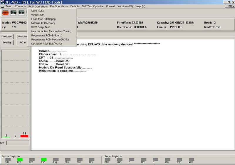

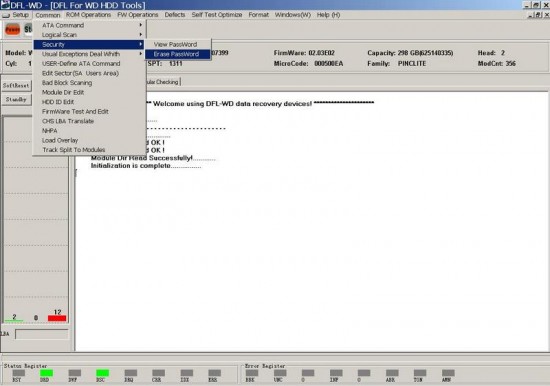

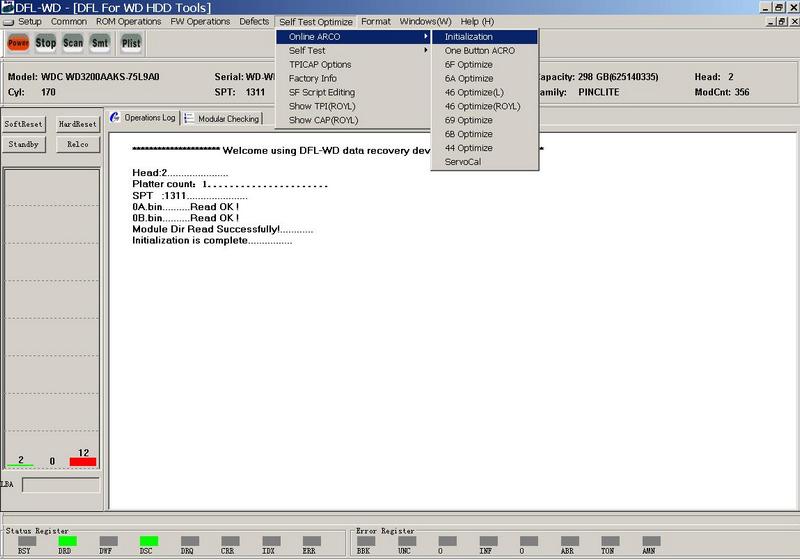

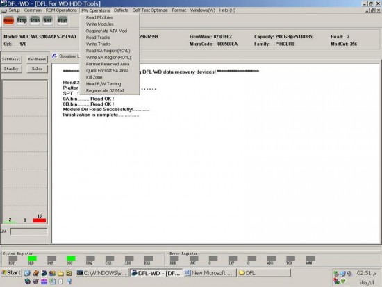

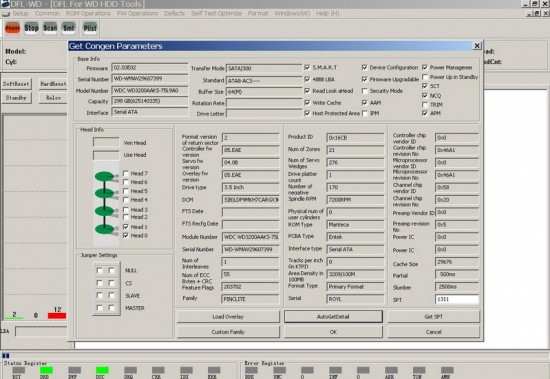

I Test the DFL tool for WD and here what i found about

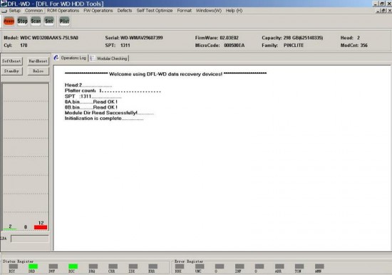

First , here is a general look for it's functions and advantages

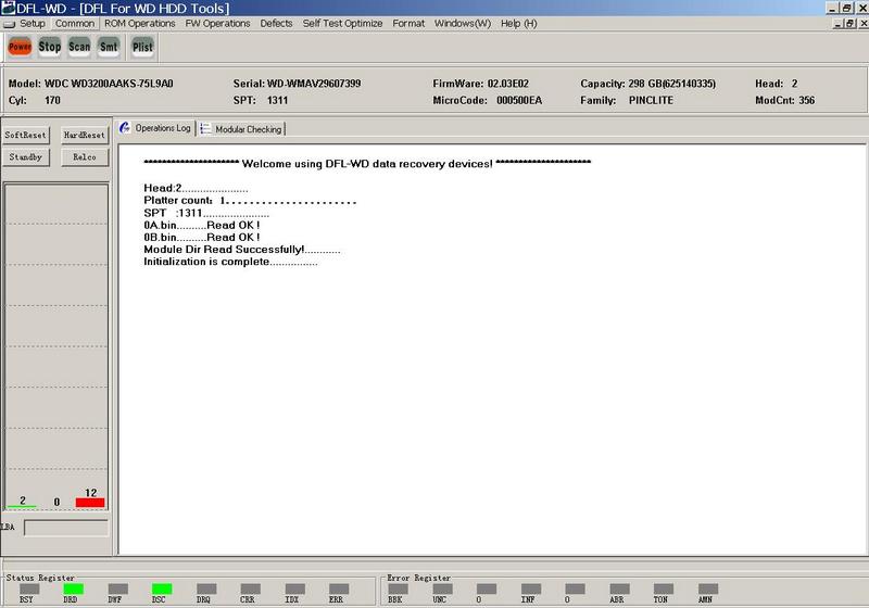

1- this is the start menu
it all you to get details about the drive and auto detect it in normal or kernel mod and to load overlay with 011 module
2- the main menu of the program .to start dealing with the drive

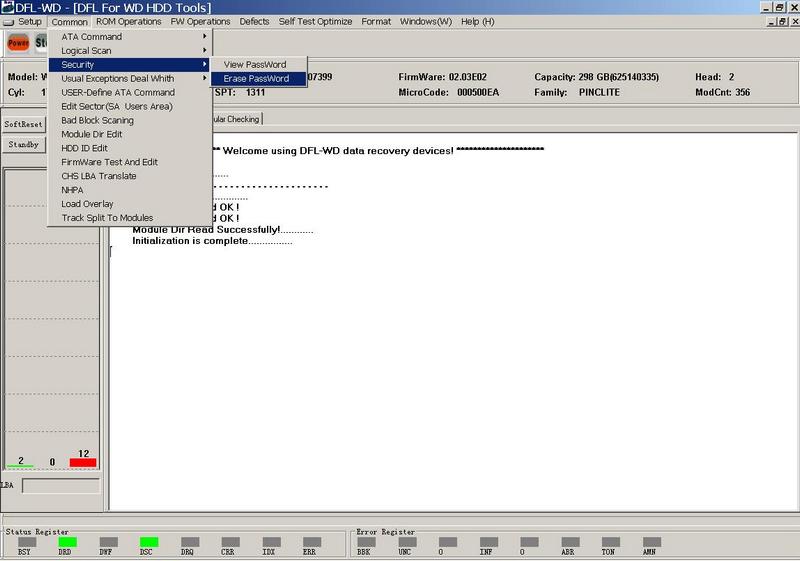

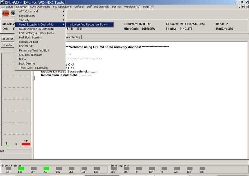

3- the fist menu is common

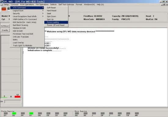

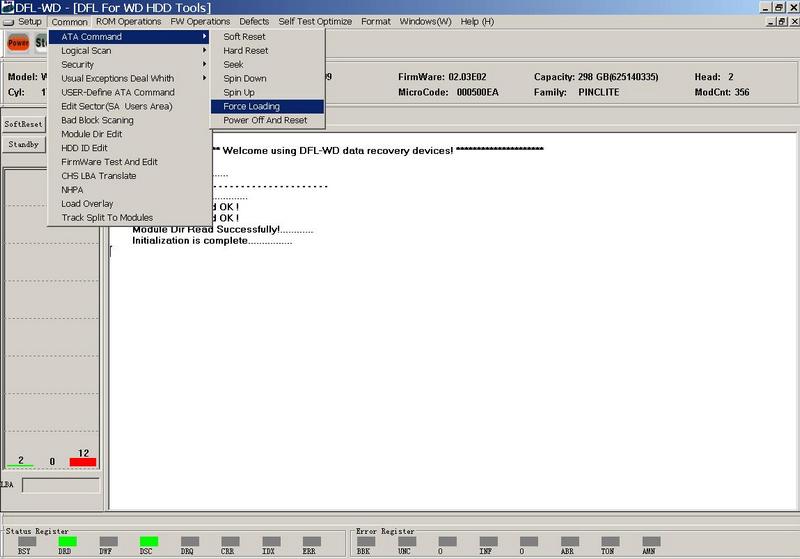

A- you can use ATA command here to force the drive to power up even if you are in kernel mode with the 3 jumpers
B- logical scan and it allow you to add bad tracks to p-list

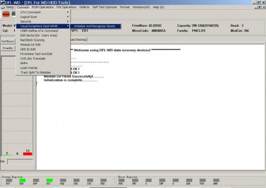

C-security to view and erase password
D- to resolve the slow problem in hdd with pcb 701640

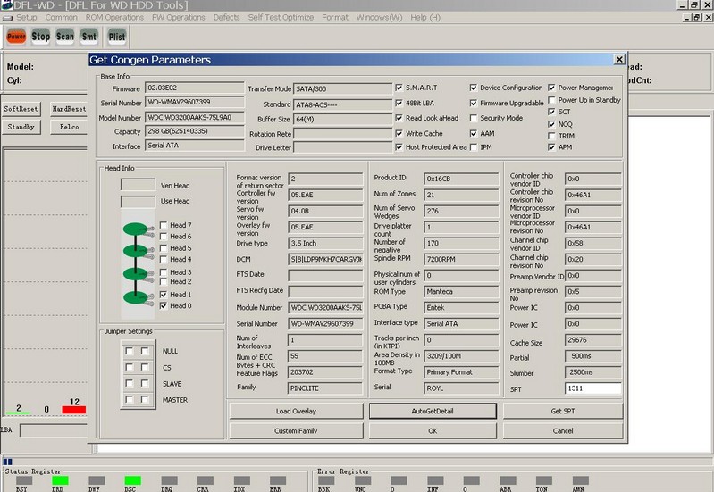

E-user Define ATA command to type commands by your self
F- firmware test and Edit " edit modules and tracks and Rom and ram and ABA in hex
G- bad block scanning in the drive
H- NHPA to set max
I- load overlay with 011 module
J- Track split to module allow you to get the modules from the tracks this one is new

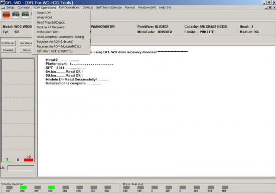

4- Rom operation
A- Read and write Rom and it's modules
B- head map edit and depop allow you to depop head even in new Marvell and it works fine
c-recover the original 47 from the SA
D-Rom deep test . can test the structure of the rom file to let you know before re-flashing it
E-Head adaptive parameter tuning " microjog "
F- Regenerate rom for L- shape pcb and royal
G- directory Start address allow you to Chang the Start address in the new wd drives that come with " no Device error"

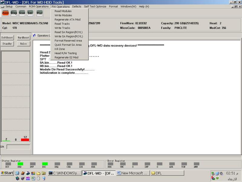

5- Fw menu
allow you to
A- read & write modules and tracks and SA region very fast actually than any usb Box work with WD i ever test ,specially about tracks
B- regenerate the ATA if it damage from the SA " i like it "
C- format SA , alow you to format the hole SA and rewrite it again
D- regenerate 02 module
E- Kill zone " split your data aria to about 20 part you can delete any part of them " i like it "
F- Read write test , it's here areal test for the head

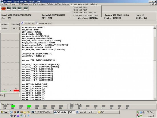

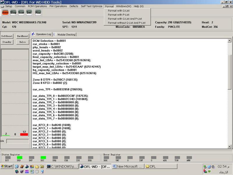

6- format menu
to format the drive with p or g list or with both or with out

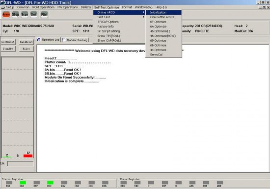

7-Arco
and its here along story and actually very Active and online " i like it"

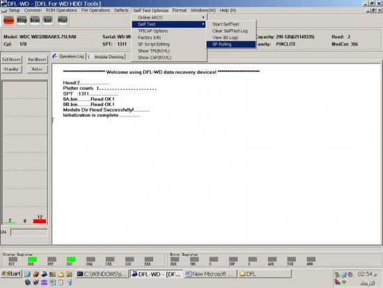

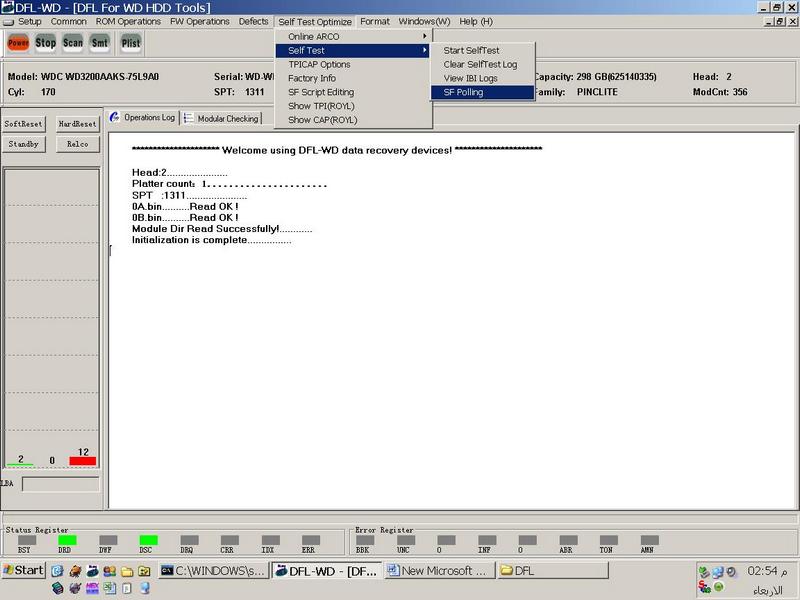

8- Self scan
it's real professional here and active view and it's script is very simple and you can use the factory info to arrange it or do it your self
