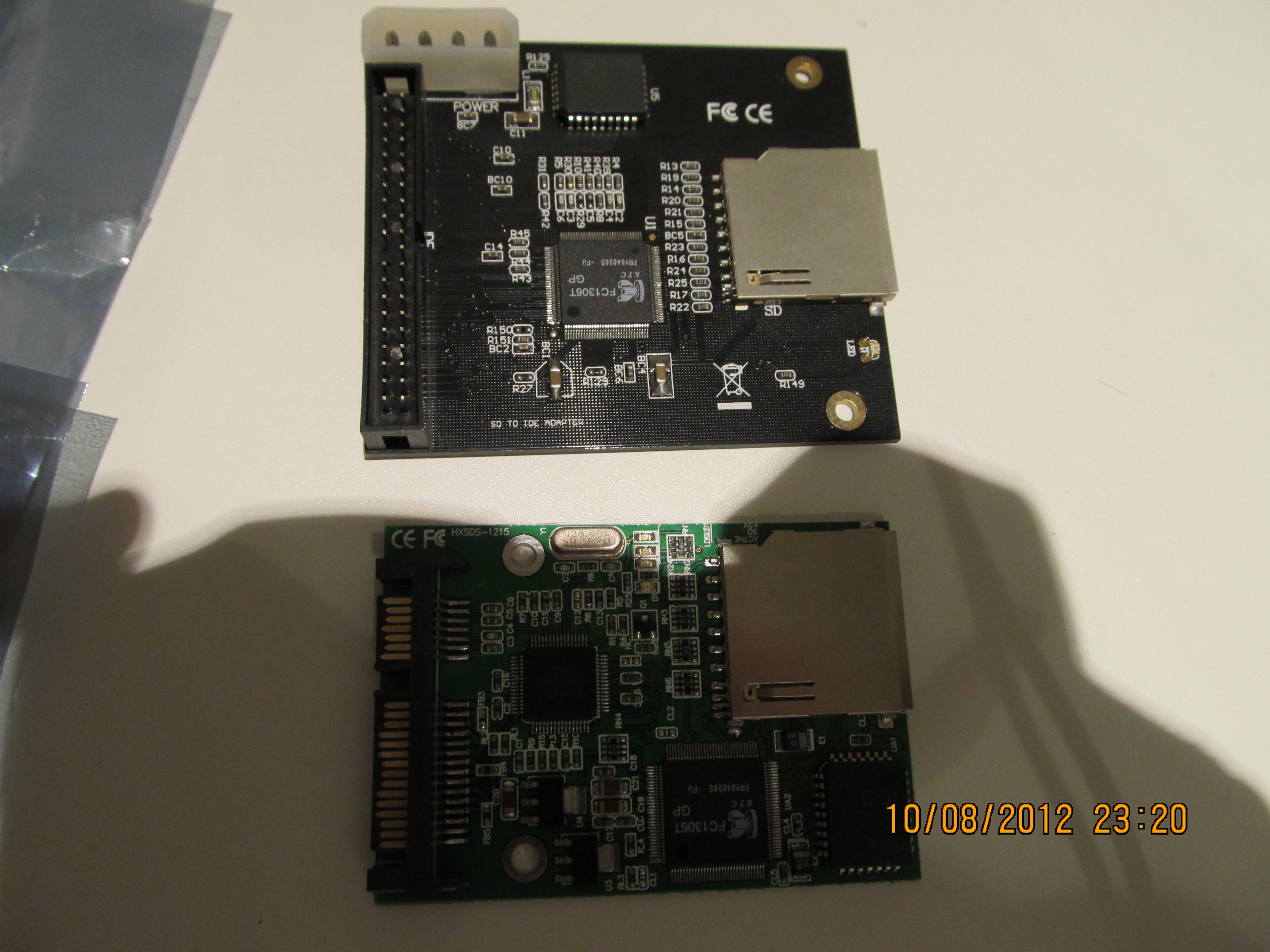

I guess this MIGHT solve your issue here
Am using it btw
hope will work with u
good luck

That's an interesting idea :) (depending on available physical space for the adapter etc. of course).
To help with however much of the OP's problem is being caused by the fixed vs. removable issue (and I remain unsure whether that is 100% of the OP's problem(s) or not), a colleague gave me the below link to an "active" CF-to-IDE adapter which is advertised, that claims to always report that the CF card is a "fixed disk" to any OS, by modifying the card's response to the Identify Device command, before passing it to the OS. However, as explained in the links I gave above, there are several other possible issues, and without specific test results from the OP's cards, this type of adapter might be a waste of time. :(
In case it's of interest to the OP, here's the link I was given - note that neither I, nor my colleague, have tried this adapter; he was just aware of it and gave me the link when I mentioned this topic:
http://www.jschoenfeld.com/products/trueide_e.htm

it does WORK btw, some time ago i was using it in VoIP machines, with 256MB card,
booting the machine in Linux with the VoIP app.
the image i sent is not the adapter i ment, but i was referring to the IDEA only
good luck :wink:

Einstein9, I believe that there are two differences.
1.The adapters you show have active components that can report the disk plugged in as Fixed.
2.Linux.
I have no experience with Linux, but have read that it will allow access to partitions
on removable disks, whereas Windows XPe won't.

Have SD->IDE readers ever worked for you for data recovery? I've never had any luck w/ them.
