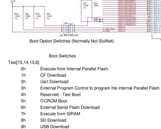

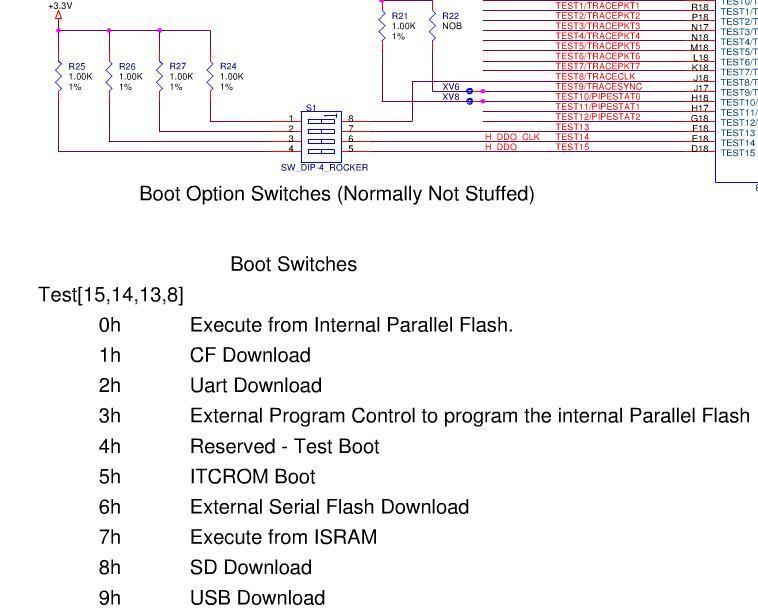

Posts: 1091
Location: Angel Data Recovery
Angel Data Recovery
 Post subject: Re: Marvel Bootstrap analysis
PostPosted: March 15th, 2013, 8:49
Posts: 3592
Location: Chicago
The numbers are usually different on different models

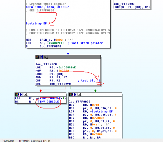

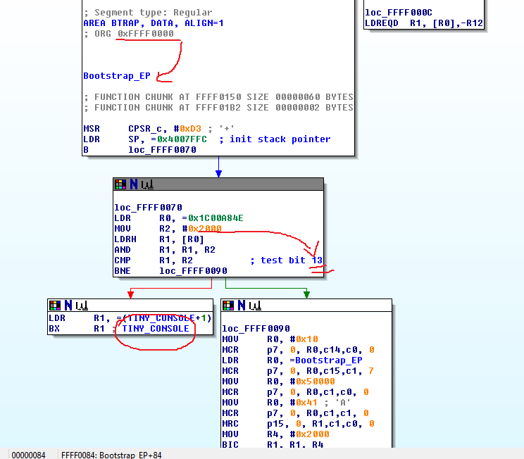

the few bytes of a ROYL bootstrap...
it reads a word from port 0x1C00A84E and check for the bit 13. if the bit it's set..it enters in console mode where you could r,w memory.
