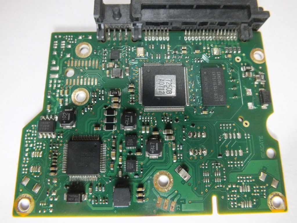

I went to specialized service and they said me, "the eeprom is dead". I attach a generic picture of my PCB. In red the chip that specialized service call eeprom.
is that the rom chip?
is that the bios?
in blue arrows the pins without measurement.
thanks

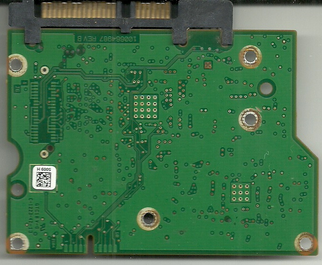

Here you are the pics.
The original rom bios is in a new PCB that gives power to the HDD but windows does not recognize it. neither windows nor linux can see the data.
It was difficult to remove the PCB and take the super macro pics.
Sorry for the delay.
thanks

If drive with new pcb spins without any clicking sounds it means that rom transfer worked good.
If you can't see the drive in windows it means that there is another issue elsewhere on the drive.
Is the drive with new pcb and original rom detect in the computer bios?
