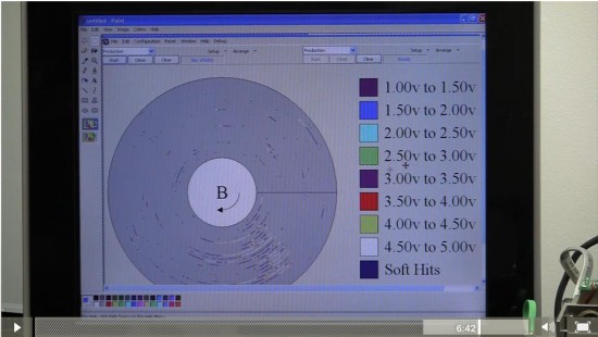

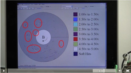

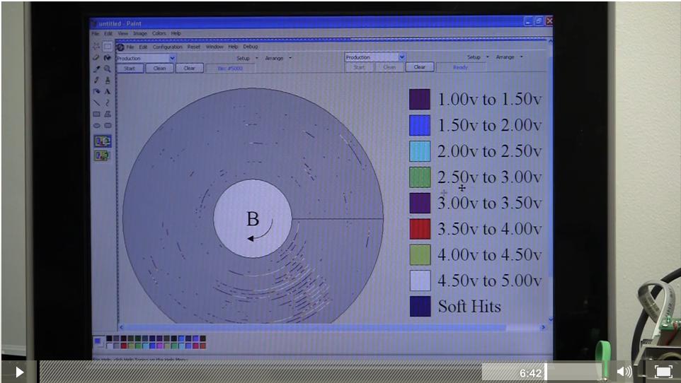

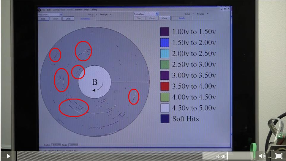

i don't know how much is the cost of this machine, but by watching the video i would say: even if you pay me i don't take it"
IMHO it's nothing more than a software designed to randomly draw some lines on the screen (i don't know why the entire machine is needed, can be done on mspaint, (for more sophisticated, you can use photoshop :lol: ))
and the reason for that is: see for yourself
before :cry:
after :lol:
so...
like i said can be done with MSpaint or photoshop, no need to spend so much money on the machine :mrgreen:
