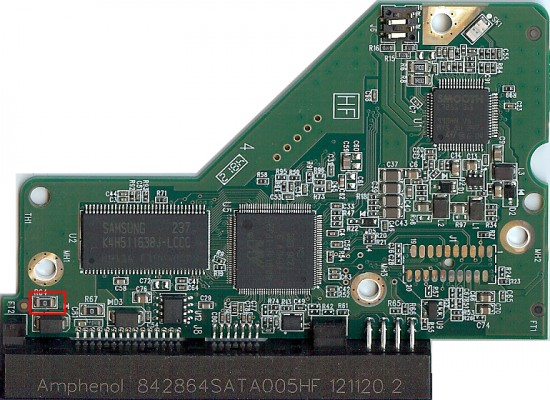

Accidentally crossed up the power supplies between a Dymo 400 printer and a Western Digital 2TB USB 3.0 My Book drive. Drive just has a slow blinking white light. The Dymo printer suffered not a bit from under-volting.
So I took it apart to find a WD20EARX-00PASB0 with this PCB number 2060-771698-004 REV A.
No spin, no sound, nothing from the drive. But the little USB adapter board is perfectly fine, I checked it on another hard drive. Great going WD, protect the interface adapter from 2x the voltage but design the adapter to pass it through to zorch the drive. (Also a big fat raspberry to Dymo for not using a power connector different from the most common one for 12 volts.)
Think a PCB swap (with firmware chip change) can save it?

Check the 12V TVS diode (D4) and the associated zero-ohm resistor (R64). If the resistor is OK, then removing the shorted diode will probably be all you need to do.

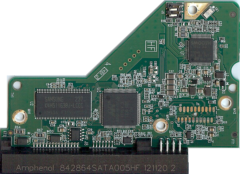

Just took the board off and scanned it. Looks like all the magic smoke is still inside. Nothing black that shouldn't be and no holes blown out of any of the chips. :) I don't have the fine soldering tools to be removing SMT parts, or an ohmmeter I'd trust to not fry other things if it's just a shorted diode.

I'm assuming the D4 diode is the one on the far left, since the other one is marked D3.
 Post subject: Re: Plugged a 24V supply into a WD My Book
PostPosted: September 15th, 2015, 6:04
Posts: 17335
Yes.

Just be careful of the U12 chip while removing diodes. If you break that chip, it might be game over as that contains the adaptive ROM code needed to program a new PCB.

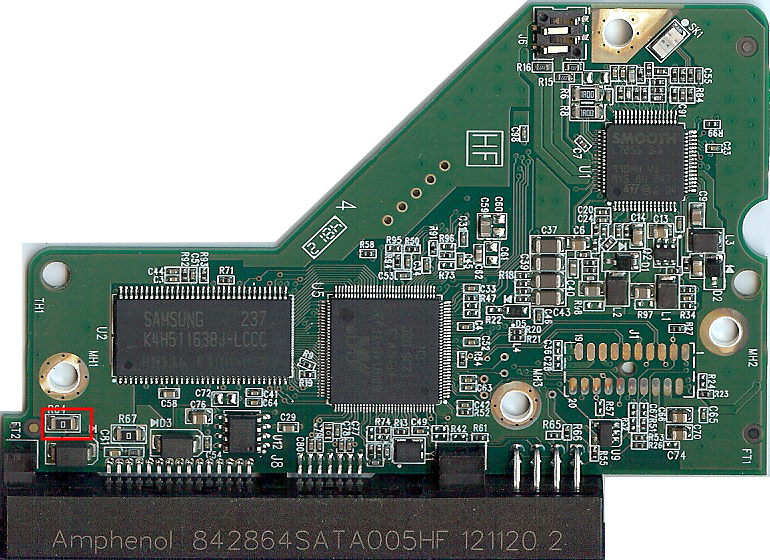

Hi all
I have the same problem. Just to make it clear - did I find the D4 diode correctly? Thanks.

No, that's a 0 ohm resistor (I.e like a fuse) the TVS is the larger black component below it.
PostPosted: February 5th, 2016, 17:13
The easiest way to test it is to get a multimeter with a "continuity test" mode, one that "beeps" when the probes are connected electrically. Should be cheap enough in a local hobby shop.
The 0 ohm resistors should "beep" when the probes are connected either side of the contacts and the TVS diodes should NOT "beep".
