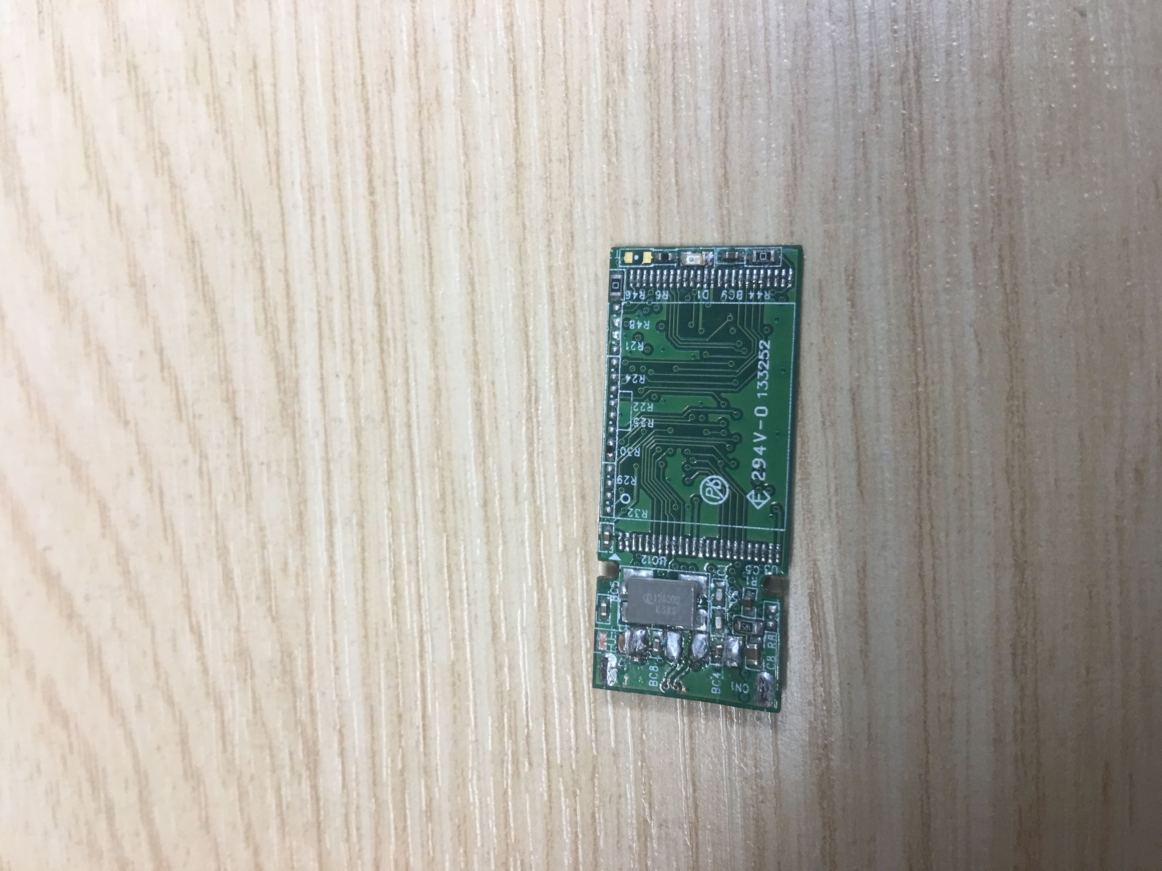

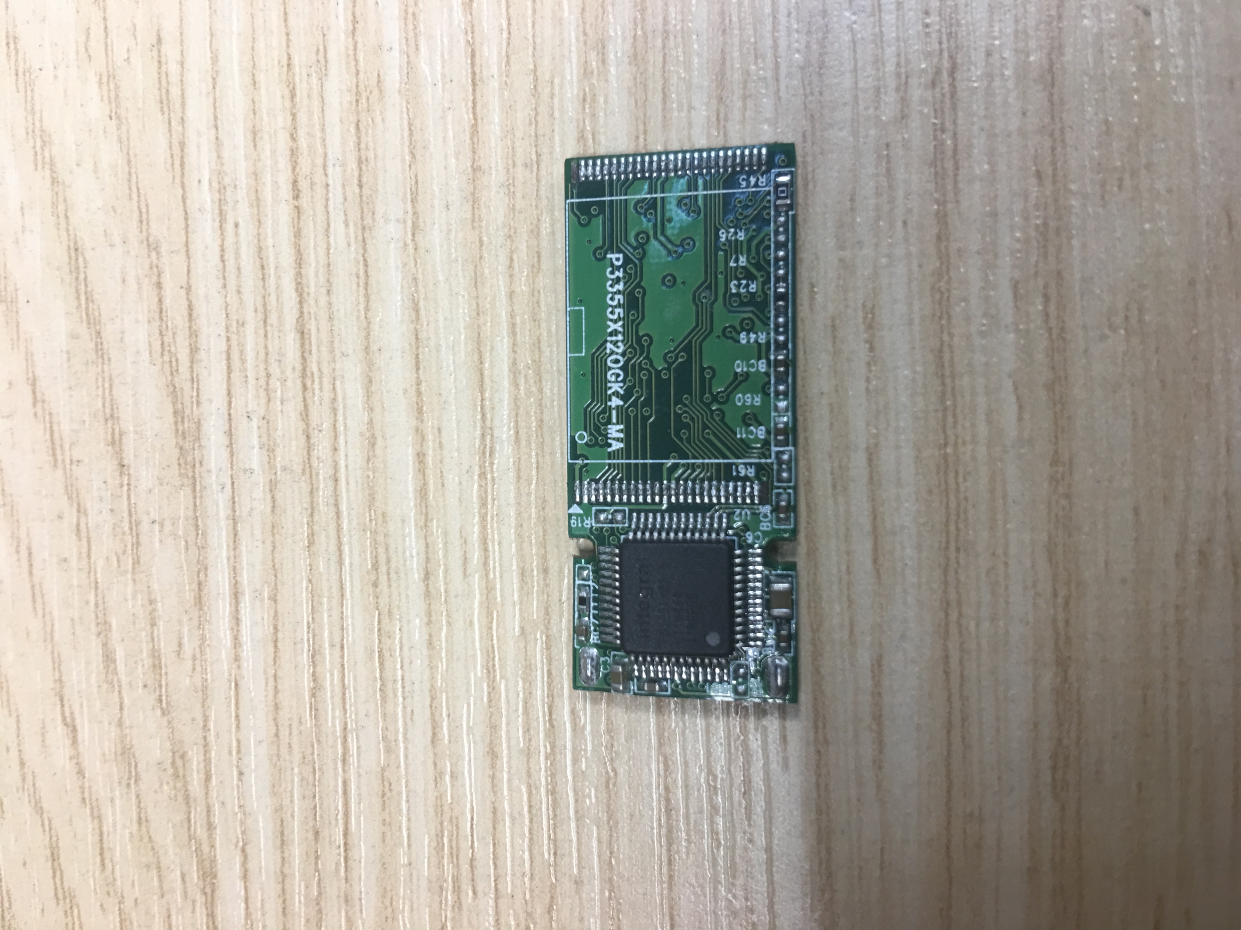

Have an Integral 32GB AES USB2 pen using a PS2251-63-5 controller. Dumps ok but encrypted. Only thing I can think to do is move chips across to a new one, unfortunately I cant find, bought one but turns out completely different pcb inside though was sort of expecting that.

Please put photo of pendrive.
 Post subject: Re: Integral 32GB AES USB2 required
PostPosted: February 17th, 2017, 11:00
Joined: February 28th, 2011, 21:04
Posts: 209
Sorry for quality, dont have a camera on me. Yes Im thinking there isnt a huge chance but not any other choice that I can think of.

what is actually wrong with original PCB? possibly can fix it well under microscope and attach wires to new USB header, or fix whatever is wrong. such as R1 possibly open circuit and replace missing cap (bottom left of first picture) from a similar looking device. It may not matter the value too much.
PostPosted: February 18th, 2017, 11:53
Posts: 209
Ive emailed Integral on the off chance.......hahahahah
Im not sure. It arrived with me with the chips already removed. Looks like there's a filter cap missing, a couple of pads for memory chip have been pulled. Looks like it could have been repaired, however, I know the place it was in to before and im sure thats the first thing they would have tried so must be something else up with it. So perhaps controller is dead.
If i cant find one i will attempt to repair pads(or find where they go) and stick a cap on and solder onto existing pads or traces and see what happens, ill guess not a lot.

Would a functional controller still identify itself via USB in the absence of NAND?
A measurement of the IR drop across R1 should tell us the current draw.
PostPosted: February 19th, 2017, 10:48
Posts: 713
Location: Brazil
I would risk to say that for some controllers, yes. A case I have here will identify the controler alone, without the NAND chip.
With the nand chip soldered, it is not recognized.
PostPosted: February 19th, 2017, 11:29
Posts: 3975
yes. in the case of SM controllers, a NAND that has become unsoldered, it shows as something like "SM Memory Bar"

Integral got back to me and said it was impossible. Seemed to be indicating key may be tied to controller, wouldn't look at it themselves either.
