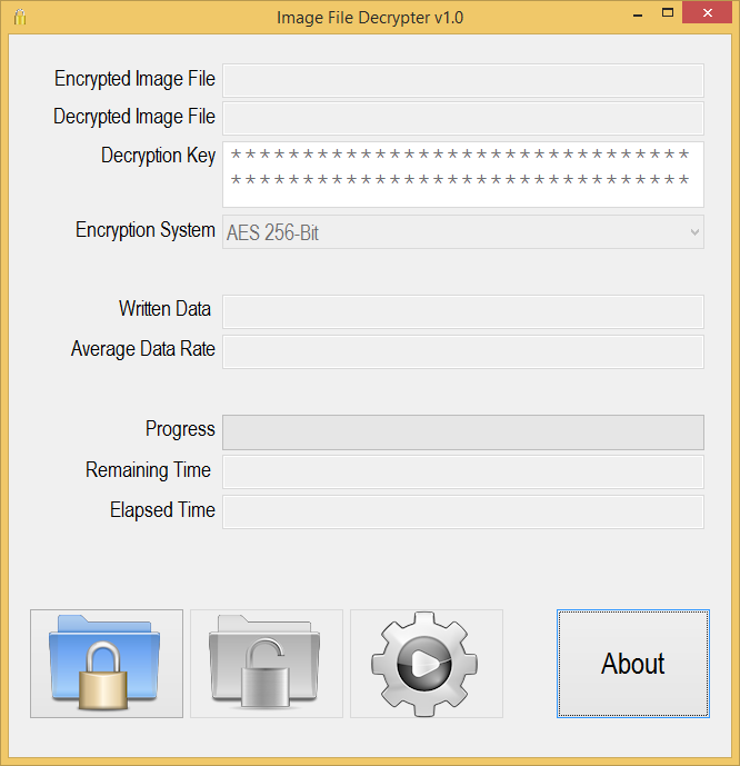

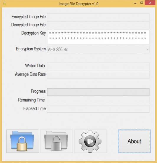

Hi Guys,
I have received some requests for my image decryption tool.
This "small" program is able to decrypt encrypted images from a WD My Passport or WD My Book hard drive.
This of course works only as long as the encryption key is known, because the key must be passed.
Please forgive my late feedback, but I've had a lot to do and on the job it was very stressful.
This is also one of the reasons why I unfortunately have to inform you that I will not offer the program in the future free of charge.
To be able to pass the encryption key to the mentioned image decryption tool, the key has to be found first.
With most hard disks this is possible without great effort, if
- there is no defect in the hard drive
- the password is known or there is no password set
- the corresponding mechanisms are known
If, however, the case occurs, that someone has forgotten his password or defects on the hard drive are present, the effort can rise immeasurably.
The actual and important program - which I have not offered here - is nevertheless able to find the appropriate key.
The development of this program has taken a very long time, more specifically, about half a year of man's hours.
If someone is still interested in decrypting a protected drive and is willing to pay a reasonable price for the very high and complex effort that has been put into the program, he is, of course, most sincerely welcome.
Best Regards,
Roberto
File comment: The Image Decryption Tool (if key is known)

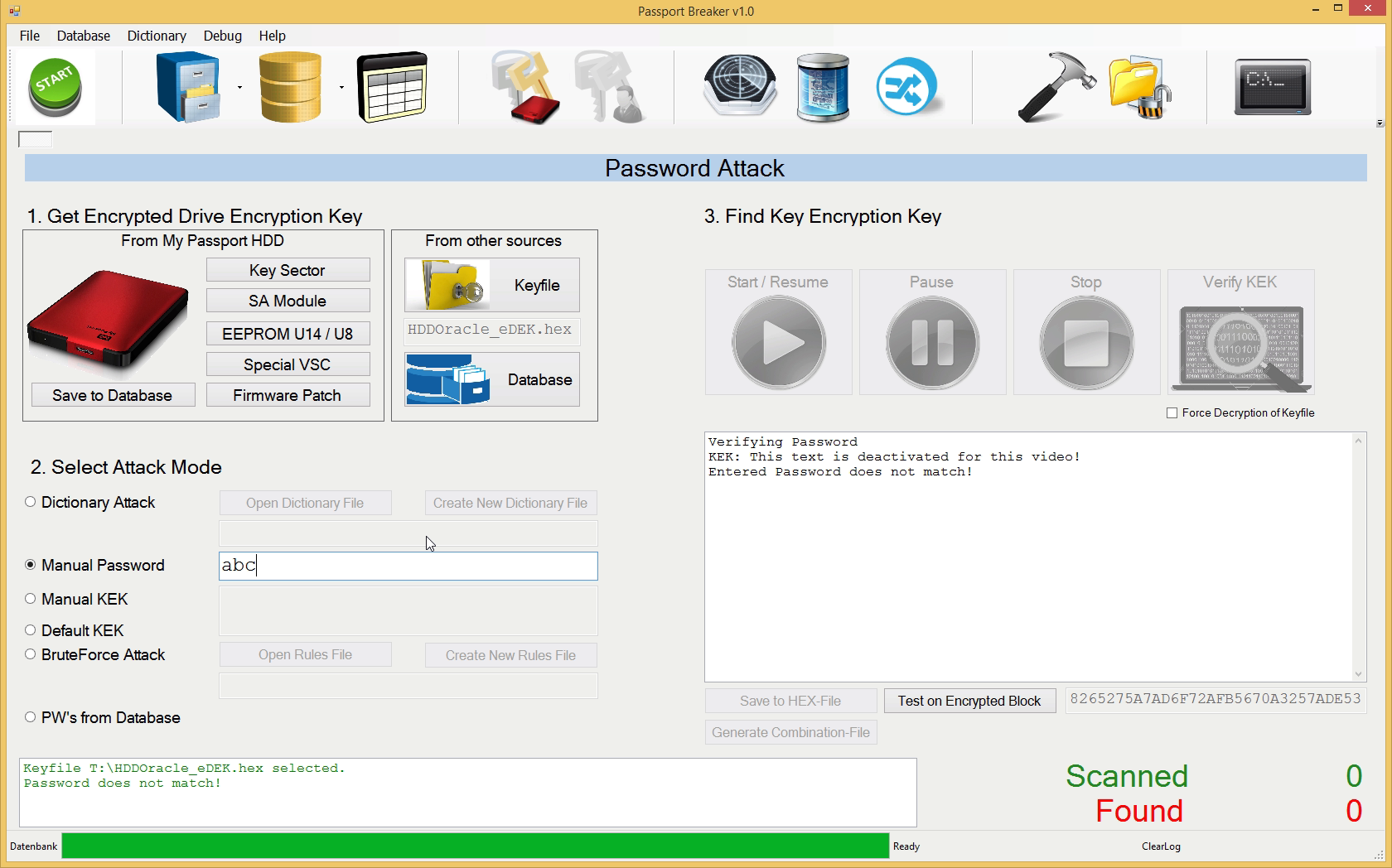

It would be much useful if you add function to bruteforce user passphrase. We noticing cases, when customers set the password, make it remember by OS, and forgetting after awhile. Re-installing or crashing windows/mac , making unable to get access to the data.

Password breaking function has already been implemented.
I can for example use dictionary attack for finding passwords.
Of course there is the possibility to create dictionaries with combinations/permutations from given default passwords of the user.
See this video file: https://c.web.de/@417764451819719706/ErwQEw6nSt2n83wvXnbGfw

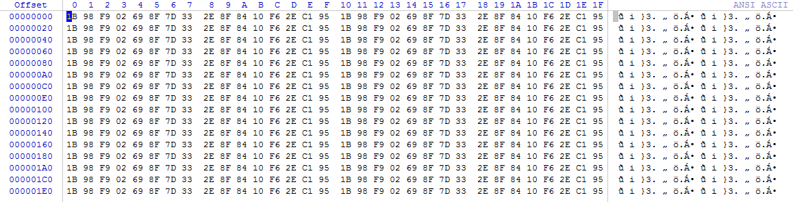

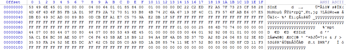

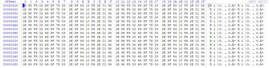

Would one of you be willing to upload a sample of the keyblock sector and an encrypted sector
from an OXUF-chipped drive, so that I can see what you are dealing with?
I do not understand what this should help you,
but here you go:

Thank you. Are they both from the same disk? Should the Crypted_sector decrypt to all zeroes?
No I fear not :mrgreen:
Why do you want to know that?
Yes should decrypt to zeros.

Then you're right: They don't help me.
I can only learn if I have a decrypted sector and a keyblock from the same disk.
Thank you.
