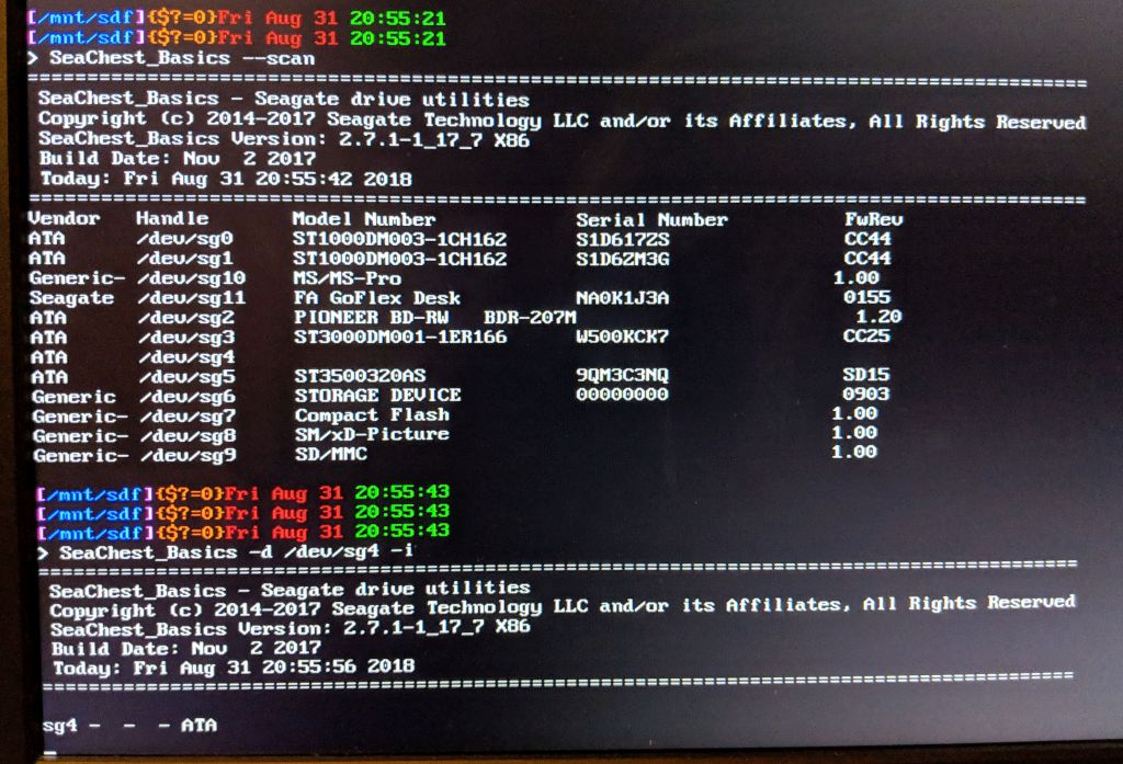

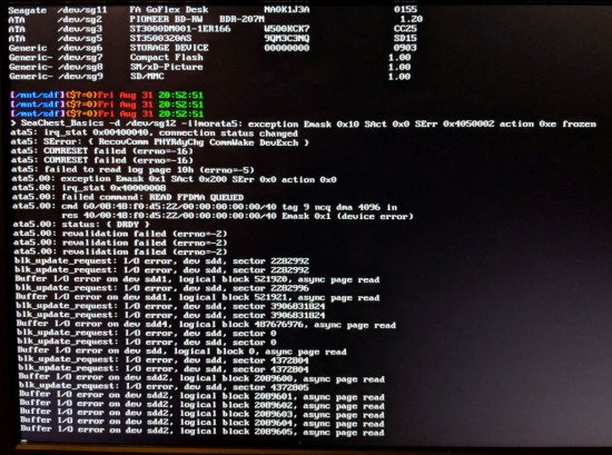

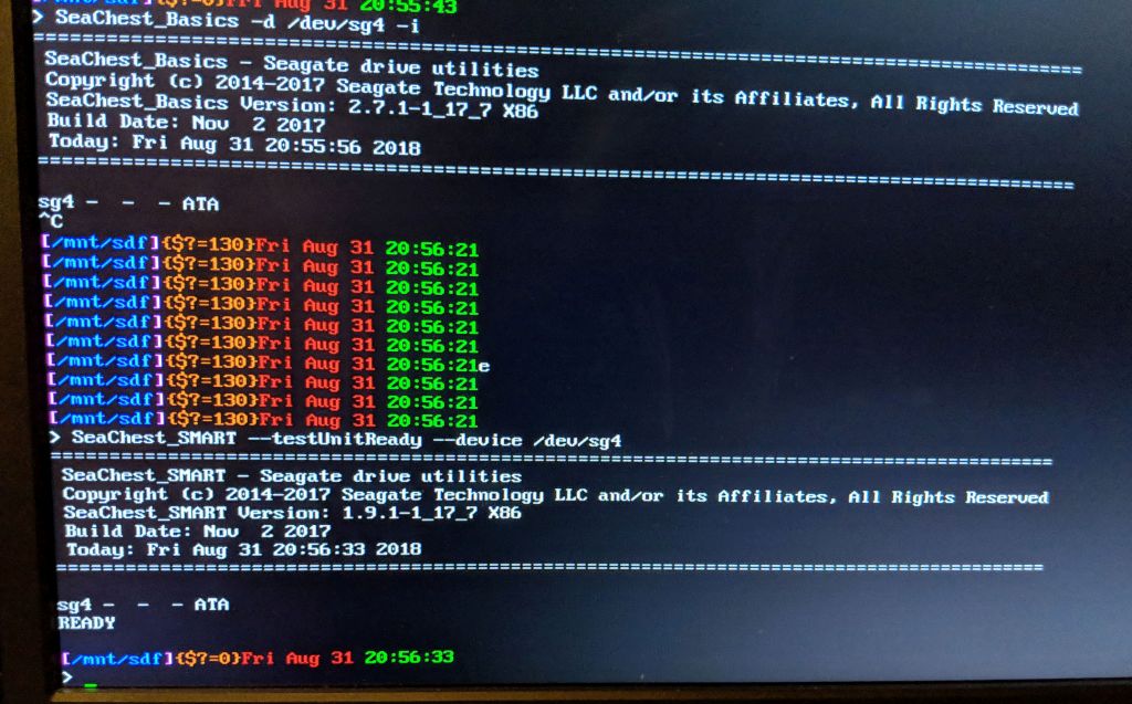

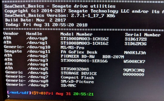

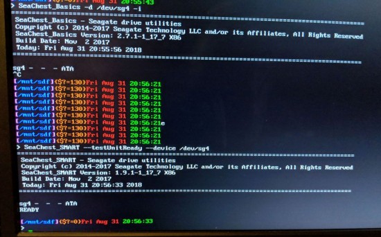

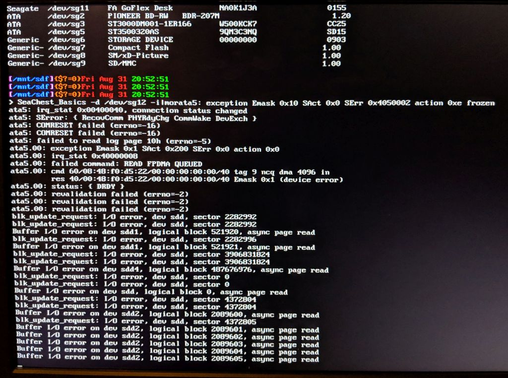

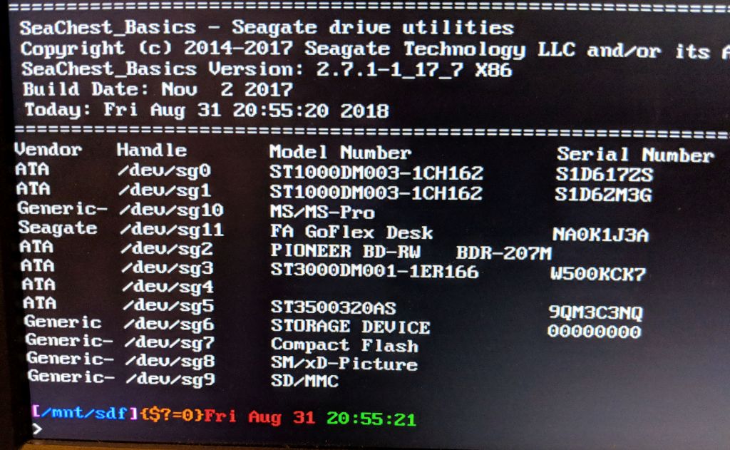

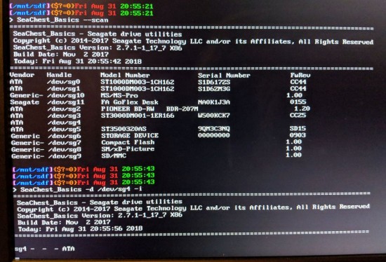

I can access the serial port and even use the diagnostic commands. The documentation on those commands isn't that great, but I was able to retrieve some information. (the drive did not spit out more than 20 characters without me doing something first)
I finally got standalone Seatools working, the first attempt totally trashed my 16GB thumb drive, rendering it un-format-able.
attached pictures show some info and behavior.
3attempting to get info does not respond didn't wait too long.jpg [ 182.34 KiB | Viewed 22157 times ]
1Attempting to load drives not sure how I got this.jpg [ 194.77 KiB | Viewed 22157 times ]
