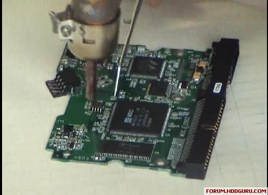

I am looking for a HD circuit board for a Western Digital 80GB hard drive. The modle number on the board is #2060-001292-000 REV A. I need this EXACT board. It is a Western Digital Caviar 80 GB. NOT a caviar SE. Plese let me know Thanks.
more info:
Date: 09 SEP 2004
DCM - DSCHYAJAH

You can use any 2060-001292-xxx logic board.
It is nacessary to resolder native ROM !!!
Mikippp

ok well how/what is soldering native rom? im kinda new at this.....
 Post subject:
PostPosted: April 17th, 2007, 18:15
The little 8-pin ROM chip, unsolder from duff board, and resolder to donor board.

any more details or pictuers?
 Post subject:
PostPosted: April 21st, 2007, 3:42
Posts: 2288
Location: In ur HDD !
The picture shows ROM chip and unsoldering it :
 Post subject:
PostPosted: April 22nd, 2007, 7:33
Posts: 2984
just buy a donor off ebay with the same model number (WD800....) and there you have a PCB suitable for ROM swap.

Same model & DCM code = no soldering required. Donor usually manufactured within 2-3 weeks of the drive needing repair.
