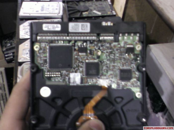

I need to repair pcb which is of a hitachi drive and i have attached the picture below can someone tell me what is the problem in most of the cases when there is no power in hdd . Like which of the components are bad .

i thisnk best thing in this cas is tracing 5 and 12 volt to see where it disappear in the pcb

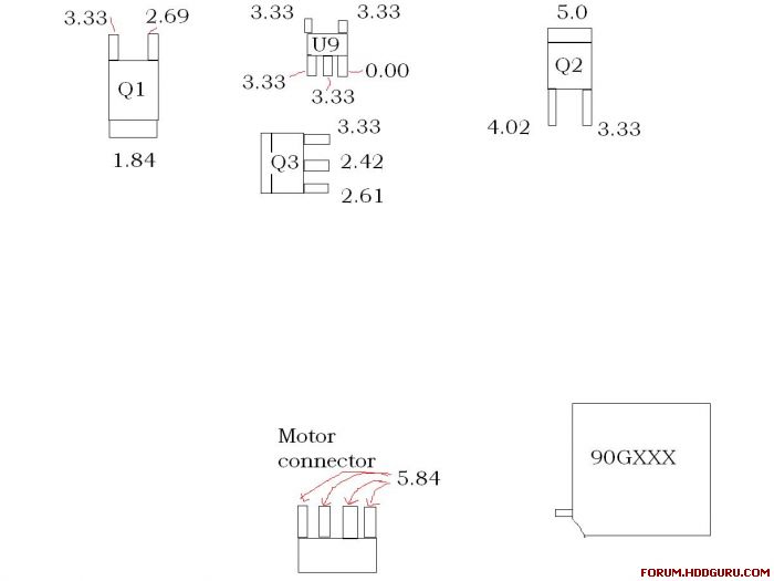

Heres the main voltages on a working IC35L040AVER07-0. Seems to have same PCB. Try cold spray, or fingers to see if 90G2018 gets warm or hot, and check voltages with the pinout I PM'd you. If 90G gets warm for a few seconds, then goes cold it's probably the problem. You should feel Q1, Q2, & Q3 get warm but not hot. If they stay cold check the voltage at pins also.
