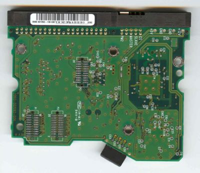

 Post subject: In two weaks I could not find a WD400BB-00CCB0

I cannot find anything that is WD400BB-??CC?? I have looked everywhere I know.

If anyone can help me i will gladly pay $100 for this drive.

Do you need the whole drive, or just the pcb?

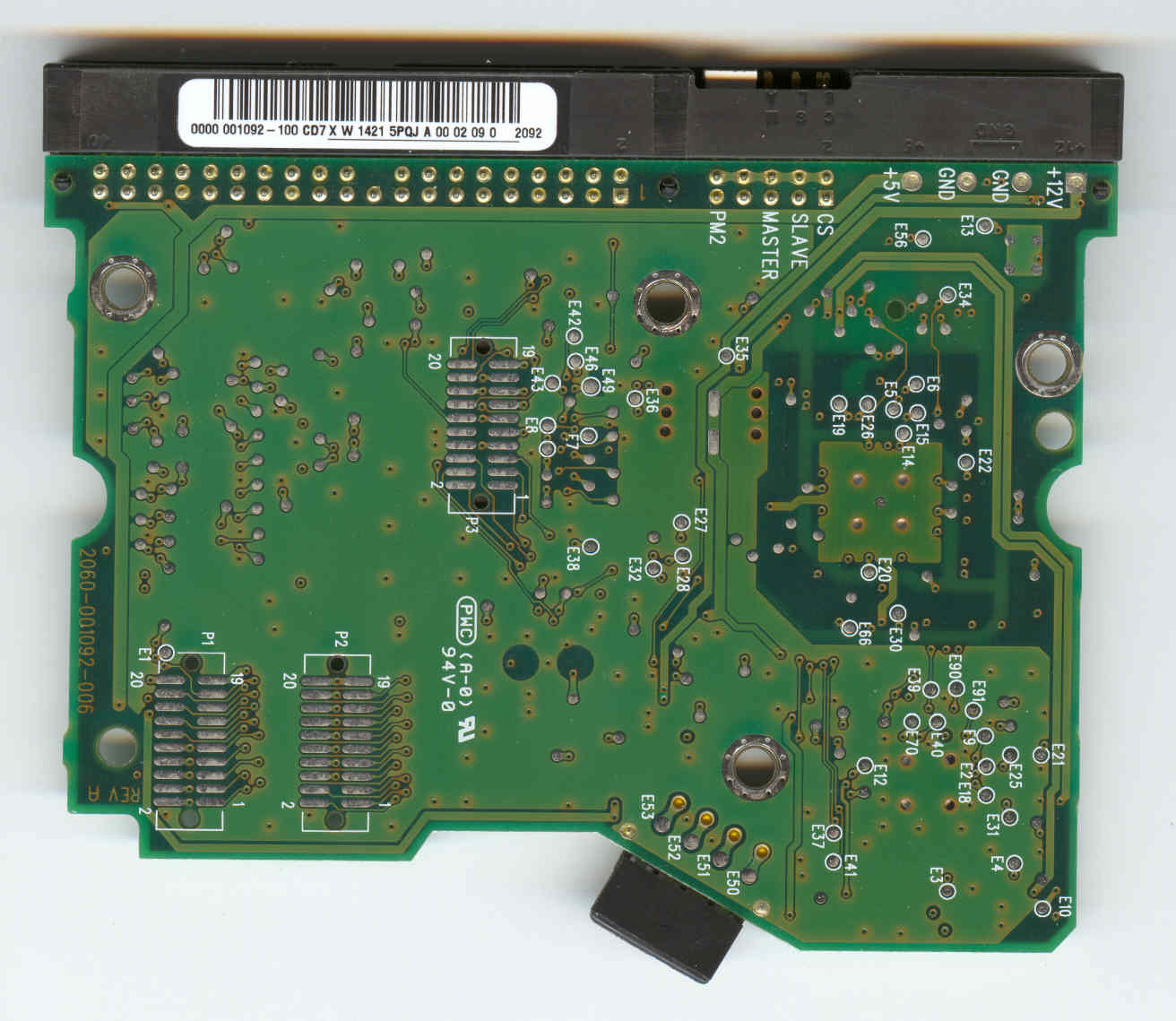

WD400BB-00CCB0 -> elektronic board 2060-001092-xxx REV A
U can use PCB from:
WD400AB-00CBA0 *
WD400BB-00CAA0 *
WD400BB-00CCB0
WD400BB-00CLB0 *
* it is necessary to reprogram ROM...
Mikippp

That was a nice posting .Are All of them elektronic board 2060-001092-xxx REV A .I Always Suggest Having The Rom Programmed Mostly .

Thank you for your replies. I was able to get the rom off the bad board so one of those alternatives should work.
