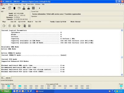

I have this WD1200BB, when I got this drive it just knocked and I couldn't read out anything from the PCB.
So I got a new PCB (same number), desolder and resolder the ROM, checked the ROM in Safemode and now the ROM is readable.

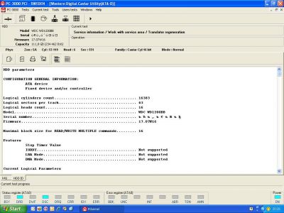

Hocked it up to pc3000 and got DRD, DSC...started the Wd-Utillity, did autodetect and every thing maps up fine, except for serial and size....klicked on tools and then Drive-ID...size comes up fine, but still no serial.
Then I tryed DE to get the data out, but the drive auto shuts down when it almost reach the point to enter the DE tool.

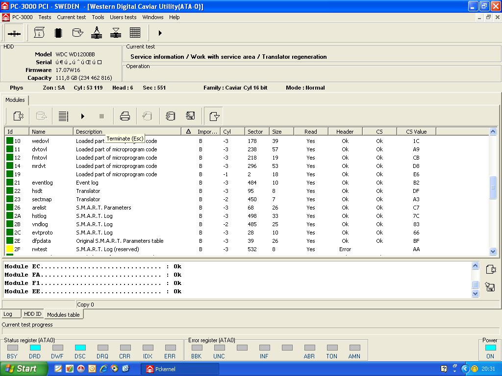

I read the modules, all are okey except for 2F SMART log (reserved)
Anyone have a clue how to make this drive readable?

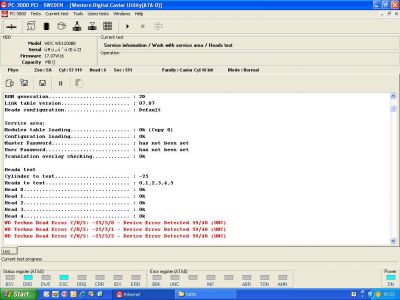

Hi Bosse,
Did you try the head check?
My guess is one of the heads is bad.

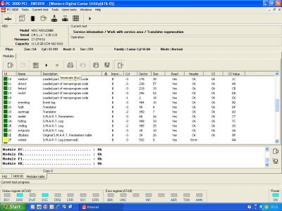

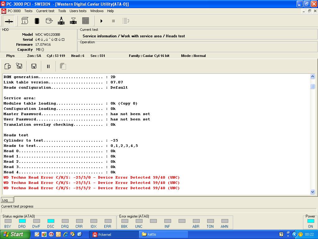

Hi Dobre, you were right.
Did a check and head 5 is gone :cry:
Is there any chance to read out the other 5 heads?
Regards/ Bosse

Sure,
Leave WD utility open, Ctrl-Tab to main screen, launch DE.
Create new task in DE(if drive hangs - uncheck SW and HW resets and Read drive ID).
Go to task params->headmap. Create a headmap using active utility and uncheck Head5. Then image the drive.

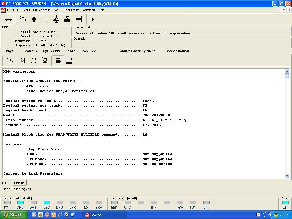

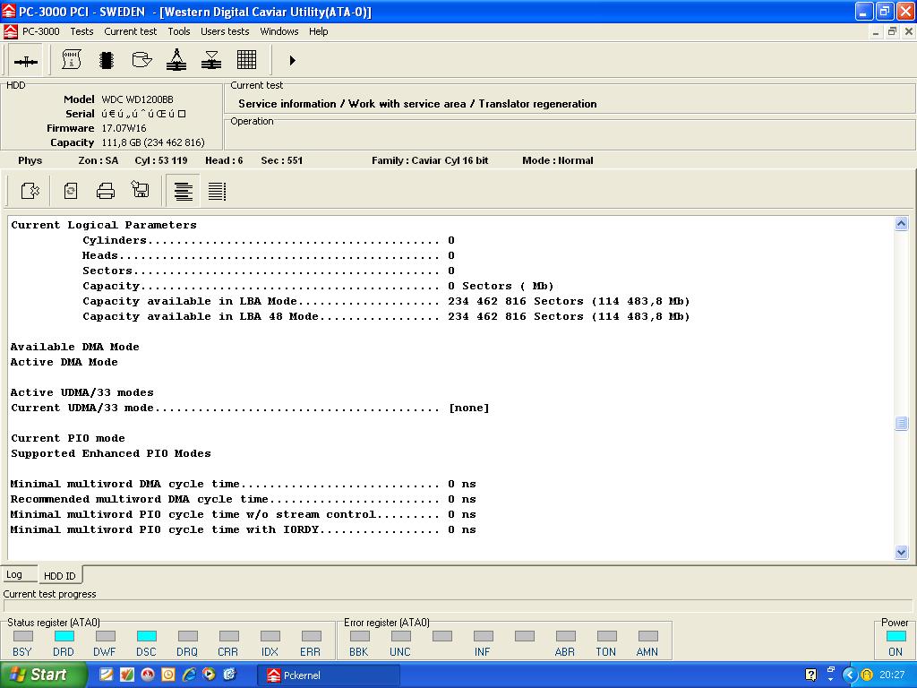

In the last picture, why is the capacity changed ? And moreover, why the S/N is not shown also ? :( .

Oh, yes indeed. Didn't notice that.
Your ROM is not original!

Hi, yes the ROM is original...just physicly moved the chip from one PCB to another.
And to quote my self:
"did autodetect and every thing maps up fine, except for serial and size....klicked on tools and then Drive-ID...size comes up fine, but still no serial"

No, it's not.
FW version 17.07W16 is a clear sign of it.
It should be 17.07W17.
Maybe you swapped the wrong chip? :)
 Post subject: Re: WD1200BB changed ROM and PCB....still not work
PostPosted: September 14th, 2007, 12:08
Posts: 637
Location: Canada
Maverick family has 40-pin parallel flash ROM - M29F10xxx.
8-pin chip on these PCBs is not ROM.
PostPosted: September 14th, 2007, 12:20
Posts: 637
Location: Canada
Also, there is no need in manually swapping ROM chip.
Just try different ROM versions from your database(from drives with 17.07W17 firmware). You may also need to play with headmap.

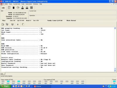

Hi and thanks for all your replyes,

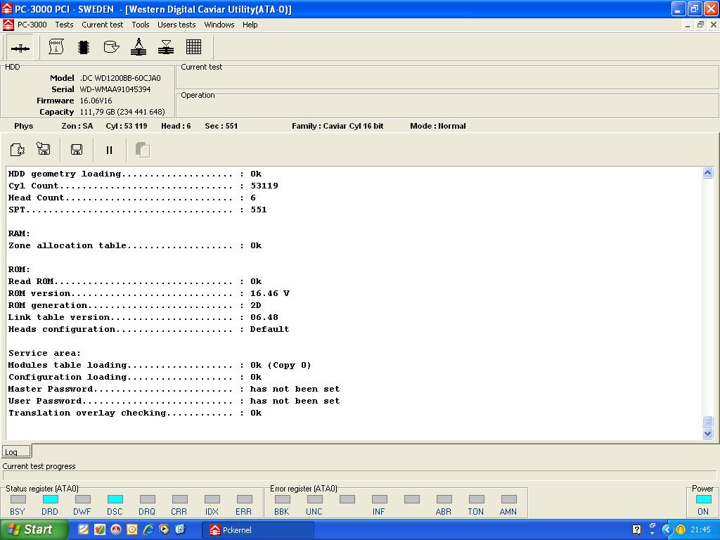

The problem is now solved, see the attached picture...the FW on this drive was 16.06V16.
After much struggle with this drive I was able to read out the original FW.
So now the drive is cloned and ready to work further with.
