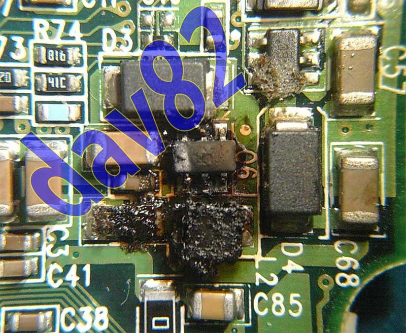

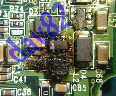

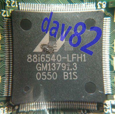

Hi all,
My HDD (WD3200JB-00KFA0) PCB got fried due to power surge (my guess).
And the following are pictures of the PCB.
Could anyone help me to identify what components got burned?
And also what's the function of each particular components?
It'll help to find out what really happened.
After doing research on google, etc., what I know is the most top IC is the motor.
But I don't know the rest.
By looking at the cushion, there are 4 areas got burnt.
I mirrored the cushion picture just to make it easier to see.
Here they are,

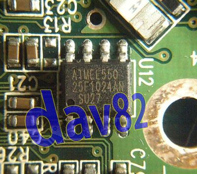

Hi there,
The only thing you need to match is: "2060-701314-002"...those boards are quite common on other models also.
And then desolder the U12 ROM chip from your burnt Pcb, and resolder it to the new one.

I'm useing a hotair soldering station, you can use a normal solering iron, but it's more difficult as you need to go from "leg to leg".
The best with hotair de/resoldering is that you can move the nozzle much more freeley, just apply so much heat so the solder melts, then quick off with the heat....but if you not feel comfortable with soldering, got to a tv-repir guy or so and let them do the job for you.
For me that rate is 100%.
And there always is a chance that the ROM is also burnt...but they seems to handle the overcurrent better than other Ic's so your chance is high that the chip is ok.
Bosse

PostPosted: December 9th, 2007, 14:30
Joined: December 1st, 2007, 8:01
Posts: 19

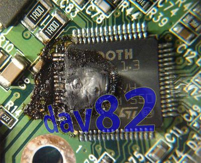

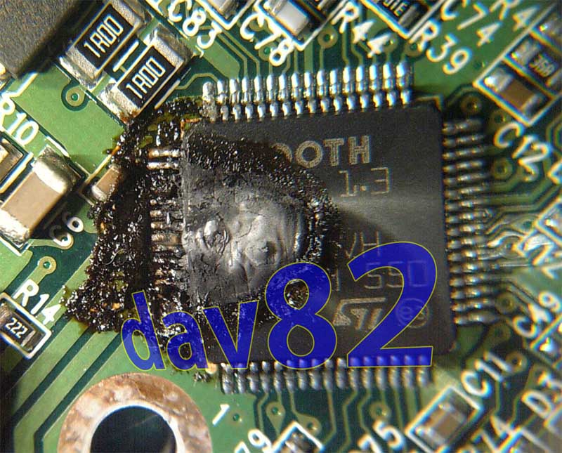

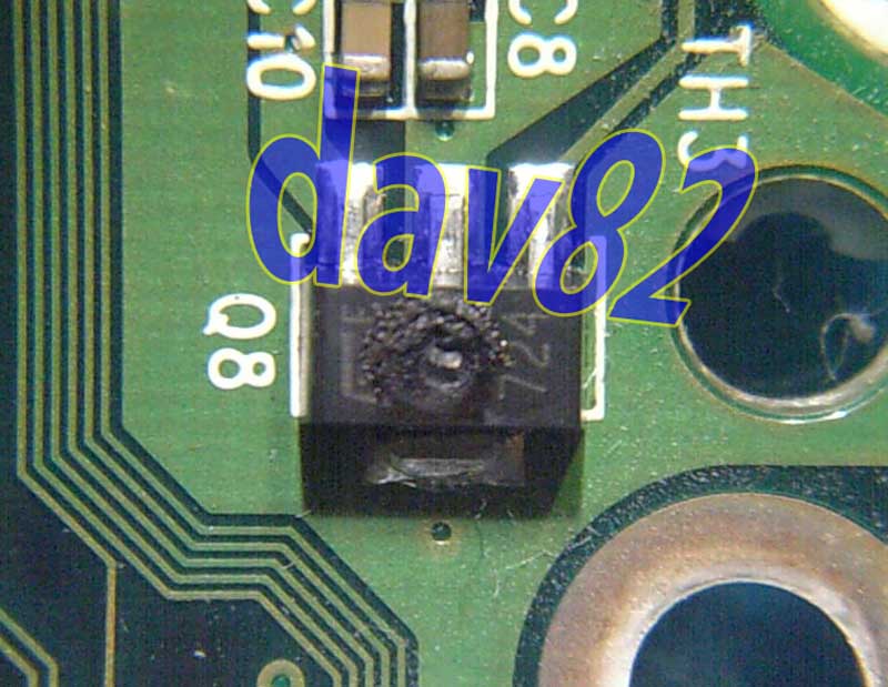

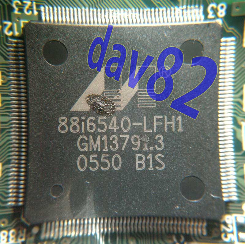

Close-ups
File comment: Motor IC
File comment: Main IC
File comment: LDO

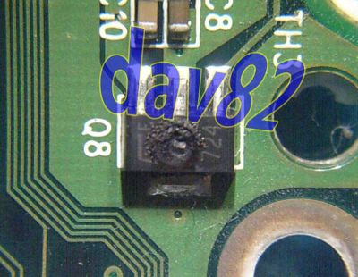

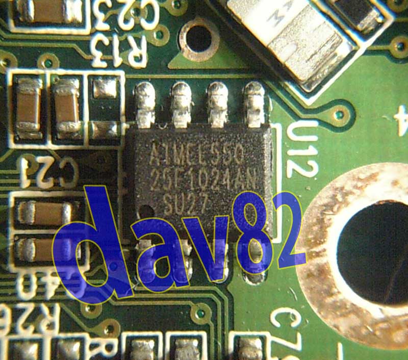

2 more close-ups
File comment: Transistors
File comment: U12 Chip
 Post subject: Re: Please help identify fried PCB WD3200JB-00KFA0 & any comment
PostPosted: December 9th, 2007, 14:34
Joined: November 19th, 2007, 0:23
Posts: 84
Sometimes high bearing torque and poor cooling will cause the servo chip to burn out.
The servo chip normally shorts out when it fries and takes out other chips.
If you do get it working I would suggest using a cooling fan on your drive and get the data off as quickly as possible. I would also suggest trashing the drive once you get your data off.
PostPosted: December 16th, 2007, 9:35
Posts: 2288
Location: In ur HDD !
he is talking about the Spindle motor controller .

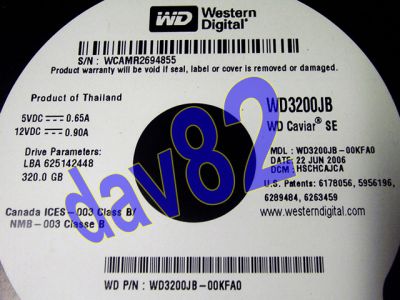

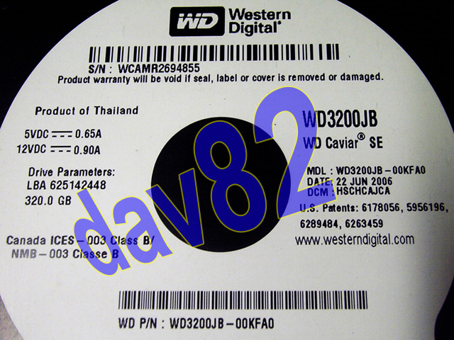

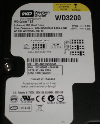

I happen to find someone selling "almost" exactly the same HDD as mine.
Here's mine:
MDL: WD3200JB-00KFA0
DATE: 22 JUN 2006
DCM: HSCHCAJCA
PCB: 2060-701314-002 REV A
PCB Label: 2061-701314-A00 AG XS 2L13 D1LH 4 000431R 6314
Other HDD:
DATE: 30 JAN 2006
DCM: HSCHCAJCH
PCB Label: 2061-701314-A00 AG XS 2L13 A5H6 6 0005280 6295
Please note that the HDD Label Sticker is different.
However, both HDDs have black casing.
Despite of 5 months produced earlier, do you think this PCB will work on mine without doing ROM chip swap?
How big is the risk without doing ROM swap? What will happen?
Any gurus or anyone who has the experience, could you give me any comment about this?
Thanks in advance.
Here's the pics,
File comment: Mine
File comment: Other
PostPosted: December 20th, 2007, 9:23
Posts: 1852
Location: Belgium
Hi Dav,
Without swapping rom this is guaranteed NOT to work.
If you can swap the rom, then this pcb should work.
Best regards,
Dobre
PostPosted: December 20th, 2007, 9:41
Dobre is correct,
These drives have adaptive data in the ROM. Sort of like "fine tuning" parameters, programmmed at the factory.
You MUST swap the ROM, or at least read it out and re-program the donor PCB.
Unless you are very, very lucky.
I have got away with it once on a similar drive, the donor just happened to be the other half of the RAID array, so the drive was the next sequentially serial numbered drive.
Sean
Sean
Thanks for your input Sean.
If I want to give it a shot without swapping the ROM chip, and if it's not compatible, what further damage will it do to my HDD? Will it do any physical damage?
On another matter, let's say if I wanna do hardware swap, i.e. head, spindle, actuator arm, etc. The above HDD will be compatible to mine, right?
As far as my research goes, the 5th & 6th letter of the DCM must match in order to do head swap. Correct?
However, I also read somewhere that the last 3 letters much match.
Anyone can justify this?
Thanks.

ROM swap is not risky as for me i have been 100% successfull in ROM swap so go ahead .
As for the head swap in WD its very risky .
PostPosted: December 20th, 2007, 14:07
Joined: August 28th, 2007, 11:11
Posts: 26
Location: Germany
Due recalibration?
