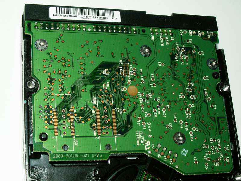

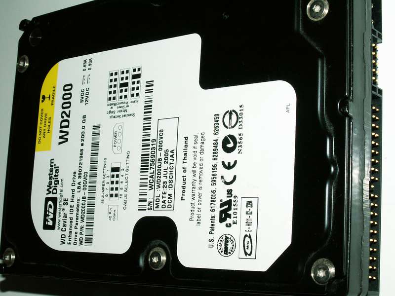

ok its my images of my hard disk back and front and you can read all about this hard disk.

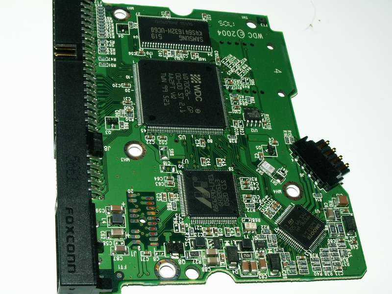

hi i take a picture front of electonic board u can read all information from picture.This picture is here: http://daimon.webd.pl/hdd_wd2000jb-00gv ... _board.jpg

Try this vendor:
http://hdd-parts.com/firmware-transfer.html
You will need to transfer the chip at U12 from patient to donor. A ROM transfer should cost you no more than US$20. The above vendor provides a PCB plus ROM transfer for US$70.
