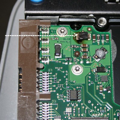

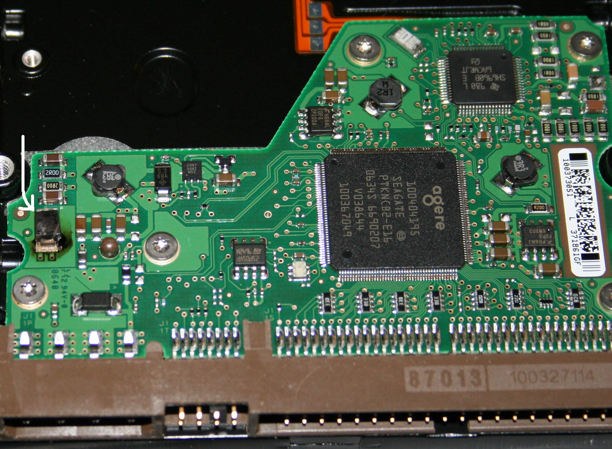

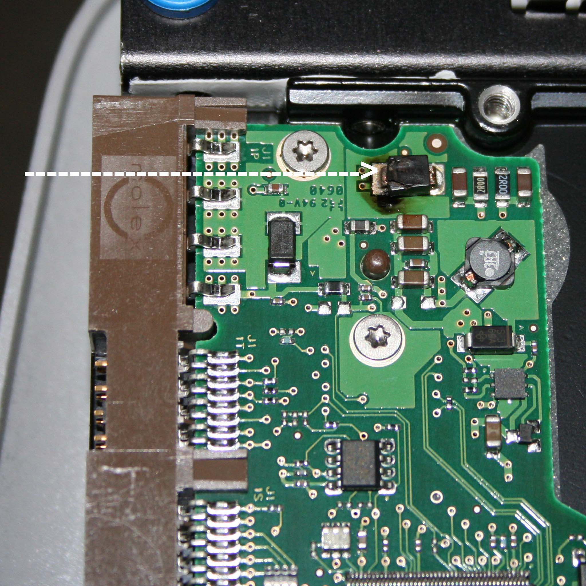

first time poster here and I'm not a HDD guru. It looks like this forum is crawling with HDD gurus so here I am :)
I found a similar problem in this thread http://forum.hddguru.com/help-with-two-seagate-hdd-t6664.html and I'm not sure if it's the same problem and solution.
The drive takes a 5v plug and I accidentally plugged in my laptop (12v) which obviously fried the board. Meh, that's what happens when the plugs look incredibly identical, I really should have put a label.
Anyway, the one piece that smoked is pointed out by the white arrow in the picture.
One picture shows the entire board (in case anyone needs to see more detail) while the other is a close-up of the burned piece.
Is this a case of being able to remove the burned piece and connect the two ends? What is that burned piece? I can barely read the letters which I think says something like "bux c631" but I'm not sure.
HDD is ST3300601 CBRK - Seagate 300GB
Drive Board says 100373051 - L - 371861GF
Any help is appreciated. Thank you all for your time and comments!
File comment: Detail closeup
File comment: Entire board view

Just remove the piece. Don't put anything in it's place. That's the easiest thing to do. The safest thing is to replace it (Another drive is the easiest source).
Also, in case it occurred to you, don't reuse the external enclosure. There's likely more damage to that, and you don't want to risk a drive.

It's a TVS.
Transient Voltage Suppressor.
Common, search for it here. ;-)

The way the TVS works, current goes though it only when there is a transient (Voltage goes over 14V or so). It works by shorting the overvoltage, and in an extreme case (Like this) it burns up and shorts permanently. In normal operation, it doesn't actually do anything. Removing it removes the protection it provides.

Well, I (shakily) went into the board and removed the TVS. I plugged it in and TA DA! it works!
I was very careful in removing the piece even though it was completely burned and pretty much it flaked off.
The drive spun up and I can see all my data completely. YAY! It's been more than a year since I burned it and I couldn't give up! I'm really happy I found this place :)
