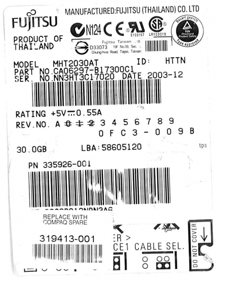

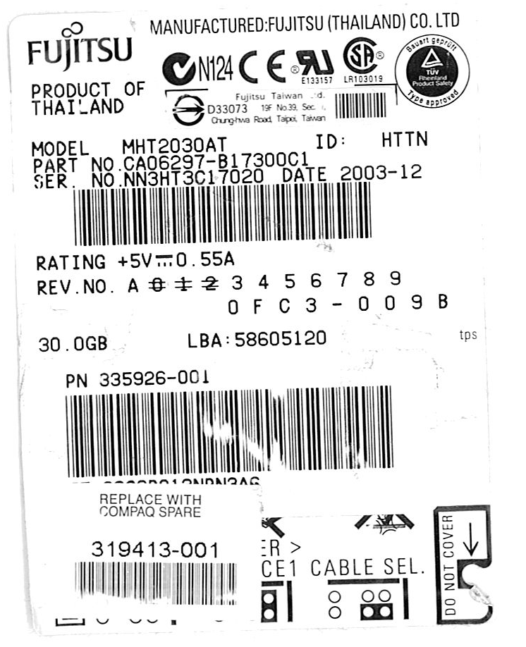

I´m looking for a PCB that matches this HDD.
Please see attached photo of sticker.
Thank you very much.
Ric

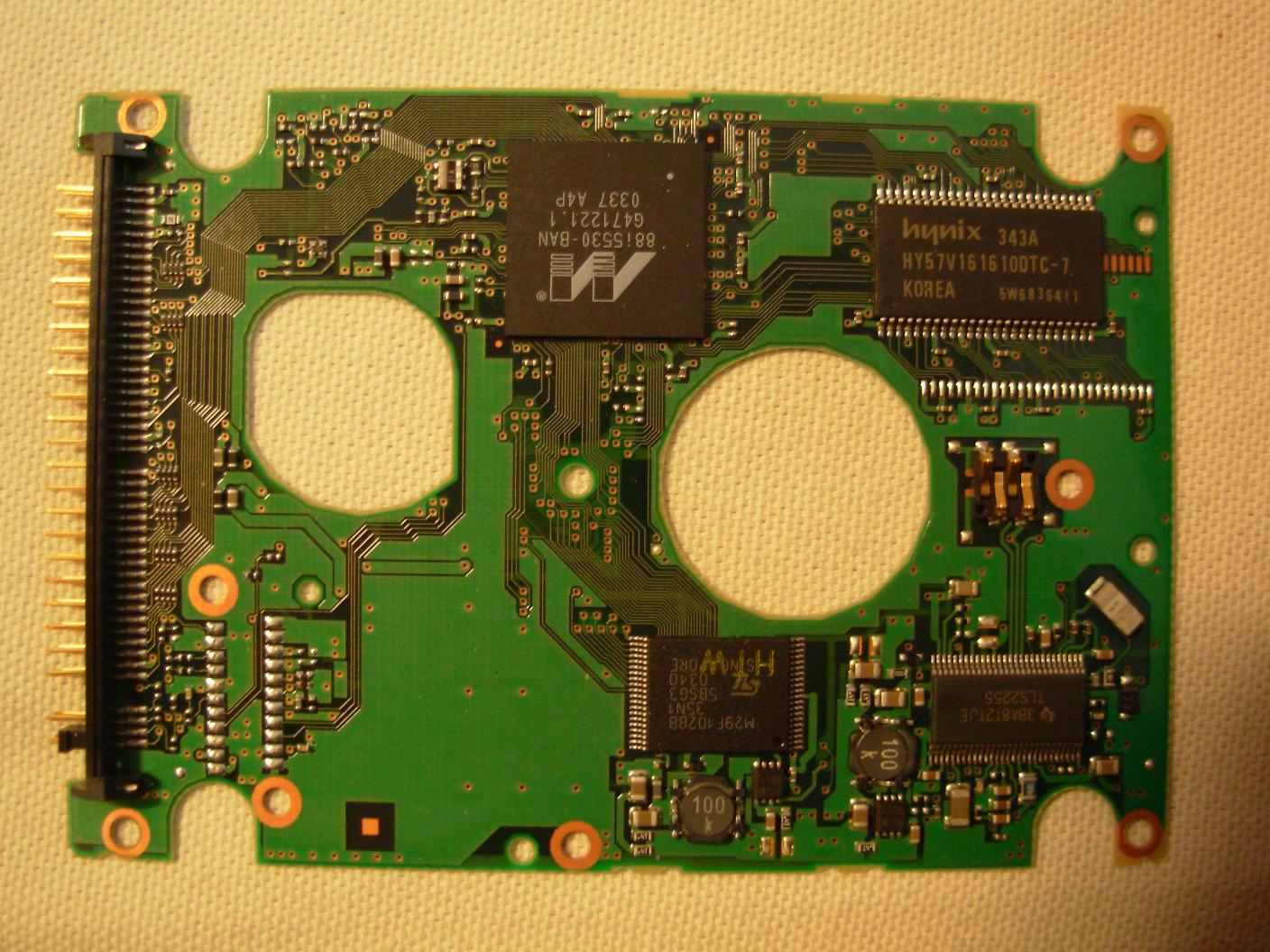

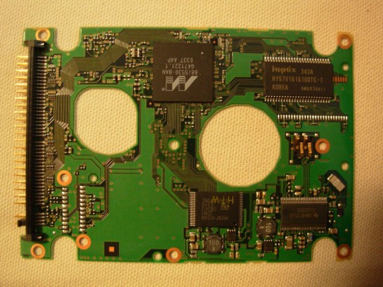

 Post subject: Re: wanted: PCB for Fujitsu MHT2030AT
PostPosted: May 5th, 2009, 17:27
Post a hi-res of the PCB (component side)
PostPosted: May 6th, 2009, 3:22
Joined: May 5th, 2009, 4:35
Posts: 5
Location: Munich
Hs,
here´s the pic.
Ric.
PostPosted: May 6th, 2009, 3:34
The fuse is top left, marked with an "N".
Use a multimeter to check continuity, it should be closed.
If it's open, either replace it or bridge it.
If that doesn't work right away, then switch it off quickly, you need a new PCB.
If it does happen to work then copy off your data QUICKLY! This should be considered a temporary fix only, as the drive is no longer protected.
Good luck!
