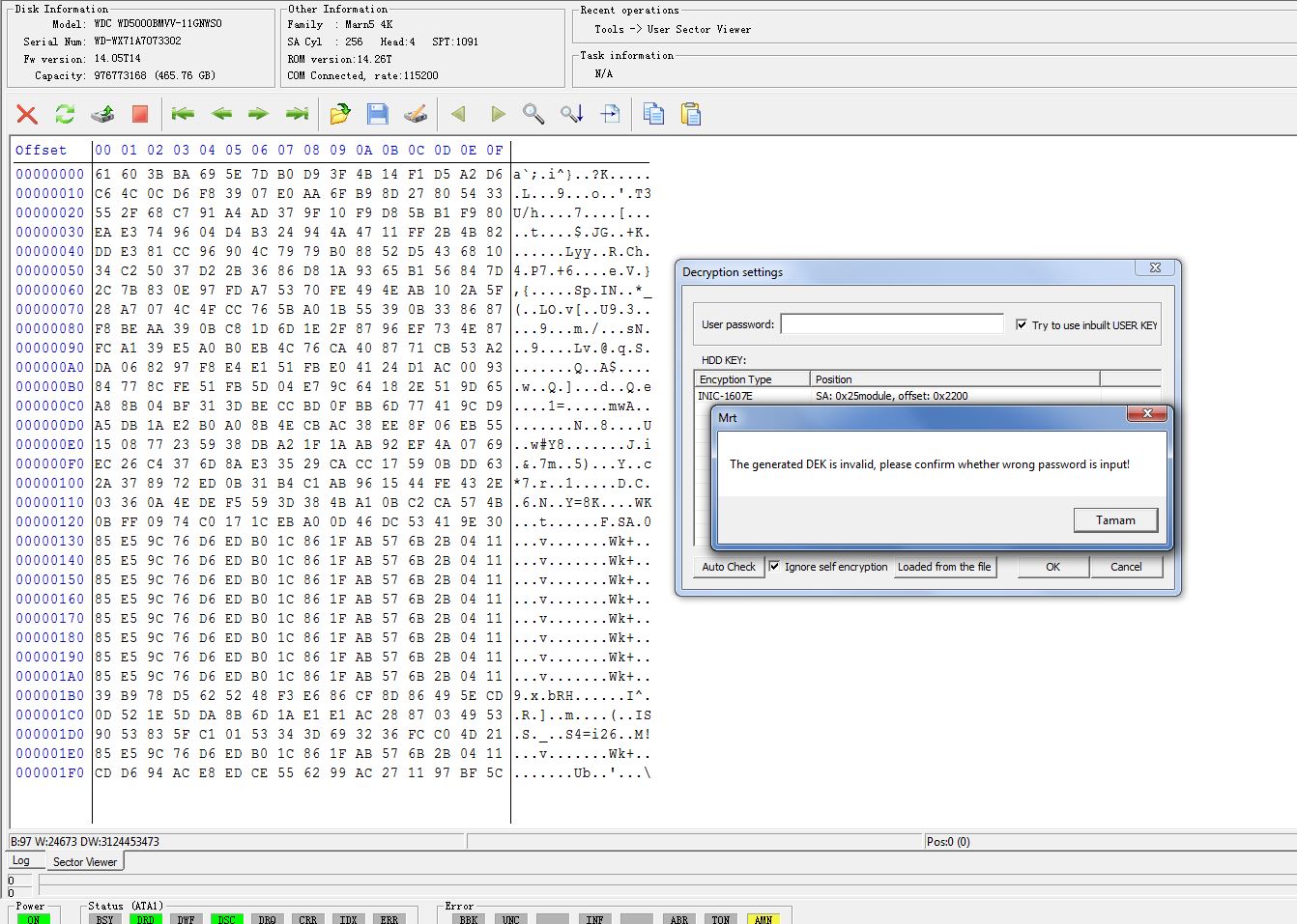

Any hint ?
I have this error.
Tried everything that I know

You will need smartware user password to input for decryption.
user says there is no passwoed.
Is it definetly user password isue?
