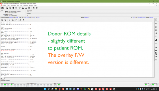

Hello all - Merry Christmas!
I've reached a dead-end on this Charger. Before anyone suggests it, I have already considered that the PCB on this charger is not the original. According to the owner and the PC Shop it went into first, it has not been changed. I am inclined to believe them given the type of failure shown.

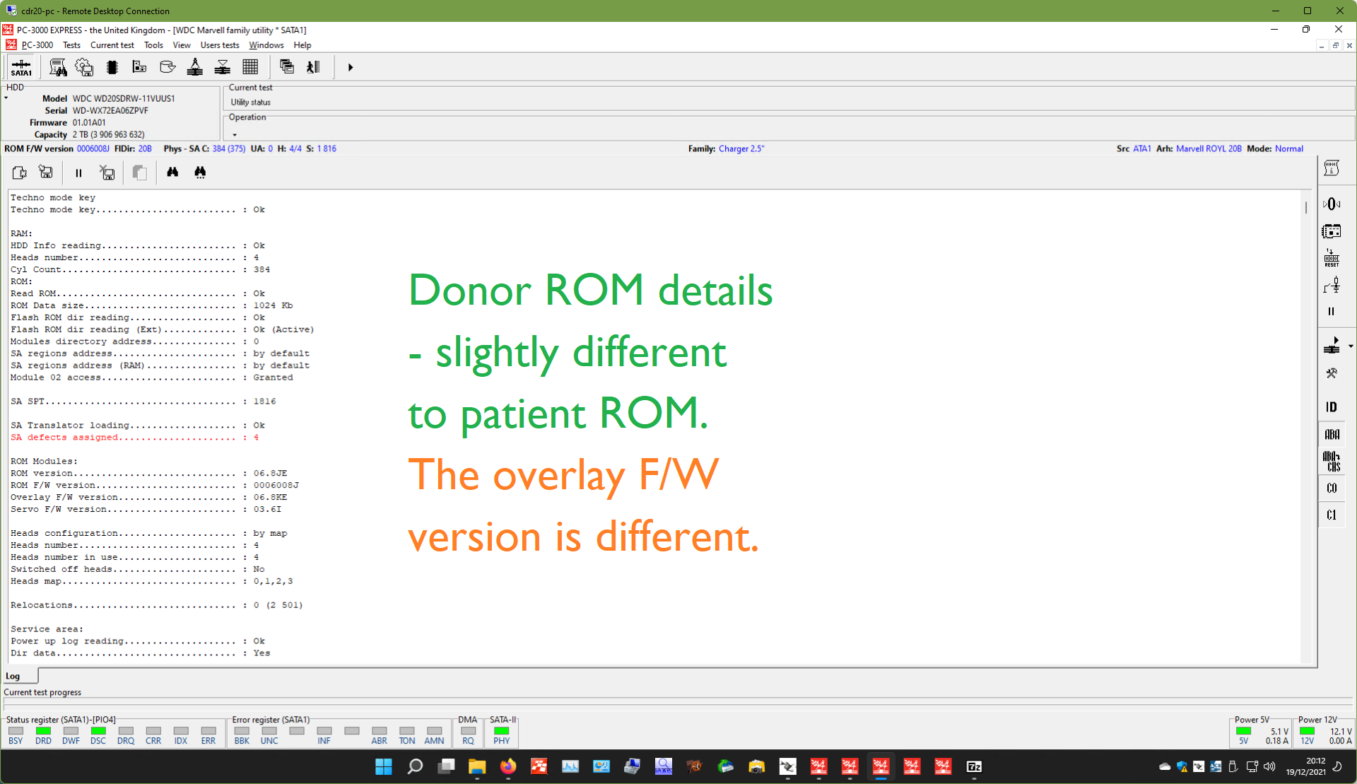

The problem:
HDD when powered on with native USB PCB spins up. There are no clicking noises. The HDD is not detected.
The ROM chip was read by an external reader (see attached). Then ROM was reprogrammed to an unlocked SATA PCB to work on SA. When HDD is powered on the HDD enters RDY, but in Kernel mode. Launching Utility shows an error with ROM. See below:
HDD Info reading........................ : Ok
Heads number............................ : 4
Cyl Count............................... : 384
ROM:
Read ROM................................ : Ok
ROM Data size........................... : 1024 Kb
Flash ROM dir reading................... : Ok (Active)
Flash ROM dir reading (Ext)............. : Ok
Modules directory address............... : 212 461
SA regions address...................... : by default
Module 02 access........................ : Granted
SA SPT.................................. : 0
ROM Modules:
ROM version............................. : 06.8JE
ROM F/W version......................... : Module ID 4F reading error Device Error Detected: "FM ERR HEADER II SIGNATURE INVALID"
Overlay F/W version..................... : 06.8JE
Servo F/W version....................... : 03.6I
Head Map Reading Error.................. : Module ID 0A reading error Device Error Detected: "FM ERR HEADER II SIGNATURE INVALID"
Relocations............................. : 0 (0)
Read ROM modules
Into file............................... : <HDD Profile>\Data\ROM
Module : 0A............................. : Module ID 0A reading error Device Error Detected: "FM ERR HEADER II SIGNATURE INVALID"
Module : 0B............................. : Ok
Module : 20B............................ : Ok
Module : 30............................. : Module ID 30 reading error Device Error Detected: "FM ERR HEADER II SIGNATURE INVALID"
Module : 47............................. : Module ID 47 reading error Device Error Detected: "FM ERR HEADER II SIGNATURE INVALID"
Module : 0D............................. : Module ID 0D reading error Device Error Detected: "FM ERR HEADER II SIGNATURE INVALID"
Module : 4F............................. : Module ID 4F reading error Device Error Detected: "FM ERR HEADER II SIGNATURE INVALID"
Module : 181............................ : Ok
Module : 1A2............................ : Module ID 1A2 reading error Device Error Detected: "FM ERR HEADER II SIGNATURE INVALID"
Module : 1B6............................ : Module ID 1B6 reading error Device Error Detected: "FM ERR HEADER II SIGNATURE INVALID"
Module : 1B0............................ : Ok

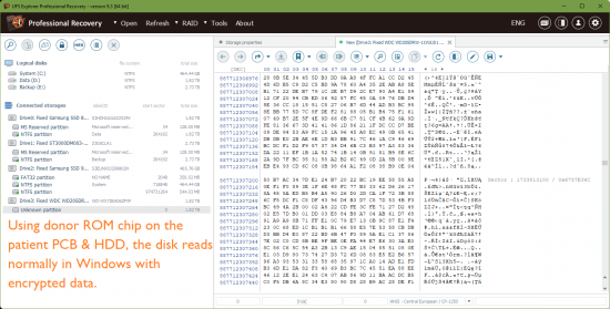

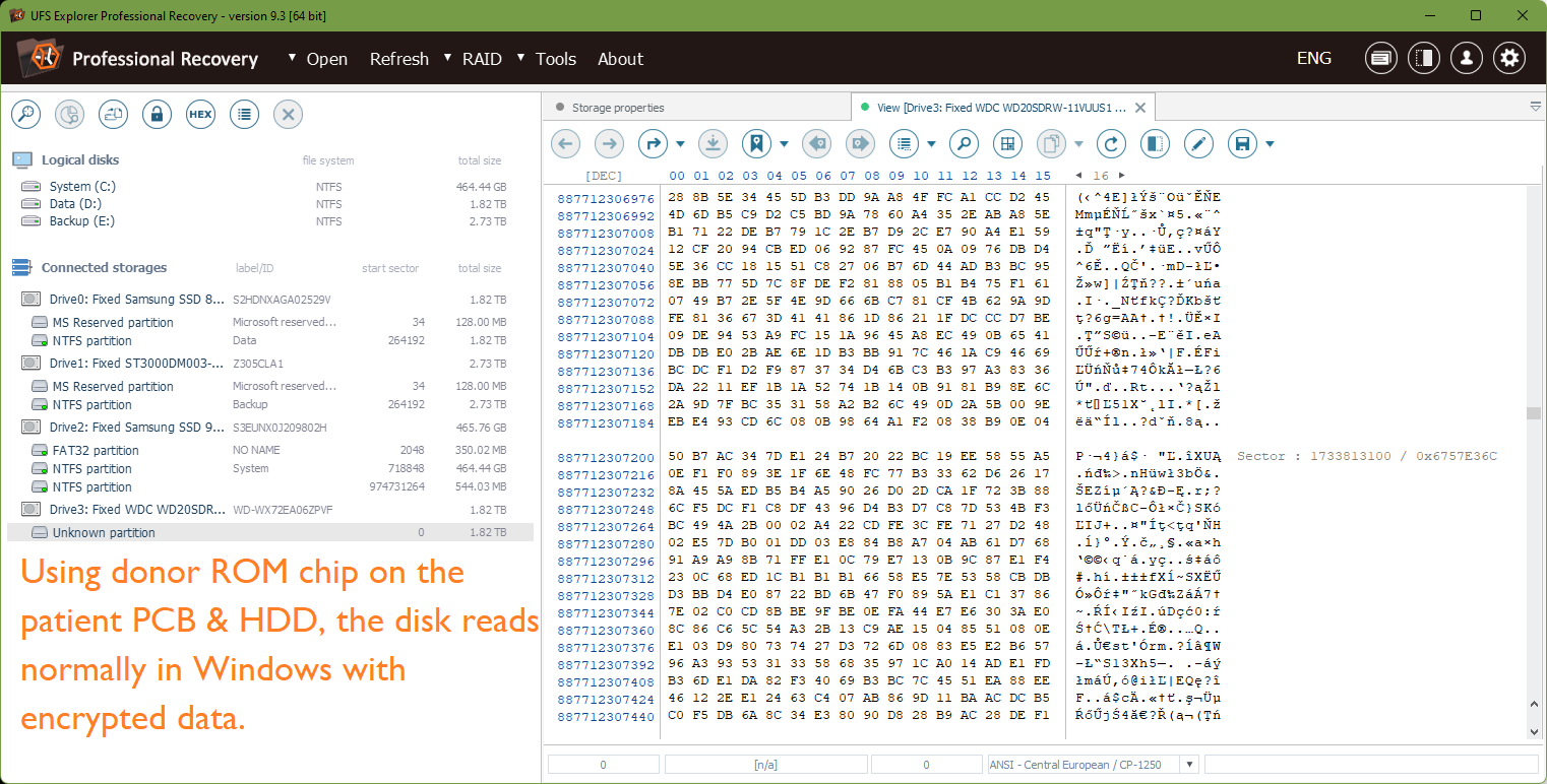

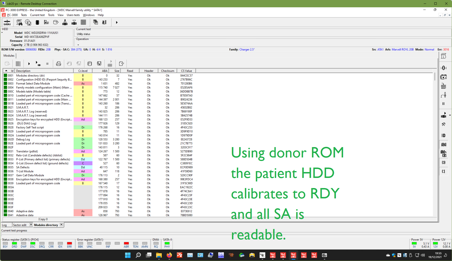

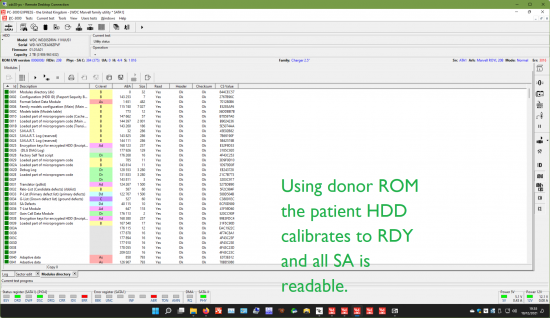

Using a donor 06.8JE ROM from another Charger HDD it is possible to calibrate the HDD to RDY, read ID, and read all firmware modules OK. Also, all LBA values are readable (obviously encrypted with SATA PCB). Please note that the donor ROM version was a matching in 06.8JE, but the donor Overlay F/W Revision was 06.8KE.
A ROM chip with the donor ROM was physically transferred to the patient PCB. The patient HDD spins up, is correctly detected with ID and 2TB capacity. It is possible to read all LBA via USB. However, all data is encrypted.
As far as I am aware encryption is controlled by the MCU. The ROMs on Charger are not unique, and matching the same ROM F/W Revision is enough. ROM rebuilding from the SA data on Charger is not possible (at least in PC3000).
Any suggestions?

PC3000 is producing errors because it is detecting 0x20B as the directory module whereas in fact it should be 0x0B.

The active directory flags in modules 0x0B and 0x20B don't appear to follow the usual format.

Could we see the donor ROM? I could swap the active flags in the patient ROM, if PC3000 can't do it.
FWIW, the warranty expiration date is 14-Mar-2023. If you suspect that the ROM is not original, you could examine the YYWW/YWW date codes on the ICs and see how they compare against the warranty date. You could do the same for both the patient and donor so that you know what to expect.

I copied the mods in 0x0B to the locations specified in 0x20B.

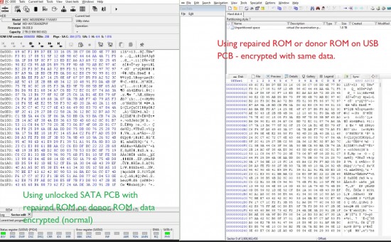

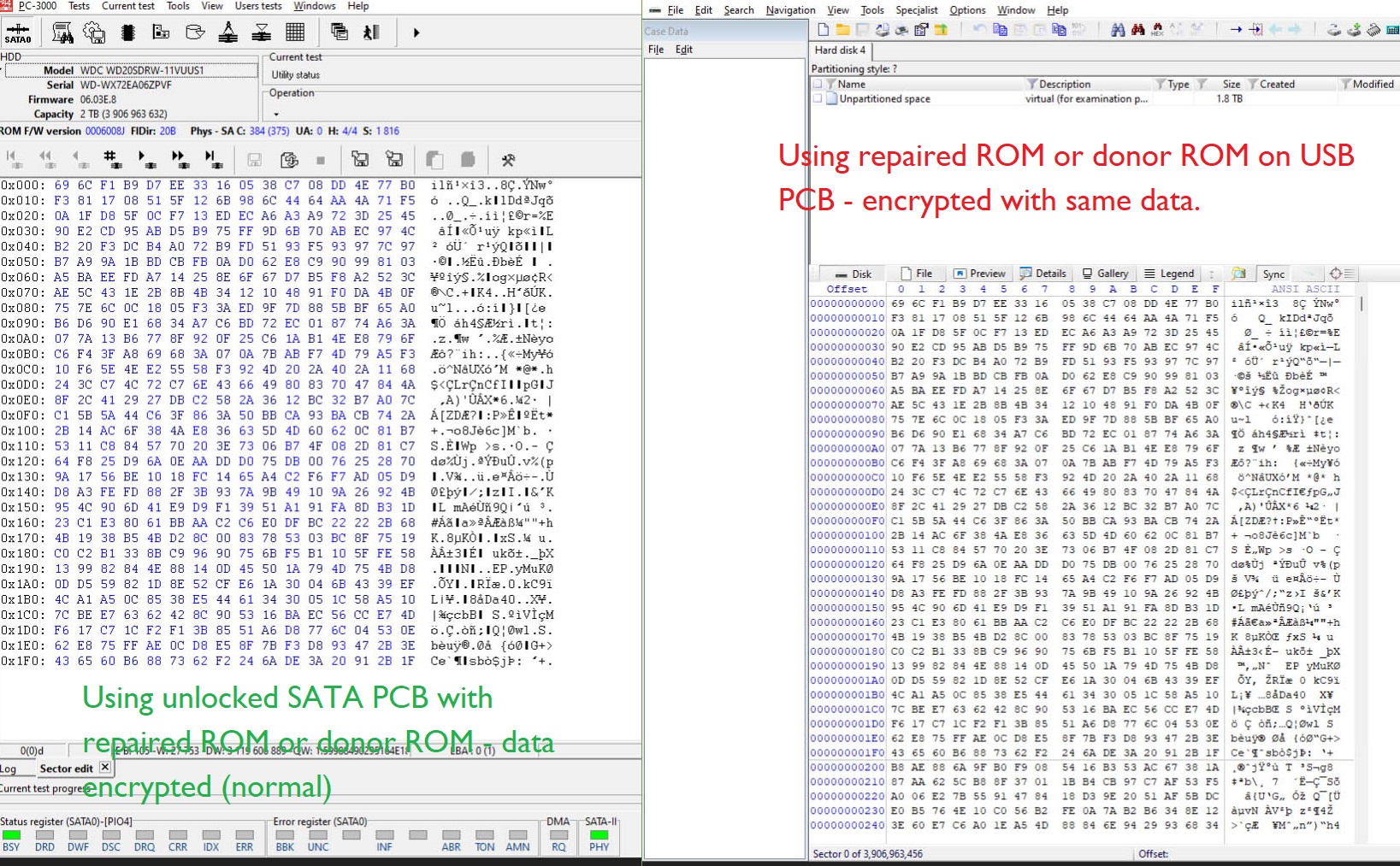

Thanks for the responses. I've been working on this with some help extracting the contents of 129 and creating a repaired version of the patient ROM. This repaired version of the patient ROM now calibrates the HDD to RDY normally with access to the SA. However, when using the repaired ROM, with imported ROM modules from 129, the HDD is unstable and makes clicking sounds and reads slowly. Using the repaired ROM on both on SATA unlocked and patient USB it is still possible to read LBA and shows as encrypted. However, the data shown is the same as when using the donor ROM.
What I did not notice before, is that the encrypted data shown in LBA is the same regardless of when the unlocked SATA or the patient USB PCB is used. See screenshot attached.
To me, this leaves the possibilities:
1) Some failure of the patient USB PCB and that the MCU is no longer decrypting data.
2) The USB PCB is not the original PCB, and that it was swapped with another Charger PCB which does not use MCU based encryption (as per the earlier models of Charger).
Whilst I am aware of the possibility of of disabling SED Lock by comparing 1A2 in the ROM, and 1A2 from with 129.rpm, I am not aware that MCU based SED encryption can be turned on or off. As far as I am aware it cannot.
For reference this is a WD20SDRW-11VUUS1
DOM: 19 JAN 2021
Best regards,
John

If you take a working donor drive and perform the same ROM "repair" procedure, do you still have access to your data? That should tell you if there is anything wrong with your methodology.
Could we see your repaired ROM? Did you try my repaired version?
Read ROM modules
Can people not see that the active directory has a problem? Compare the modules in the 000Bmods and 020Bmods (active directory) in my attachment. The bad modules are filled with 0xFF.
My patched ROM simply copies the modules in the 000B directory over the top of the corresponding uninitialised modules in the 020B directory.
I can't offer any insight into how a ROM can get into this state, but at least this patch should make PC3000 happy.
The .dec files in my attachment are decompressed versions of the corresponding PCMBlock. The "rev" files are dword-reversed versions of the compressed PCMBlocks.

I tried using the 000Bmods provided in the 7z file in two ways:
1) Writing these to the original patient ROM.
2) Writing these to the donor ROM.
The result is the same in each case - PC3000 reports the ROM checksums as OK, but HDD does not calibrate normally. No drive ID, or capacity. Writing back the full donor ROM still allows for correct ID, full capacity and access to all LBA. The data remains encrypted with the same hexadecimal values showing whether the SATA PCB is used or the USB.
Given that the patient USB PCB is not decrypting the data, and given the date of manufacture I would expect it is SEDv2 CPU based, is there any feasibility that method in which controls the encryption (the key) is somehow reset or non-functioning? Clearly, the obvious reason for these results is that the USB PCB provided is not the original, and is an earlier revision that does not use CPU based SEDv2. However, the customer is adamant that it is the original PCB.

Finally, to add - when the patient USB PCB is used on the patient HDD, with donor ROM, the HDD calibrates normally in Windows. Using the WD Discovery software, the HDD reports as "WD Elements". As a consequence of being an Elements series, it does not have the option to set a user password in WD Security.
J
0161 408 4857

Given the DOM of the MCU is a month before the DOM of the HDA then it seems to be in the range of it being native.
Regardless, of what has happened to this ROM, at this point in time there does not seem to be a method to allow for decryption or to resolve what has caused the failure of decryption. It has been necessary to call time on this job.
