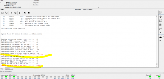

Hard Disk is ST3320613AS / CC2H ~ Brinks Family.
While disk gets detection and I have been able to read some system files too. While imaging in DE disk starts clicking and becomes busy with detection loss.
I think it could be SA defects or weak failing heads. Customer has few photos to be recovered so its low cost FW job only .
I can't change settings in sys 93 (SMP) as drive starts clicking .It has something to do wit MC.
Any tip or trick I can try?
Here is Terminal & full log

System Files I/O method detection...
ATA(indirect)
Reading autotuning buffer...............
OkBuff Root FAT searching in RAM.........
OkSearching module table in RAM... .......
OkSearching DT table(RAM, WR) in RAM......
OkSearching DT table(RAM, RD) in RAM......
OkSearching volume 0 file table in RAM....
OkSearching volume 1/2 file table in RAM...
OkSearching volume 3 file table in RAM....
OkSearching volume 4/5 file table in RAM...
OkRequest for volume 9/A file allocation table in RAM
ErrorSearching SMP RAM FID in RAM............
OkSearching Non Resident G-List FID in RAM
OkSearching CFW OVL FID in RAM............
OkSearch for DBA Base in RAM..............
OkSearch for RW Sys File DBA in RAM.......
OkSearch for MCMT RAM FD in RAM...........
Error

Collecting DT Infos completed
ATA(indirect)
ErrorHDD Redynes timeout (10000)
Soft reset.............................. : Ok
Test : HDD resources backup
Folder: C:\Program Files\ACE Lab\PC-3000\Bin\!Profiles\SgF3\Brinks\ST3320613AS-CC2H-9SZ3HWZ0\Data\SABackup\
Error : HDD Redynes timeout (10000)
Result.................................. : Error
Reading DT to profile folder
Folder: C:\Program Files\ACE Lab\PC-3000\Bin\!Profiles\SgF3\Brinks\ST3320613AS-CC2H-9SZ3HWZ0\Data\SABackup\CPDir\
Backup of service information completed
HDD Redynes timeout (10000) 00 / 00
F3 7>F 3 7
 Post subject: Re: Brinks on the Brink - Pls salvage
PostPosted: May 10th, 2024, 4:01
Posts: 3551
This family doesn't have MC, so it's not that.
If you reached to a point that you can image in DE, did you image head by head?
