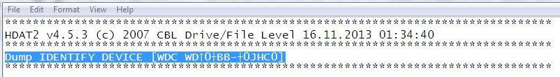

Okay so I've managed to get the system configured so that HDAT2 will save it's reports to my thumbdrive.
I'm using HDAT2 off of two Hiren's disks. One is ver. 9.6 or so and the other is ver. 15.x. the earlier version of HDAT2 clearly says "firmware corrupt" on the main screen, as well as a checksum error, while the later version only mentions the checksum error.
Also note the model "WD800BB-00JHC0" in the title is correct and printed on the HD's label, but this name is corrupted in various places, such as the file name in the .BIX file (see attached, "B__0JHC0.rar") from HDAT2, as well as these excerpts (below) from the HDATCOPY.TXT and HDETECT.TXT from HDAT2 (also attached).
from HDATCOPY.TXT:
from HDETECT.TXT:
PCI devices...
[0/0 01F0h/03F6h/0Eh] WDC WD.0.BB-.0JHC0
[0/1 01F0h/03F6h/0Eh] disabled or not present
[1/0 0170h/0376h/0Fh] HL-DT-ST GCR-8240N
[1/1 0170h/0376h/0Fh] disabled or not present
I don't know how significant the "naming corruption" issue is. When I try to paste the text from HDATCOPY.TXT it appears normal, so I've pasted a screen-shot instead.
I hope this data is useful. Please let me know if there is anything else I can provide that may be of value. Thanks for the help.

Re: WD800BB-00JHC0: Corrupt Firmware?
November 16th, 2013, 4:49
Your drive has a stuck bit on the IDE interface.
If you compare the data in the IDENTIFY DEVICE dump against the expected data, you will see that bit #13 is stuck low. This corresponds to pin #14 on the IDE interface.
Here is the pinout:
http://pinouts.ru/HD/IdeInternal_pinout.shtml
Remove and reseat the IDE cable, examine the connectors for a bent pin, check the HDD PCB for a dry solder joint where the connector attaches to the board, or try another cable.
The following article explains the problem in more detail.
Bad model number due to stuck bit in IDE interface:
http://malthus.zapto.org/viewtopic.php?f=59&t=147&p=262
You can see the bit differences here:
44 57 20 43 44 57 30 18-42 10 2D 42 30 10 48 4A   DW CDW0.B.-B0.HJ
30 43 20 00 20 00 20 00-20 00 07 20 00 20 00 20   0C
44 57 20 43 44 57 30 38-42 30 2D 42 30 30 48 4A   DW CDW08B0-B00HJ
30 43 20 20 20 20 20 20-20 20 20 20 20 20 20 20   0C
November 16th, 2013, 14:09
fzabkar wrote:Remove and reseat the IDE cable, examine the connectors for a bent pin, check the HDD PCB for a dry solder joint where the connector attaches to the board, or try another cable.
I replaced the IDE cable and the model name appears normally now, however it still will not boot. Right now I have Easeus Partition Manager (Server) from the Hiren's 15.x disk running, looking for partitions. Easeus reports the HD as being 100% unallocated.

Drive -> Select Drive
Check the Show Partitions box
Select your physical drive and OK
R-click the 80GB partition and select Insert the Partition (Undelete)
This should add the 80GB partition to the partition table in sector 0.
Now exit DMDE.
Reboot the system and allow Windows to rediscover the drive.
Now run FIXBOOT against the drive. Hopefully this will undo the damage to the NTLDR stuff.
WARNING: Please backup your data. I have personally been stung by FUXBOOT. In my case it wrote a 10MB FAT12 boot sector over a FAT32 file system and caused me lots of grief. I have seen even worse damage in several storage forums.
November 18th, 2013, 13:42
The data isn't what's valuable on the HD, it's the O/S and the configuration settings, drivers, etc... It's part of a business network, and if the O/S goes bad I'll have to find a disk compatible with the Product Key, do a New Install, fully update, install drivers for several devices, set IP addresses for network printers, etc... and install several proprietary, industry-specific softwares in order to get the machine back to it's former functionality.
About 20 hours of my time, 10 of which will have to be spent on-site. I'm pretty clear on most of what you've said, but not sure why I can't simply copy/paste the "back-up" sector to sector 63?
I assume that Sector 63 is the start of the old partition. Is it always sector 63, or does that change? Is the data in Sector 63 simply a "start of partition" marker, like a "start of file" marker, or is there more to it than that.
Your pasted data is so similar to mine that I can't help but wonder what would happen if I pasted that in.
I'll do the manual edit as you've suggested. Do you know of any data back-up technique/method that will allow me to avoid having to reinstall the whole O/S? Can I make an image of the HD as it is right now, reformat and recreate the partition and then overlay the copied image on top of the new partition?
Does it work like that?
