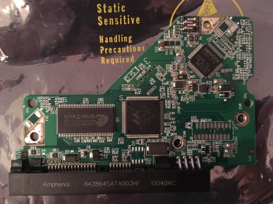

I have a Western Digital WD6400AAKS not spinning up. Checked the TVS diodes, cleaned the contacts between the logic board and drive. There is no BIOS chip on this one, so the firmware must be in the Marvell chip. I did swap the board with a similar board (knowing that it wouldn't fully work), and the motor spins up but of course won't read without the proper firmware.
Question, I think the best option is to try to swap out the logic board and have the firmware transfered. I contacted HDD-Parts.com (Datapro). I sent them photos of the drive and Logic Board looking for a replacement logic board and firmware transfer - received a response that would attempt to repair the original logic board for $35diag + $35repair - total $70 plus shipping. They'll send me the repaired board, if it doesn't work they'll refund me $25. I suspect the Smooth chip is bad (although I can't be certain). Kind of a tough chip to replace - seems simpler to get a replacement board and transfer the firmware.
Any advice?

The SMOOTH chip generates the onboard voltages. If these are absent, then the SMOOTH IC would be a likely culprit.
If you upload a photo of your PCB, I can show you what to test.

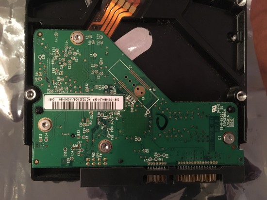

I assume you have uploaded a photo that is waiting for approval ...
Re: WD6400AAKS not spinning up!
February 7th, 2020, 22:05
Here are the pics
February 8th, 2020, 4:04
Measure the voltages at Q1 (near the "ROM") and L1 and L2 (inductors near SMOOTH chip). Q1 is the +3.3V supply, while I expect that L1 and L2 would be +1.2V (Vcore) and +2.5V (Vio).
If any voltage is missing, measure the resistance between it and ground. You can use the working PCB for comparison.

Q1 voltages p1-3: 3.95, 5, 3.28
L1 voltages: 1.178, 1.188
L2 voltages: 2.569, 2.577
(Screw hole as ground)
February 8th, 2020, 15:34
It looks like the SMOOTH chip is generating the proper supply voltages.
Did the drive come from a desktop PC? Is there any possibility that PUIS is enabled (Power Up In Standby)? PUIS is commonly enabled in DVRs.
I don't know if the demo version of WDMarvel is able to read the "ROM" code from you board. If not, then there may be another way, but it would require a lot of mucking about with TTL adapters and shorting points on the PCB.
Still, one would think that hdd-parts should be able to read the ROM in this state, if they have the DR tools, and if the MCU and its oscillator are working.

Rolin wrote:Yes, it came from a PC. Since the smooth chip is testing good, and another board spins the motor, does it still seem to be a board problem? The fact the other board spins the motor confirms its a board problem, correct?
The SMOOTH chip performs several functions including power control, spin motor control and voice coil motor control. We have verified only one of them. It does appear to be a board fault, although we can't say which chip is the culprit.
