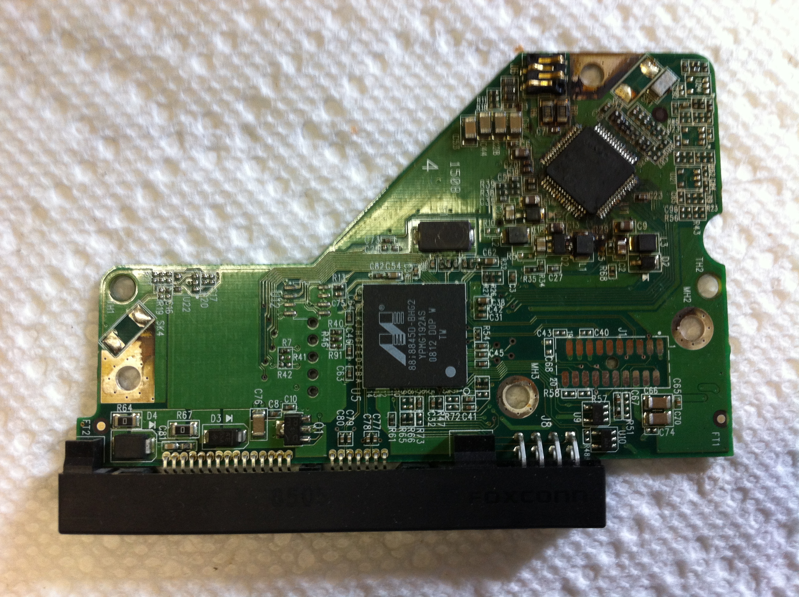

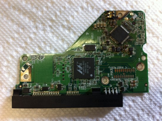

I keep seeing this in alot of post "Move the Main Controller IC (the biggest chip on the board)", but does that mean a DIY cant do it?
The number on the green part of the Original board is 2060-701537-004 REV A. On the White label it is 2061-701537-R00 AD. It's for a WD7500AACS-006B0 External drive.
I need this kind of swap to make my HD work again to get the data off but I havent seen anything on how to remove the chip.
My issues started back in Feb when my drive wasn't found in windows so I opened the enclosure and separated the drive from the case and plugged it into the Motherboard sata connection. still no sign of it in windows and the drive wasn't spinning.
So I contacted Datapro and they had me to send them the pcb for repair and I think they finally finished off the pcb. After 3 months after being sent out the pcb is burnt up and still doesn't power the HD (wont spin)
In the mean time I got on the ebay and bought another drive, thinking I could just swap the pcb's and get my old HD to work. The numbers on that board are (2060-701537-004 REV A) (White label 2061 701537-R00 AD XC 6Q05 8EXN M 0002060 9062) and this drive is a working drive and windows finds it.
So I swapped the pcb on to my old drive that I want the data off of and the drive will spin,but it isn't found in windows.
So then I found out that the bios might need swapped from board to board to make it work, but I ran up against the Main controller swap problem and I don't see a way for me to get it off to try it.
I've tried searching google and this forum and also youtube to see if I could find a demonstration video on how this is done, but I havent found anything yet.
So now I'm asking to see if anyone could offer any help in this?

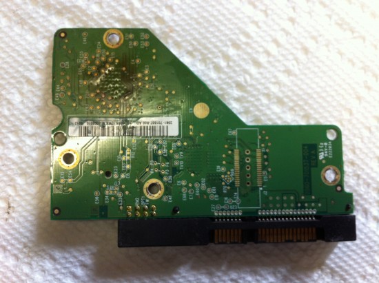

Just a question - all the charring of the PCB around the controller chip, is that how it came back from the repair service? If so that's just an attrocious job, it's like someone with no clue hit the board with nothing more than a household paint-stripper/heatgun for far too long without any protection to the parts around the chip. Sure looks like the board is completely dead now!
Can you provide a larger version of the burned photo?

This model has no external ROM meaning the native ROM can be restored from the SA without the need for a repair of the native PCB.
Do yourself a favour and send the entire HDD, not just PCB, to a reputable firm who can handle it safely for you. As far as DIY goes, assuming there is no other problems, the process of restore ROM from SA is relatively straightforward, but requires specialist equipment and knowledge of the process. Also, there is always the possibility of other complications which can be addressed directly by a professional.

Here is the kind of thing that the professionals actually do:
Fix Identification Problem caused by Corruption of ATA Overlay module or ROM content:
http://web.archive.org/web/200910011647 ... m-content/
As you can see, it is essentially a simple, non-invasive job. You can purchase the software for much less than the cost of a typical data recovery. There is one PCB supplier who purports to provide a free PCB adaptation service, but I would feel remiss if I didn't alert you to the following threads:

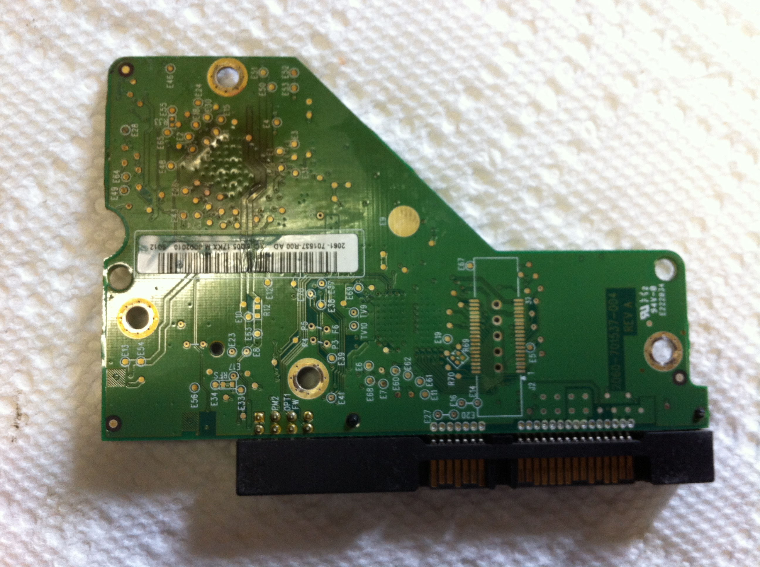

Here are some bigger pics and yes this is how it came back to me :

Dammnnn.. I bet there's all kinds of delamination and maybe torn vias in there. At least the local electrical and high-frequency characteristics will have changed.
I can do better with a safety pin and a $10 iron from radioshack! And I kid you not! heat each pin, and lift a fraction of a mil. Repeat 99 times as you work around the chip.
Of course that is no substitute for a solder pot or temp controlled airgun with shields and airflow guides and all that.
Exactly which company did that, what's their website?

BGA chips are a little harder to move because you usually need two sources of heat (top and bottom) and decent amount of practice.
Sometimes (preferably always) the chip needs to be re-balled (new pads of solder applied) before you can solder it on another PCB and you'll need special stencil for that
And w/o practice it is very high chance to damage chip pads while taking it off the PCB. That will damage the chip permanently.
Bottom line is - the cost of proper tools(and no practice) will be more than the cost of moving the chip to another PCB at the place that specialize on that kind of repair.
Keep in mind that the chip might be already dead and all that could be for nothing.

I can't see the soldering work around the SMOOTH chip. The image is too blurry. I get the best results with a flatbed scanner.
I would compare any discernible part numbers against those of a good PCB. Maybe the wrong SMOOTH chip was used?
I tried what you said with my flatbed scanner but still the chip is unclear for me to post.
Also I got you pm, but can't reply yet because I'm too new to the forums. TY for your advice.

Well, I know one place I won't ever be asking to do work on my boards for now! For the record, I do SMD reflow work here, though mostly I'm manufacturing assemblies rather than repairing them ( I repair a few since not every initial reflow works 100% and you have to manually redo it ).
What bothers me in this case is that it was "only" a TQFP chip, which are fairly easy to remove and replace - possibly it has a ground plane contact on the underside but even still the damage done to that board far exceeds what needed to be done. It's scary what "professional" services can get away with.
