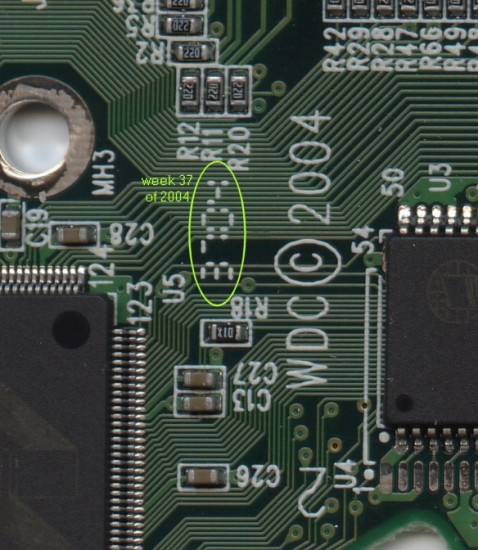

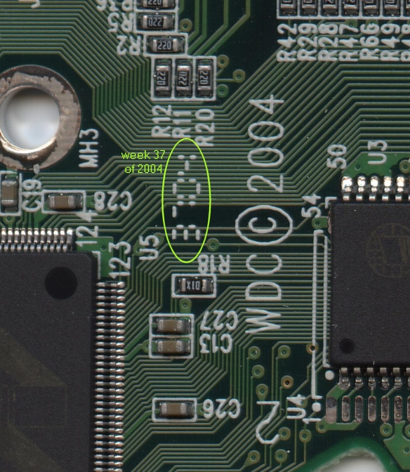

WD's PCBs also have a WWYY date code printed on them.
