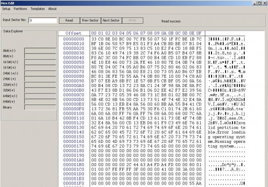

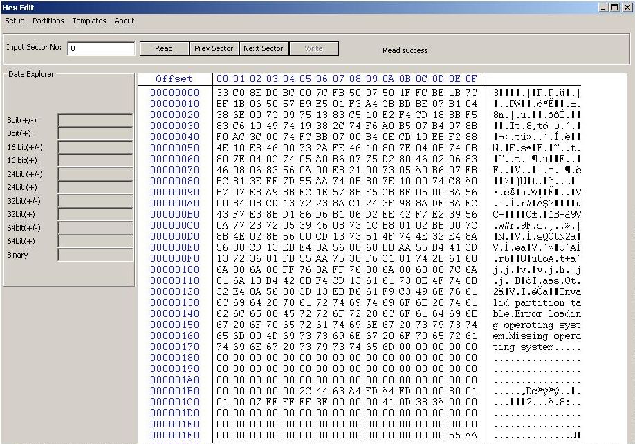

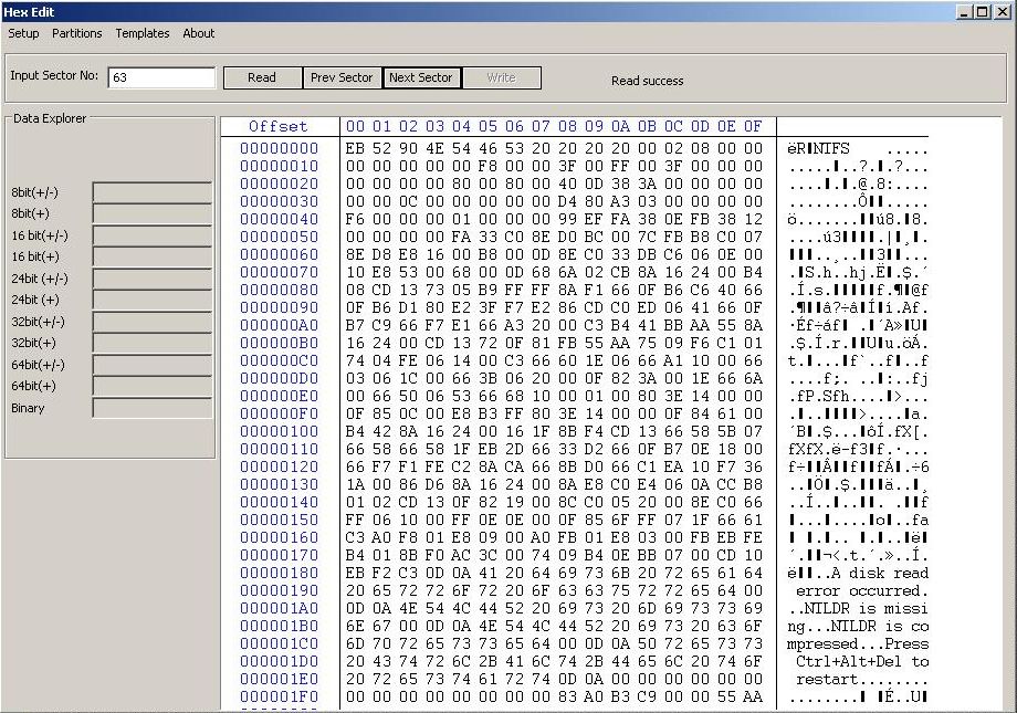

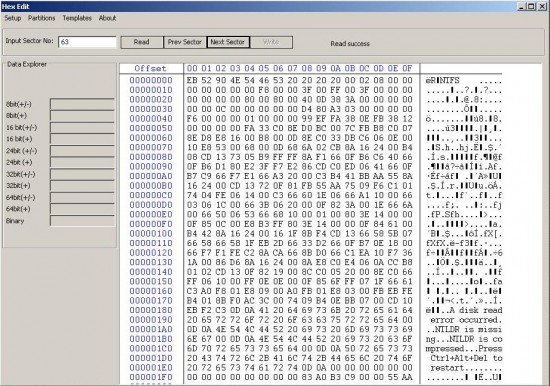

 Post subject: Re: WINXP - disk read error - partition problem
PostPosted: April 17th, 2014, 5:56
Posts: 396
Location: slovenija
Dear Mr. Zabkar,
sector 0
and sector 63
Thank you very much
PostPosted: April 17th, 2014, 6:35
Posts: 17215
The boot sector is indicating that the NTFS volume begins at sector 63 (= 0x3F) and has a size of 0x3A380D40 sectors.
The partition table has a single NTFS partition beginning at sector 63 and with a size of 0x3A380D41 sectors.
The partition size is ...
0x3a380d41 x 512 bytes = 476929.657 megabytes
I believe there should be a backup NTFS boot sector at sector 0x0x3A380D7F.
In short I can't see any problem.

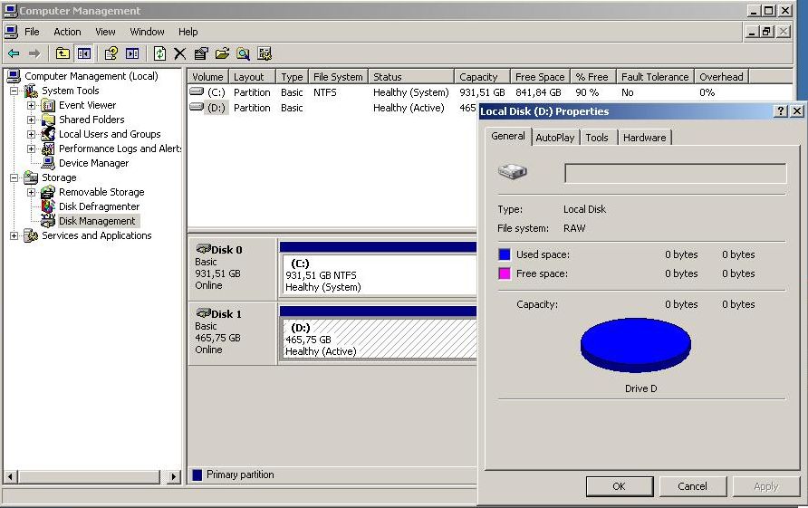

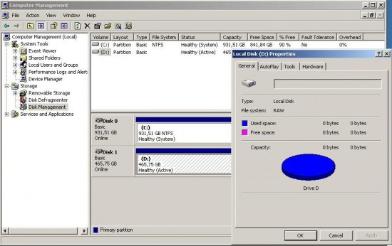

PostPosted: April 17th, 2014, 16:45
Posts: 396
Location: slovenija
Dear digitalferret and Mr. Zabkar,
there is unpartitioned space around 10MB(as digitalferret mentioned).
In Windows Disk management drive is healthy with correct size, but without file system.
