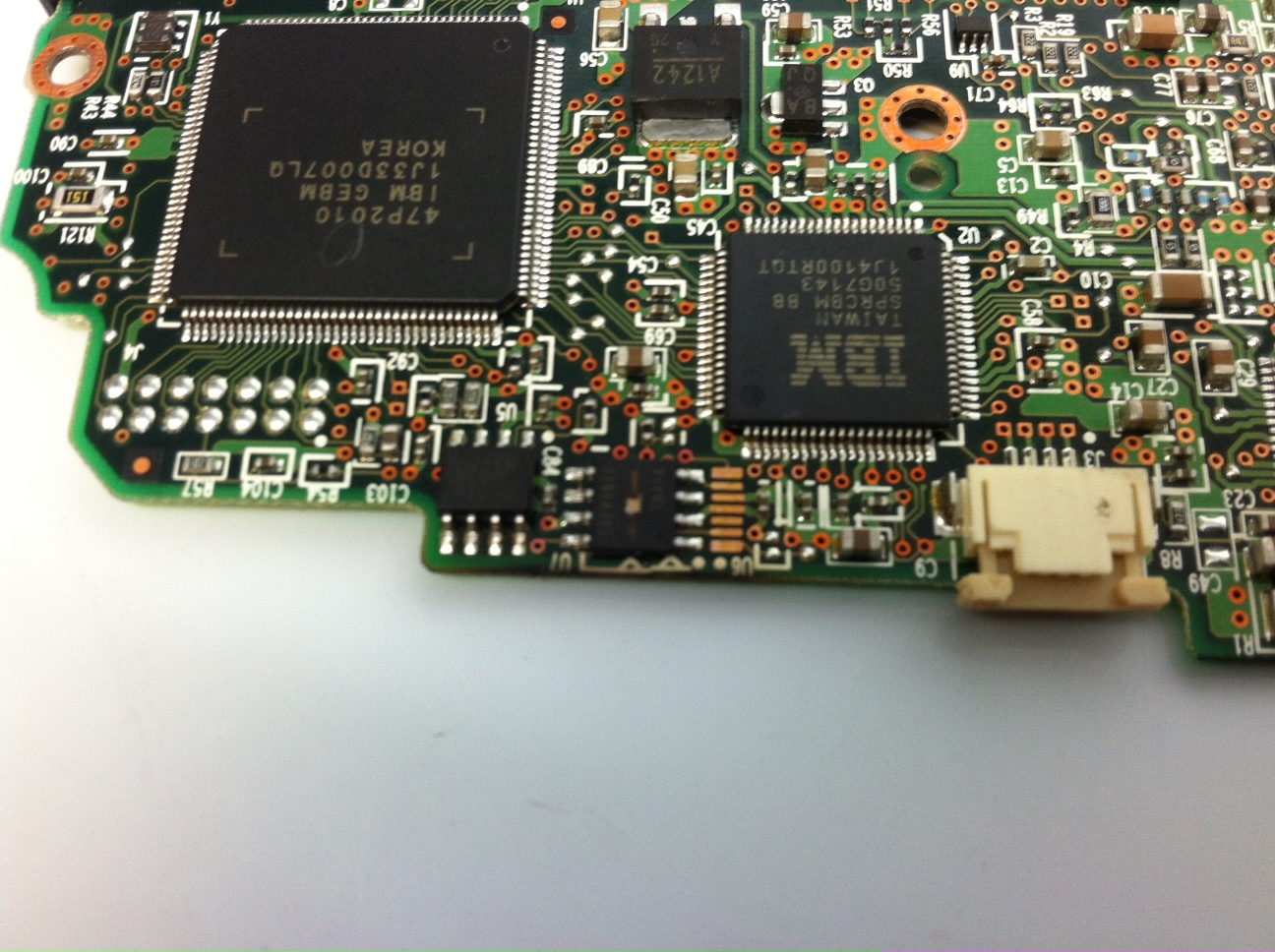

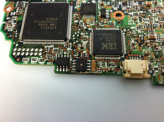

 Post subject: Which is the Correct ROM Chip on Hitachi IC35080AVVA07-0
PostPosted: June 30th, 2014, 17:50
Posts: 1777
Location: Phoenix, AZ USA
I need to swap a ROM chip on this board. The chip on the right is marked with a 25, but does not look like a standard ROM chip. The chip on the left does look like a standard ROM chip, but is not marked with a 25? Will the real ROM Chip please stand up?

Tell us the markings on the chips and someone will identify them for you.

I think the board has been resting on something as the numbers are a little worn, this is the best I can do.
The chip on the right is 25FV101T 1BA1A
Chip on the left is S93C6 6D22 4365
Thanks :-)
 Post subject: Re: Which is the Correct ROM Chip on Hitachi IC35080AVVA07-0
PostPosted: June 30th, 2014, 19:45
Posts: 17323
It sounds silly when I say it, but S93C66 is the "NVRAM", while 25V101T is the "ROM". In fact neither is a ROM and both are NVRAMs.
PostPosted: June 30th, 2014, 19:50
Posts: 1777
I think that's what has been confusing me. I know on this Hitachi its the NVRAM I need to swap (according to Donor Drives). Many thanks for the help. Much appreciated.
