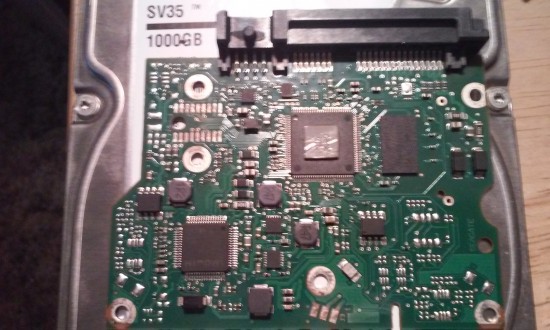

Hello All! I am new to the forums here and while I have a little bit of technical knowledge, I have never really work with Hard Drives at this level so I am looking for some advice. The patient is a Seagate Model ST1000VX000. My PSU went bad and upon replacing it the drive would not spin up at all. The Drive is still under manufacturers warranty but although I have backups of most the data on the drive there is still around 200gb that i don't have backed up and would like to recover and I cant justify spending a small fortune doing it. I am to believe that the PCB is to blame but I want to be sure before replacing it.
Seagate SV35
Model - ST1000VX000
FW - CV13
PCB - 100664987 REV B

Could be "just" the Pcb, in worst case also the preamp.
Change Pcb and swap Rom...if it works...all fine. If not, then need for a DR company to take a look.

 Post subject: Re: Seagate SV35 ST1000VX000 Won't Spin Up
PostPosted: May 29th, 2015, 17:35
Posts: 17324
Check these components:
http://www.users.on.net/~fzabkar/HDD/ST ... 01_TVS.jpg
Your PCB is not identical, but the same components should be identifiiable.
The preamp is inside the drive on the headstack.
The ROM is shown in this photo:
http://ep.yimg.com/ay/yhst-144375849714 ... 4987-1.gif
Can you upload a photo of your PCB?

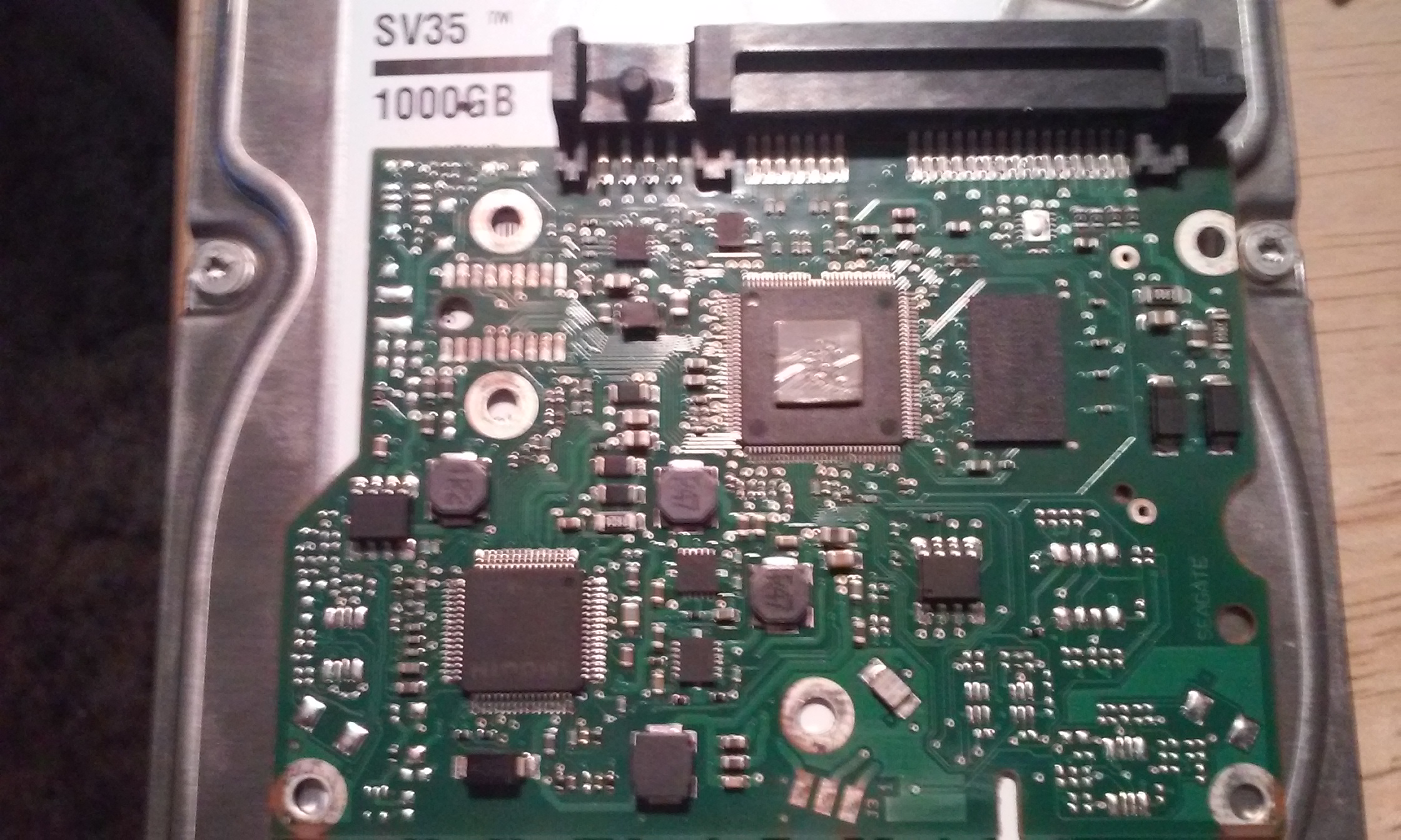

Thanks Much...Here is a pic of my PCB

Posts: 17324
The photo is terrible, but I can't see any obvious signs of distress on the PCB. You need to measure the TVS diodes and zero-ohm resistors before proceeding.

Sorry about the terrible photo. I will test the TVS and post back when I can.
If I understand this I test the TVS Diodes on the 200 OHM range correct?

Posts: 17324
All you are looking for are short circuits, so the 200 ohms range is fine.
