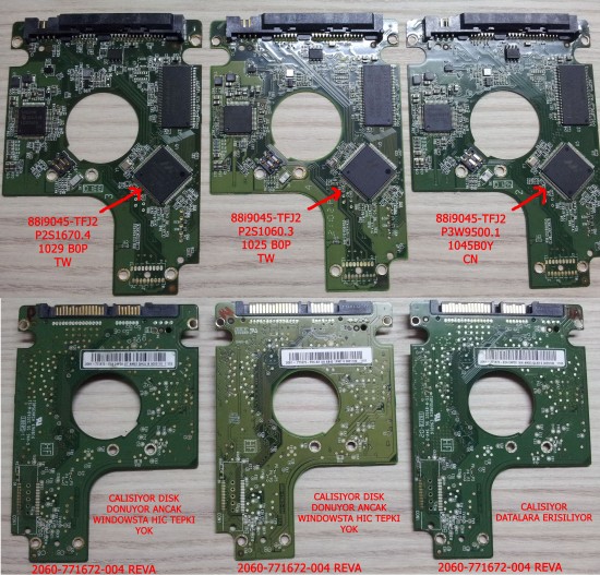

I have two harddrive Western Digital 320 GB 2.5 with same PCB 2060-771682-004 Rev A
One of is completly crashed and Windows can not see this Hard Drive
other harddrive is working perfectly I change the PCB and change the bios too with working PCB but still do not work
I think the bios is damaged because the other working bios is work with two same PCB s
Please help if you have any idea
Is there a way to fix the bios

did you try the other pcb without changing BIOS, does it spin that way ?

Yes I try it starts to spin but not to start recognize. So Operating system does not give any sign about harddrive.
But another detail** healty bios (I think ) Works with two PCB without any problem spin and recognize..

is the main IC chip number same?
Ana çip aynı mı?

Tekrar selam hepsinin PCB numarası aynı sadece 1 HDD sağlıklı çalışıyor ve dataları gösteriyor
Hi Again all the PCB numbers are same, one of the harddrive ( right one ) work as well and can Access data.

Is Changing bios and ICC fix this problem

most likely problem is not PCB, could be FW, bad sectors or heads.
If data is important i would suggest to contact a DR company.
