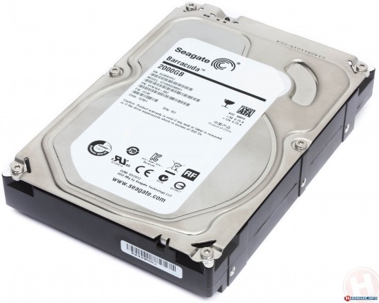

 Post subject: how to connect to terminal
PostPosted: October 30th, 2015, 11:12
Posts: 242
hot to connect with terminal

bsy error
 Post subject: Re: how to connect to terminal
PostPosted: October 31st, 2015, 17:45
Posts: 331
The 7200.11 BSY error fix is does not works on 7200.14 drives.
About terminal connections: Use two pins that nearest to SATA connectorand use 38400 kbps connection.
