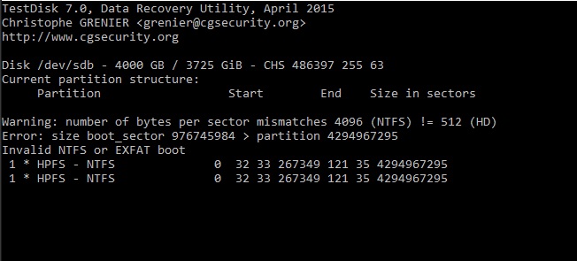

The drive is not encrypted. Windows and EaseUS cannot understand the file system for the reasons that I explained in my earlier post, namely that the sector sizes do not match.
    465.75 gibibytes x 8 = 3726 gibibytes
Just buy another WD PCB from a 3TB+ My Book (not an Essentials), or hunt through your trash.

ok I just confirmed that the HDD is not encrypted. I used testdisk and was able to successfully copy files out of the HDD.
Warning: number of bytes per sector mismatches 4096 (NTFS) != 512 (HD)
I don't want to mess it up when I'm this close to making a 100% recovery. Can someone please guide me on how to change the sector size form 512 to 4096?
and how to correct the size boot_sector error.

Since I was able to extract the files inside the HDD with the testdisk, I'll just use the software to copy all the files I could get out of the HDD. Thank you so much for everyone's patience and help with this issue.
[SOLVED]
