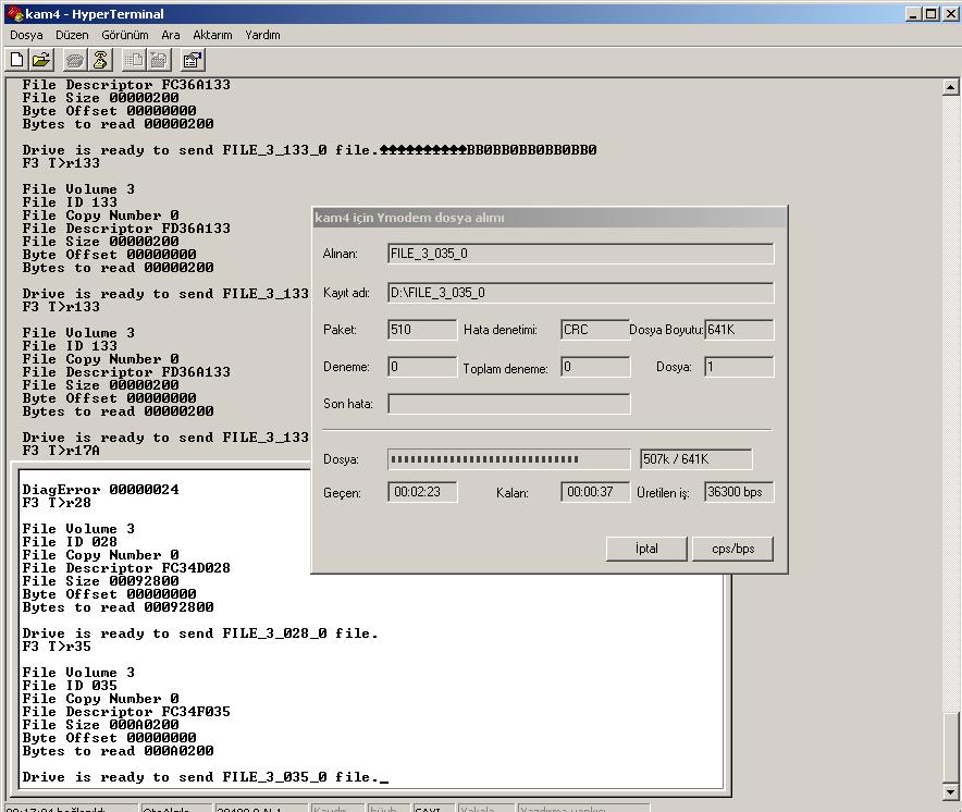

r-read
w- write
i read some files from proper same model hard drive. with " r17A" "r133" "r28" "r35"
and after "w" it. w17A, .......
i use Hyperterminal's Y-modem..
http://forum.ru-board.com/topic.cgi?for ... start=1180

if the file is greater than 1 mb USB driver could halt and you'll see blue screen and restart.
You must use USB-TTL adapter.
DKU-5 cable is inefficient.
