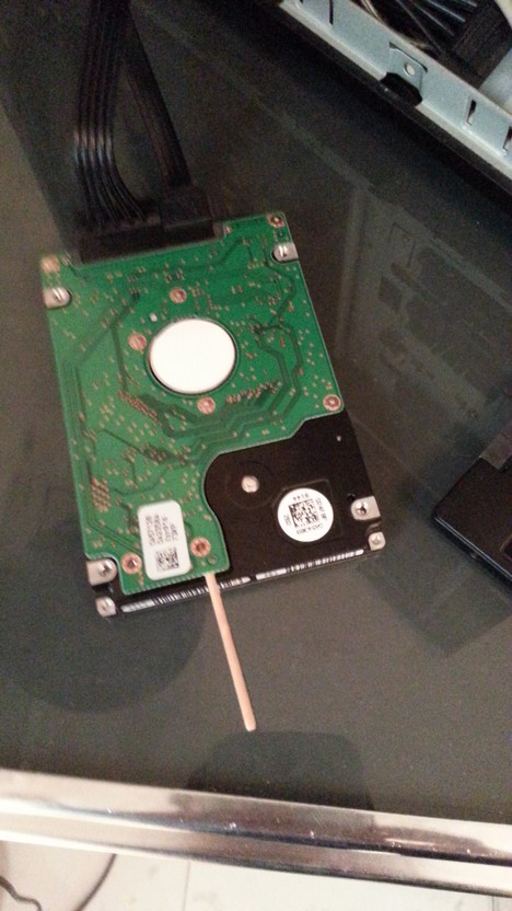

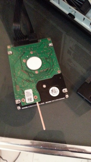

Hi Dick, the same thing...... i follow the tutorial, i remove 2 screws from the hda controller pcb and i lift with a toothpick, connected to the sata0 in the computer as ide mode. run zu with the /p8 parameter and later i tried with the /s. but nothing happen, only time elapsed 00.00, and i wait until 2 minutes but nothing.
i wonder if this hdd need to be jumper by other method as it say in the tutorial maybe faulting the nvram or shorting specific points on the pcb, i don't know.
thank you for all

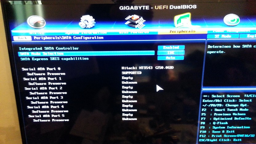

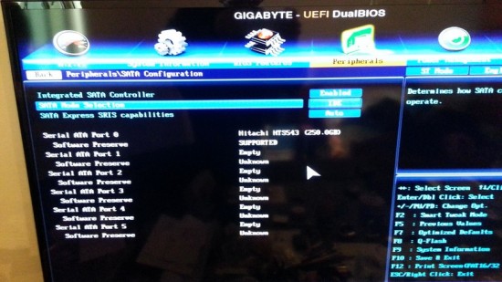

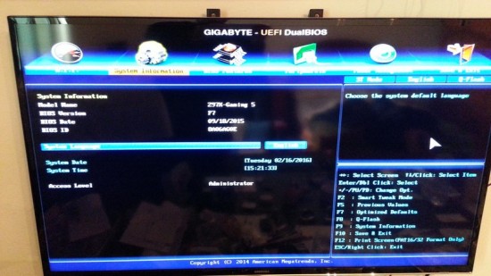

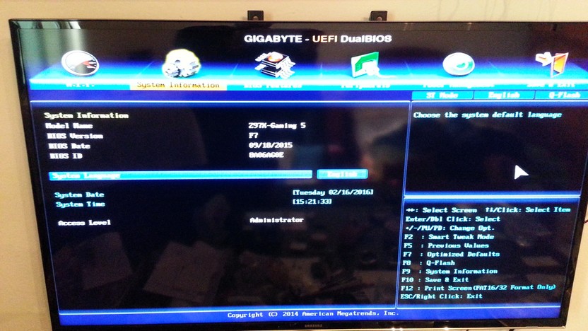

Hi, i think that i have a problem, i tried with other sata hd 2.5" that runs perfect and i can access under windows 10 and under msdos i can't access it, no recognize the hdd. I don't know if there should be a specific configuration in bios. i wonder if is a problem with the boot files in pendrive, this pendrive have windows 98 boot, basic autoexec.bat and config.sys files. I have read that msdos no recognize sata hdd or i don't know how to do for detect it.
There is no unit to detect the sata hdd, i try a: b: c:(pendrive) d: ......... z: nothing detect hdd sata only detect the pendrive in c: with the boot system
Please could you tell me how runs yours system for detect hdd sata under msdos with zu program? what boot files do you use? what configuration un config.sys or autoexec.bat is ok?
i upload some pictures from my pc computer where i run the checks, is a i7 4790k, 16gb g.skill tridentx 2400mhz, mobo is a gygabyte z97x gaming5
bios picture, can check that is in ide mode and hitachi identify ok

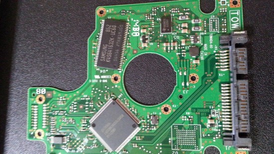

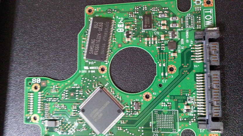

hitachi pcb
how i run the zu program
thank you

Hi again, i don't know what happen with the image hosting, i attach the pictures instead load from the hosting:
hitachi pcb

 Post subject: Re: Hitachi 5k320
PostPosted: February 18th, 2016, 6:11
Joined: October 24th, 2005, 17:04
Posts: 242
what address shows mhdd to sata port 0 ?
it is possible that sata port 0 is not primary(secondary) channel

Ok moltke, i run mhdd and this is the result, i check that detect like a pci controller?? i'm very surprised, is normal?
thank you
PostPosted: February 18th, 2016, 20:11
Posts: 242
the program will work
on 1) -Port 1F0h (Primary controller)
or оn 3) - Port 170h (Secondary controller)
but not at 6) - PCI controllers
PostPosted: February 19th, 2016, 5:50
Joined: February 9th, 2016, 8:43
Posts: 26
Location: Spain
Hi moltke, i have no way to connect this hdd in primary channel in this computer, chipset is "intel z97".
I think that one solution would be that ZU could works with the pci controller, but to this day zu no works with these option.
