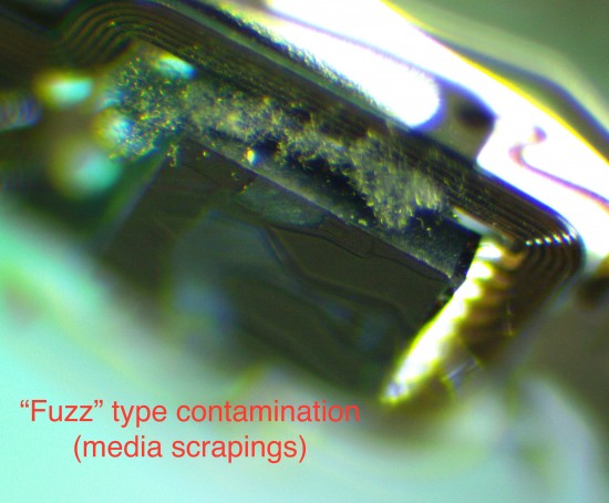

Close-up of head contamination from a 3 TB Toshiba (Hitachi)

So, you plan to clean and re-use the existing heads or replace them? Or does the media look like a lost cause?

Looks bad. I guess it is better to go with donnor heads. One question, where did that contamination come from? Has the hdd been opened before o it came from a head crash?

The fuzz is the coating from the platter. Have seen before, most recently last week on a WD Passport drive. Head is mangled just enough to cause very mild scratching.

Also seen that a lot on Seagate 7200.10 drives.

Normally, I'd replace these. The platter surface isn't visible.

As noted in the thread by labtech, the contamination results from the head scraping the media.
The drive had been opened by a non-professional before we received it, but I think that is unrelated to the cause of the contamination shown.
