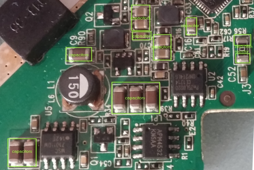

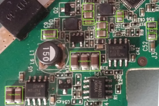

@candys067, measure the voltages between the ends of each of the 12 highlighted capacitors.
Measure the voltage between ground (the metal case of the USB socket) and each side of the zero-ohm resistor.
Be very careful not to short adjacent pins with your probes, as serious damage could result.

I know this post is > 2years old, however, I've just run into exactly same issue. I have WD My Passport Essential 1TB external drive. It stopped powering up last week. When disconnected from the case and connected via universal USB/SATA connector the disk spins up and can be discovered by the OS. Obviously the disk is encrypted and TestDisk can't rescue it. I have measured voltage on all 12 capacitors and 0ohm resistors:
outcome: voltage on both ends of the 0ohm resistor show 12V,
capacitors show voltage (1V, 2.5V,5V and 12V)
is this what they are supposed to measure? what should I do next?

@dyll, those voltages appear to be OK.
    1V = Vcore for bridge IC
    2.5V = Vio for bridge and serial flash (U2)
    5V = HDD +5V

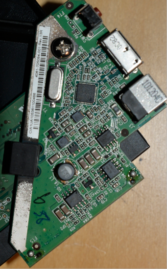

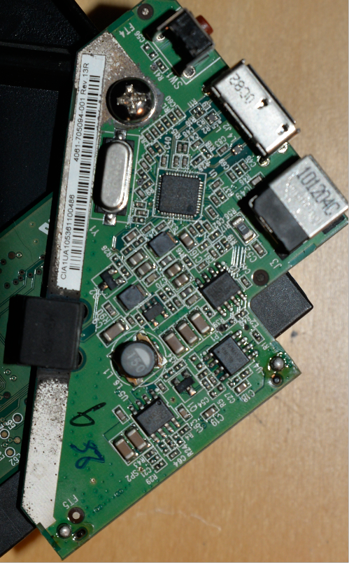

@dyll, can you post a picture of your board ?
 Post subject: Re: External HDD to SATA fail
PostPosted: March 1st, 2017, 19:55

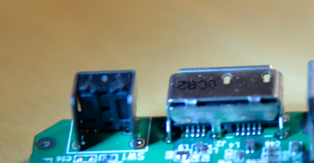

Joined: March 1st, 2017, 15:52
The LED lights up and stays on.
The joints at the connector look fine.
Adding some pictures of the board.
File comment: USB connector
File comment: board
PostPosted: March 1st, 2017, 20:21
Posts: 17215
A solid LED is inconclusive. If it were flashing, then we could be certain that the bridge IC were alive. Instead ISTM that the bridge IC is probably dead, at least on the digital side.
Is there is any response if you press the pushbutton?
