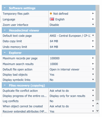

There's a few parameters under settings which might have to be increased, if you really have hundreds of thousands of files on the HD:
Give it more memory, search results, etc. Could that be helpful?

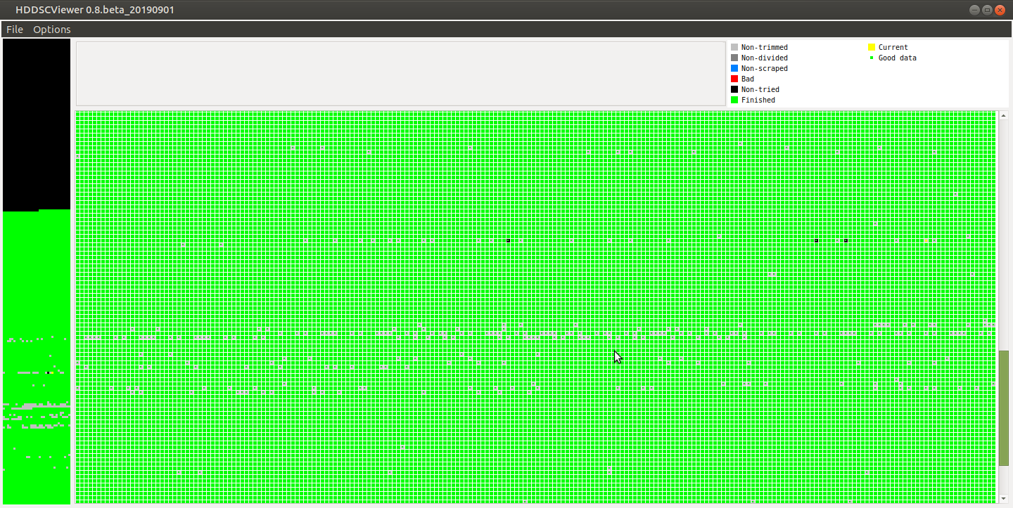

Perhaps you could post a screenshot from HDDSCViewer ? It may provide some clues as to what the issue with that drive could be. If it looks like alternating stripes of good and bad reads, it generally means that one head (or more) completely failed. See this thread for instance.

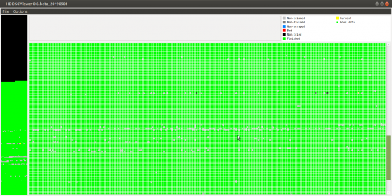

Interesting program, I did not know that one. Before we come to the result: I copied the damaged HD to a new one of same model (Seagate ST4000). First, I used HDD Raw Copy. That went slow, but without any errors, until a power spike or something caused a reboot. So I switched to HDDSuperClone, starting from the last position which I had written down before that reboot. Therefore, the first ~30% are black (untried) in the plot. So here it is:
There were no BAD clusters in the sense that HDDSuperclone gave up on them. At some point, the recovery rate slowed down to a trickle. It was about less than 0,1% of the data anymore and getting that might have taken a month or so. So I gave up and started looking at what I have got so far.
I am a layman but to me, there is no regular pattern in the hard-to-read clusters. This looks more like some zones of the surface have started to fail, doesn't it?
