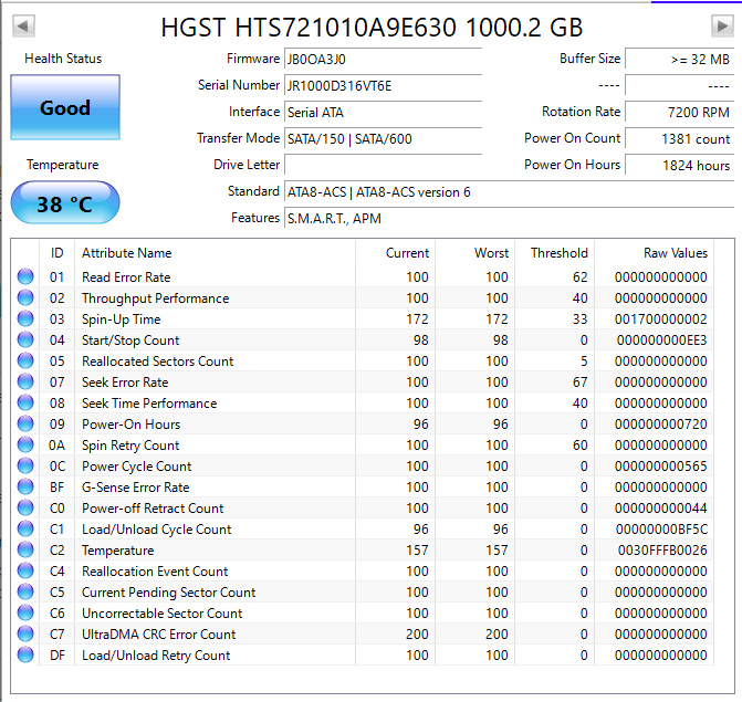

I just pulled an HDD out of an old laptop, intending to make use of it.

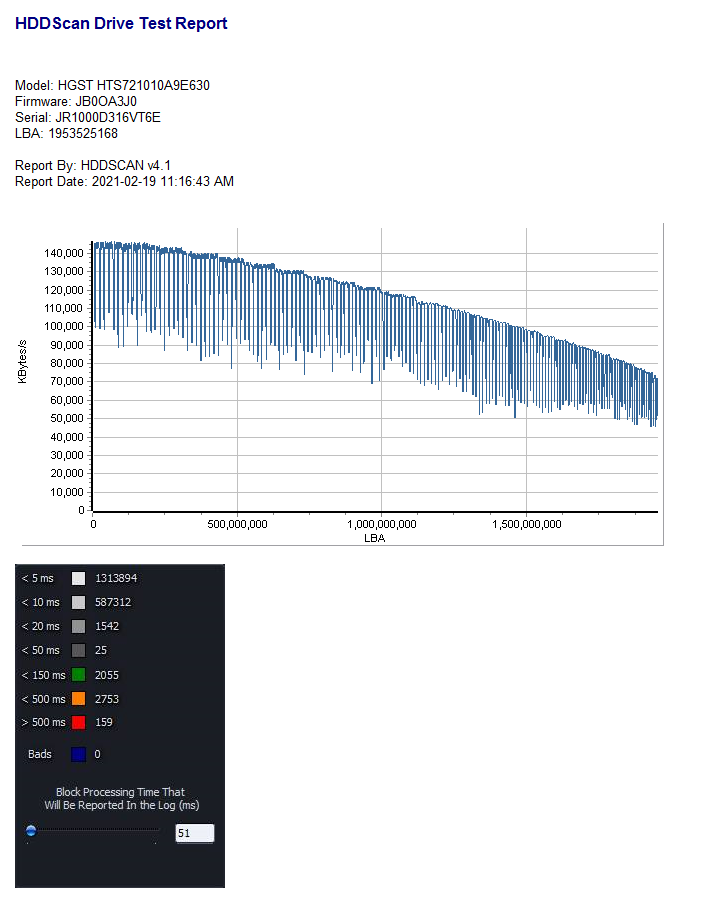

I ran HDDSCAN's verify test and found ~3,000 slow sectors (no bad sectors, though).
Are these indicative of impending HDD failure or is this normal?
SMART attributes do not indicate any issues and, in fact, this drive hasn't been powered on for long, considering its age.
Thanks in advance.

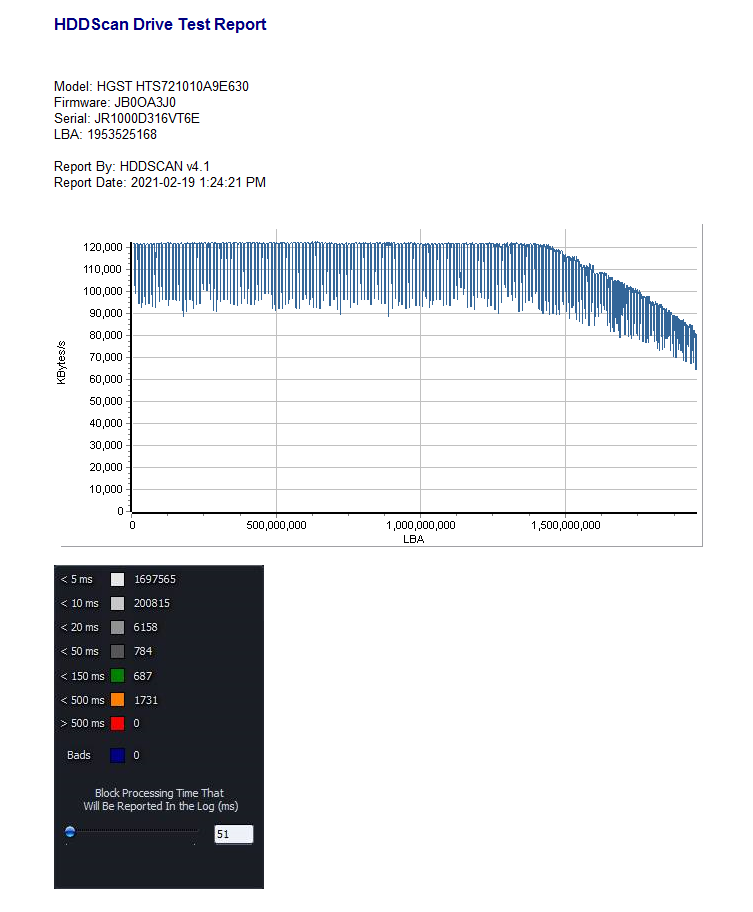

Write test performed a bit better.

Older drive, but everything seems fine. Perhaps use as a secondary backup or temp storage.
It looks like a "weak head" to me.

What are the consequences of a "weak head"?
 Post subject: Re: Are slow sectors indicative of HDD failure?
PostPosted: February 25th, 2021, 3:17
Posts: 849
Head degradation.

Does that mean it's not long left for this world?
