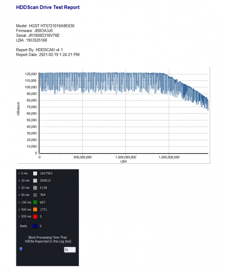

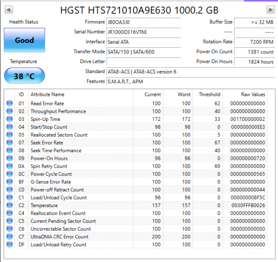

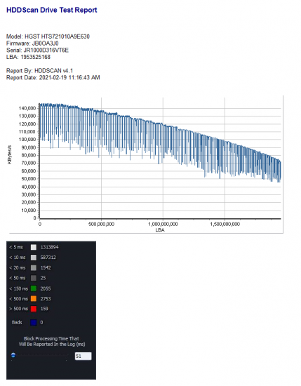

 Post subject: Are slow sectors indicative of HDD failure?
PostPosted: February 19th, 2021, 14:25
Joined: March 4th, 2019, 16:14
Posts: 17
Location: Canada
I just pulled an HDD out of an old laptop, intending to make use of it.
I ran HDDSCAN's verify test and found ~3,000 slow sectors (no bad sectors, though).
Are these indicative of impending HDD failure or is this normal?
SMART attributes do not indicate any issues and, in fact, this drive hasn't been powered on for long, considering its age.
Thanks in advance.
SMART.PNG [ 57.68 KiB | Viewed 8989 times ]
Read Test.PNG
Read Test.PNG [ 90.35 KiB | Viewed 8989 times ]
 Post subject: Re: Are slow sectors indicative of HDD failure?
PostPosted: February 19th, 2021, 16:25
Joined: March 4th, 2019, 16:14
Posts: 17
Location: Canada
Write test performed a bit better.
Write Test.PNG
Write Test.PNG [ 87.91 KiB | Viewed 8967 times ]
 Post subject: Re: Are slow sectors indicative of HDD failure?
PostPosted: February 20th, 2021, 10:24
Older drive, but everything seems fine. Perhaps use as a secondary backup or temp storage.
 Post subject: Re: Are slow sectors indicative of HDD failure?
PostPosted: February 20th, 2021, 10:52
Posts: 849
labtech wrote:
Older drive, but everything seems fine.
It looks like a "weak head" to me.
 Post subject: Re: Are slow sectors indicative of HDD failure?
PostPosted: February 24th, 2021, 14:32
Joined: March 4th, 2019, 16:14
Posts: 17
Location: Canada
Thanks for the responses.
What are the consequences of a "weak head"?
 Post subject: Re: Are slow sectors indicative of HDD failure?
PostPosted: February 25th, 2021, 3:17
Posts: 849
bejhan wrote:
What are the consequences of a "weak head"?
Head degradation.
 Post subject: Re: Are slow sectors indicative of HDD failure?
PostPosted: February 25th, 2021, 13:40
Joined: March 4th, 2019, 16:14
Posts: 17
Location: Canada
Does that mean it's not long left for this world?
Users browsing this forum: Google [Bot], Hohgua and 230 guests
