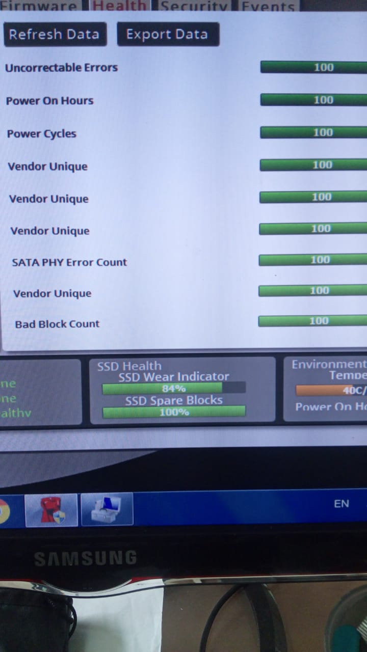

Hi
I used many partitions tool to remove the SSD partitions but fails.I cloned from hard disk to SSD after finished still the old partitions there .Pls any idea to remove of fix the SSD ?

It might have set itself to read-only mode to prevent further data loss. I had such case recently. Check smart first, to find out a bit more about its condition. A secure erase might give you better results, however, i think it is not a reliable device anymore...

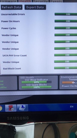

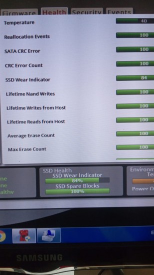

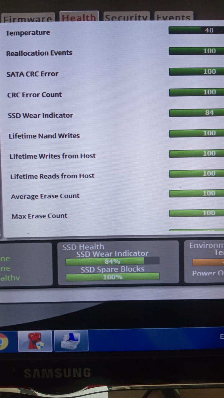

Pls find the attach files
 Post subject: Re: SSD Kingstone 240 gb i cant remove the partions
PostPosted: March 18th, 2021, 8:13
Posts: 4848
it does not look too bad...
