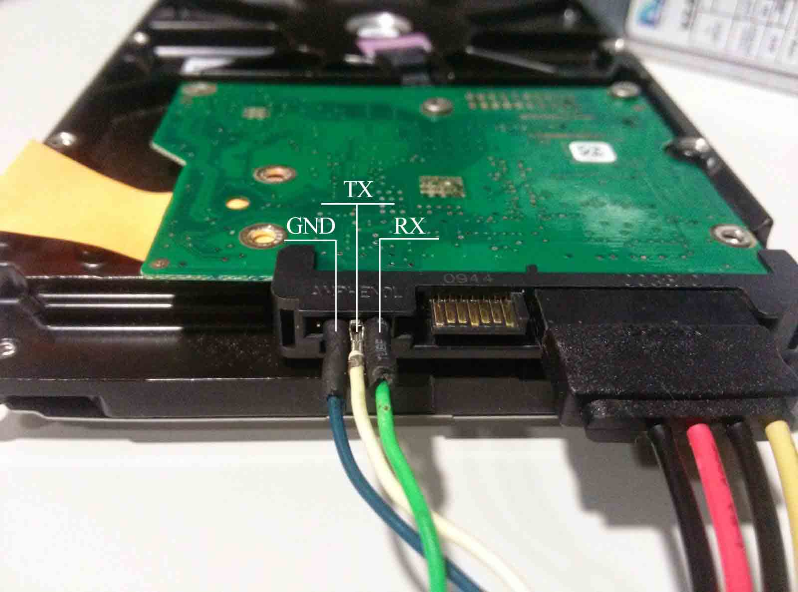

markh0ppus, can you please reupload HDD TTL Connections image?
I have an ST3250310AS hard disk drive and I want to remove the password from the drive in order to use it as an system disk in a computer.
 Post subject: Re: Seagate User Password Unlock (ST3500312CS)
PostPosted: March 3rd, 2016, 7:09
Joined: October 14th, 2013, 11:05
Location: Brazil
stojke here is the pin out.
File comment: HDD TTL Connections

hddguy wrote:
Good job, but in my opinion use of the command 'm0,2....' is a little dangerous and I would not recommenced this to anyone else wanting to remove ATA lock from such drives...
+1
Title is misleading as this refers to the ATA lock solution (discussed to death on the Internet for half a decade now) and not password removal. It's extremely far from the way I would do it but congrats on getting your data back. Love the homemade ttl adapter. Hope this was your own drive and not a customers.

markh0ppus, can you please reupload point 2 images (there should be 2 or 3 images) ?
I have couple of ST3200312CS hard disk drives and I don,t want to waste them.
