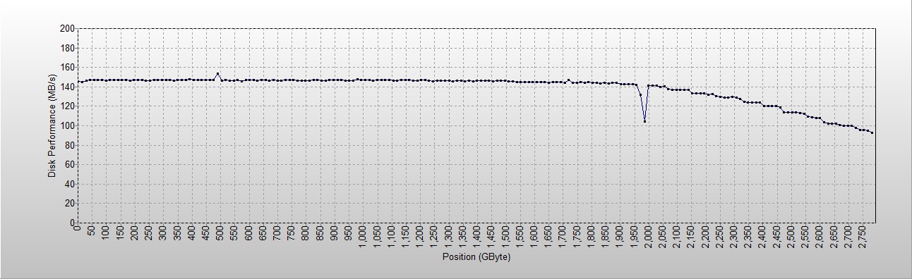

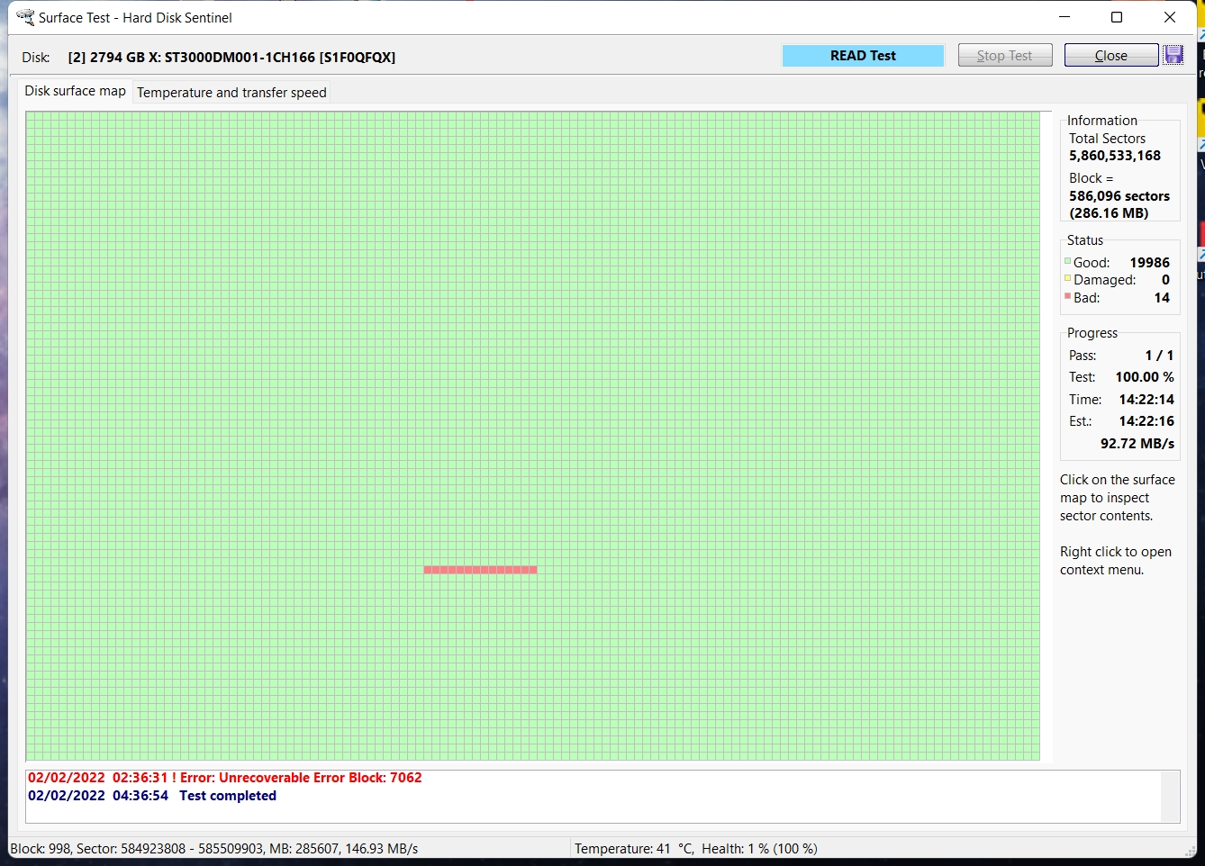

February 1st, 2022, 10:36
:D HDD fixed, all sectors green :D
I did:
T>i4,1,22
T>m0,6,2,,,,,22
T>m0,2,3,,,,,22
1>N1
C>U2
T>m0,3D,,,,,,22
Commands was executed in order them are listed. !!!!All data will be destroyed!!!!
It do Spin up without errors, SMART shows 100% health, I will upload write/read test results when HDD Sentinel finnish testing.

Re: ST3000DM001 LED:000000BD FAddr:00006220
February 2nd, 2022, 6:28
Problem now is that it didn't bypass all bad sectors, anybody knows how to do that manually?
February 7th, 2022, 11:38
MartinStanga wrote:Problem now is that it didn't bypass all bad sectors, anybody knows how to do that manually?
From all sources that I found, I assembled this command m0,41,3,7,7,,,22
It should use both G and P list and skip physically bad sectors, fingers crossed
