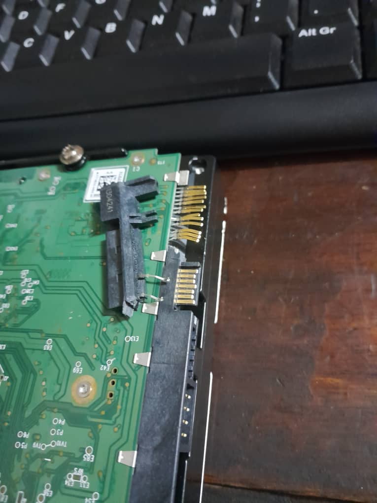

I need the black front of the PCB of the Western Digital disk, 4TB, PCB 2060-771822-002 Rev A. I need the black plastic where the SATA and current cables are plugged to repair a disk.
Please, could someone help me?

To repair it, get an identical PCB or PCB with identical connector and move that connector.
If your board comes from a WD Vivaldi drive you can change PCB, need to move ROM from defective board to the new one.

WD 2060-771822-002 ?? $30 without shipping.

Not help, just providing the right product he asked. Now it's up to him if he hires electronic engineer at $10 to change ROM, or try by himself.
