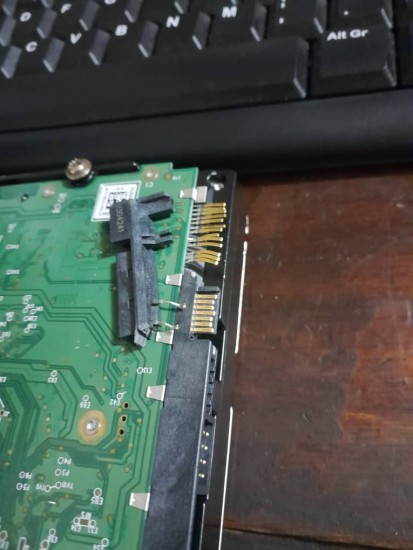

 Post subject: PCB of the Western Digital disk, 4TB
PostPosted: December 5th, 2023, 2:05
Joined: July 31st, 2014, 11:20
Posts: 25
Location: Italy
I need the black front of the PCB of the Western Digital disk, 4TB, PCB 2060-771822-002 Rev A. I need the black plastic where the SATA and current cables are plugged to repair a disk.
Please, could someone help me?
Regards,
Anel
IMG-20230901-WA0001.jpg [ 51.91 KiB | Viewed 8559 times ]
 Post subject: Re: PCB of the Western Digital disk, 4TB
PostPosted: December 5th, 2023, 2:23
Joined: March 6th, 2010, 3:46
Posts: 627
Location: Kolding | Denmark
To repair it, get an identical PCB or PCB with identical connector and move that connector.
If your board comes from a WD Vivaldi drive you can change PCB, need to move ROM from defective board to the new one.
Digitalsupport Data Recovery
https://digitalsupport.dk
 Post subject: Re: PCB of the Western Digital disk, 4TB
PostPosted: December 6th, 2023, 9:40
Joined: September 16th, 2022, 9:31
Posts: 100
Location: World
WD 2060-771822-002 ?? $30 without shipping.
Data Recovery, Remote support & Training https://disksolution.com.pk/
 Post subject: Re: PCB of the Western Digital disk, 4TB
PostPosted: December 7th, 2023, 1:03
Posts: 3975
Disk Solution wrote:
WD 2060-771822-002 ?? $30 without shipping.
helping inexperienced general populus fix their disks? Looks like hanging around here has had a positive effect on you :-)
Noice
 Post subject: Re: PCB of the Western Digital disk, 4TB
PostPosted: December 7th, 2023, 12:12
Joined: September 16th, 2022, 9:31
Posts: 100
Location: World
HaQue wrote:
Disk Solution wrote:
WD 2060-771822-002 ?? $30 without shipping.
helping inexperienced general populus fix their disks? Looks like hanging around here has had a positive effect on you :-)
Noice
Not help, just providing the right product he asked. Now it's up to him if he hires electronic engineer at $10 to change ROM, or try by himself.
Data Recovery, Remote support & Training https://disksolution.com.pk/
Users browsing this forum: No registered users and 243 guests
