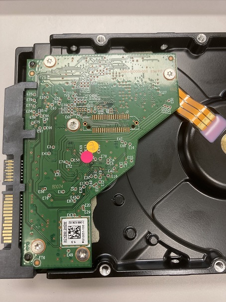

I found EAZZ drive cover's photo and I think this type's not match...
I attached patient EAAZ drive cover and PCB's photo.
The attachment IMG_0022.jpg is no longer available
File comment: PCB

WX72D22PT0DK
NO LIMITED WARRANTY
WD60EAAZ-22BLVB0
VENICERP <-- family
5040 RPM <-- should this be 5640 RPM ?
256M
SATA3 6GB/S
6.0 TB
6HD/3D
WHITE LABEL SECOND TIER OEM
EAZZ uses the 2060-810032 PCB.
EAAZ uses the 2060-810051 PCB.
EAAZ has a higher areal density (1TB per head versus 0.8TB per head).

There is some confusion I think
WD WD80EAZZ is an AvalonC5 family, I haven't seen WD80EAAZ yet.
WD WD60EAAZ - is a VeniceRP family, you could try VeniceR heads (but I haven't tried them myself yet, so I don't know if they are truly compatible)

Dommer: Thank you reply for my question, I checed WD60EDAZ's cover and purchase it.
fzabkar: I am sorry to write wrong drive type, It not WD80EAAZ and thank you for information.
I will try to change Head and I hope its readable.
