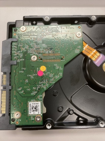

 Post subject: Anybudy know about matched WD60EAAZ heads?
PostPosted: December 11th, 2023, 20:13
Joined: June 30th, 2020, 3:27
Posts: 14
Location: Japan
Hi guys,
I am try to recover WD WD80EAAZ drive now, its sweep look like well and respond good type,SN,Value but can't read customer's data.
So I tried to unlock ROM but drive can't spin up when PC-3000 unlock method. I asked ACE TS and receive answer to nonsupport yet this type. I will try to haed assy swap about this drive but I can't find WD80EAAZ drive on market. So i would like to know its same as EZRZ drive or others. Any one know it?
A1 Data Corp
M Ogata
 Post subject: Re: Anybudy know about matched WD60EAAZ heads?
PostPosted: December 11th, 2023, 20:25
Posts: 17230
WD80EAZZ-00BKLB0
AVALONC5 <-- family
5640
128M
SATA3 6GB/S
8.0 TB
10HD
STD
 Post subject: Re: Anybudy know about matched WD60EAAZ heads?
PostPosted: December 11th, 2023, 20:50
Joined: June 30th, 2020, 3:27
Posts: 14
Location: Japan
Hello fzabkar
Thank you for reply about my question. I don't have WD80EAZZ drive,so will purchase today.
M Ogata
 Post subject: Re: Anybudy know about matched WD60EAAZ heads?
PostPosted: December 11th, 2023, 21:06
Joined: June 30th, 2020, 3:27
Posts: 14
Location: Japan
I found EAZZ drive cover's photo and I think this type's not match...
I attached patient EAAZ drive cover and PCB's photo.
The attachment IMG_0022.jpg is no longer available
File comment: PCB
IMG_0023_2.jpg [ 134.9 KiB | Viewed 6655 times ]
M Ogata
 Post subject: Re: Anybudy know about matched WD60EAAZ heads?
PostPosted: December 12th, 2023, 12:53
Posts: 17230
WX72D22PT0DK
NO LIMITED WARRANTY
WD60EAAZ-22BLVB0
VENICERP <-- family
5040 RPM <-- should this be 5640 RPM ?
256M
SATA3 6GB/S
6.0 TB
6HD/3D
WHITE LABEL SECOND TIER OEM
EAZZ uses the 2060-810032 PCB.
EAAZ uses the 2060-810051 PCB.
EAAZ has a higher areal density (1TB per head versus 0.8TB per head).
 Post subject: Re: Anybudy know about matched WD60EAAZ heads?
PostPosted: December 12th, 2023, 13:09
Posts: 17230
There are significant differences between WD80EAAZ and WD80EAZZ:
https://documents.westerndigital.com/content/dam/doc-library/en_us/assets/public/western-digital/product/internal-drives/wd-blue-hdd/product-brief-western-digital-wd-blue-pc-hdd.pdf
 Post subject: Re: Anybudy know about matched WD60EAAZ heads?
PostPosted: December 12th, 2023, 13:41
Posts: 3593
Location: Chicago
TADASHI wrote:
Hi guys,
I am try to recover WD WD80EAAZ drive now, its sweep look like well and respond good type,SN,Value but can't read customer's data.
So I tried to unlock ROM but drive can't spin up when PC-3000 unlock method. I asked ACE TS and receive answer to nonsupport yet this type. I will try to haed assy swap about this drive but I can't find WD80EAAZ drive on market. So i would like to know its same as EZRZ drive or others. Any one know it?
A1 Data Corp
M Ogata
There is some confusion I think
WD WD80EAZZ is an AvalonC5 family, I haven't seen WD80EAAZ yet.
WD WD60EAAZ - is a VeniceRP family, you could try VeniceR heads (but I haven't tried them myself yet, so I don't know if they are truly compatible)
VeniceR drives example
WD60EMAZ-11LW3B0
WD60EDAZ-11U78B0
Ogata san, ganbatte kudasai
 Post subject: Re: Anybudy know about matched WD60EAAZ heads?
PostPosted: December 12th, 2023, 22:41
Joined: June 30th, 2020, 3:27
Posts: 14
Location: Japan
HEllo,
Dommer: Thank you reply for my question, I checed WD60EDAZ's cover and purchase it.
fzabkar: I am sorry to write wrong drive type, It not WD80EAAZ and thank you for information.
I will try to change Head and I hope its readable.
M Ogata
Users browsing this forum: Google [Bot] and 283 guests
