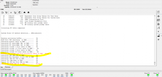

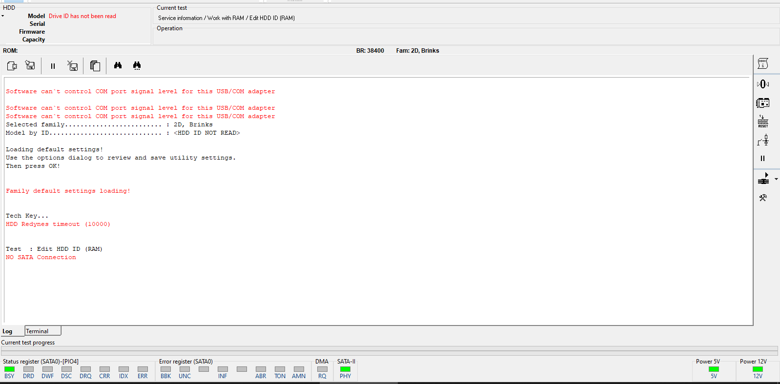

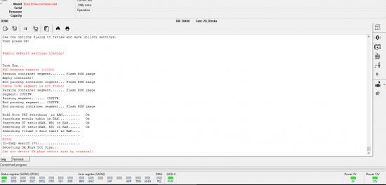

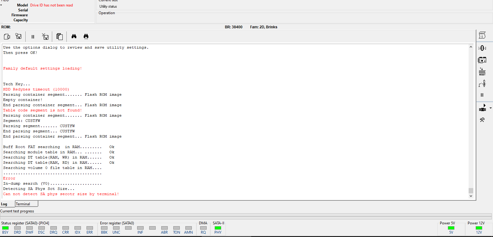

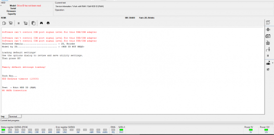

Hard Disk is ST3320613AS / CC2H ~ Brinks Family.
While disk gets detection and I have been able to read some system files too. While imaging in DE disk starts clicking and becomes busy with detection loss.
I think it could be SA defects or weak failing heads. Customer has few photos to be recovered so its low cost FW job only .
I can't change settings in sys 93 (SMP) as drive starts clicking .It has something to do wit MC.
Any tip or trick I can try?
Here is Terminal & full log

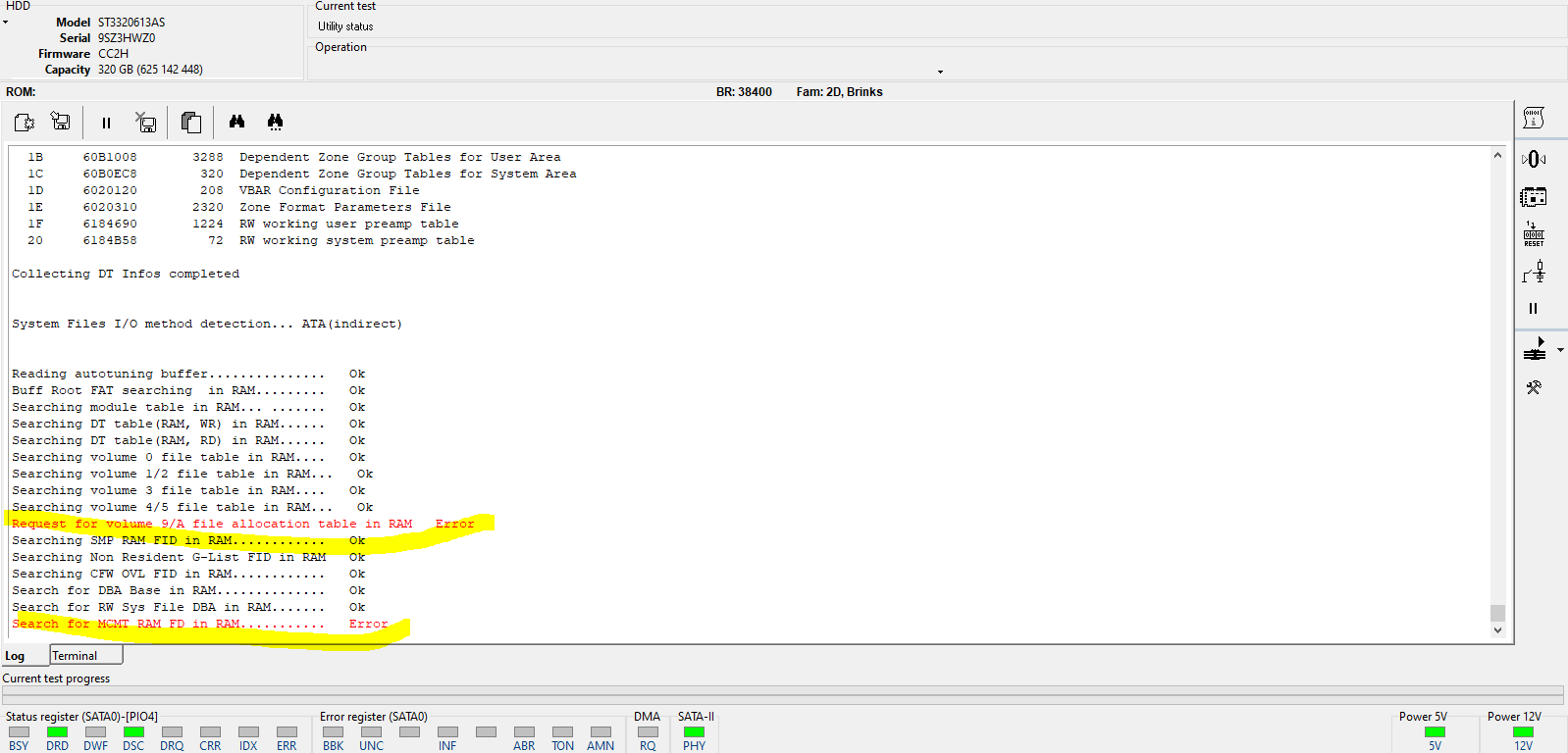

System Files I/O method detection...
ATA(indirect)
Reading autotuning buffer...............
OkBuff Root FAT searching in RAM.........
OkSearching module table in RAM... .......
OkSearching DT table(RAM, WR) in RAM......
OkSearching DT table(RAM, RD) in RAM......
OkSearching volume 0 file table in RAM....
OkSearching volume 1/2 file table in RAM...
OkSearching volume 3 file table in RAM....
OkSearching volume 4/5 file table in RAM...
OkRequest for volume 9/A file allocation table in RAM
ErrorSearching SMP RAM FID in RAM............
OkSearching Non Resident G-List FID in RAM
OkSearching CFW OVL FID in RAM............
OkSearch for DBA Base in RAM..............
OkSearch for RW Sys File DBA in RAM.......
OkSearch for MCMT RAM FD in RAM...........
Error

******************** 5/9/2024 2:14:50 AM ********************
Software can`t control COM port signal level for this USB/COM adapter
HDD family detecting...
Family ID: 2D
Selected family......................... : 2D, Brinks
Model by ID............................. : ST3320613AS
Loading default settings!
Use the options dialog to review and save utility settings.
Then press OK!
Family default settings loading!
Tech Key...
Requesting FW Pkg ver ........
BR140D.CCD2.CG0H0H.CC2H
Detecting SA Phys Sct Size...
Result.................................. : 512
Detecting UA Phys Sct Size...
Detecting Max Head number...
Phys. heads............................. : 2
Obtaining Saved Mode Pages File information...
Reading Saved Mode Pages...
Parsing Saved Mode Pages...
SMP Dbl: 0x3C000317 - 0x037FF7FF (0x0000000F)
LBA alignment........................... : 0
Obtaining Registry File information...
Reading Registry File...
Parsing Registry File...
Media Cache
MC is not supported / NVC caching
Collecting Sys Files information...
ID Len
0 4 Reserved Defect Table (SA defect table)
1 2 Drive Information File (DIF)
2 16 Performance Parameter File (PPF)
3 3787 Primary Defect File (P-List)
4 12 Servo Adaptive Parameter File (SAP)
5 4 Manufacturing Information File (MIF)
6 66 Read Adaptive Parameters File (RAP)
7 1 Controller Adaptive Parameters File (CAP)
8 4800
9 1 SMART Configuration File
A 2251 SMART Data File
B 1000
C 64000 Serial Port Test Results File (Self Scan Log)
D 160
E 432 Data Integrity Check (DIC), HEAD 0
F 223 DIC Dummy File
13 8 Disc Registry File (settings, security, etc)
15 100 BGMS File (Directed Offline Scan)
16 2
17 40
19 24 Log File
1A 33 Log File
1B 1 Log File
1C 9
1D 128 Physical Overlay File 0
1E 128 Physical Overlay File 1
1F 640 Physical Overlay File 2
22 80 Drive Self Test (DST), Head 0
23 80 Drive Self Test (DST), Head 1
2A 9 Saved Mode Pages (HDD settings)
2B 928 R/W Operating Parameters (translator, etc)
2C 432 Data Integrity Check (DIC), HEAD 1
33 4576
34 640 Packed CONGEN XML definition
35 26 SMART Data
3A 4
Collecting Sys File Infos completed
Collecting DT Infos...
ROM:
ID MemOffs Len
0 6020100 33792 Read Adaptive Parameters File (RAP)
1 6020000 256 Controller Adaptive Parameters File (CAP)
4 4001000 4096 Servo Adaptive Parameter File (SAP)
602BE00 4096
total 8192
5 6C000 81920 Servo Firmware Table
A 60A6CF8 1024 Seek Profile
13 60B1CE0 544 Dependent Zone Table for User Area
14 60B1F00 64 Dependent Zone Table for System Area
15 0 524288 Flash ROM
1B 60B1008 3288 Dependent Zone Group Tables for User Area
1C 60B0EC8 320 Dependent Zone Group Tables for System Area
1D 6020120 208 VBAR Configuration File
1E 6020310 2320 Zone Format Parameters File
RAM:
ID MemOffs Len
2 60201F0 288 Zone Table
602BE00 4096
total 8192
ATA(indirect)
ErrorHDD Redynes timeout (10000)

 Post subject: Re: Brinks on the Brink - Pls salvage
PostPosted: May 12th, 2024, 8:09
Posts: 548
Location: brisbane
Hi northwind , Happy Weekend
Thanks for responding.
Yes when powered while entering utility it does not click but when tried to read ID or while performing any activity it starts clicking but does not spin down.
I am worried whether my diagnostics itself could be wrong ,I am mistaken some unknown reason for clicking as head crash.
PostPosted: May 13th, 2024, 8:15
Posts: 548
Location: brisbane
Update
While entering utility I have given path of earlier saved system files & now disk has stopped clicking for some time but begins later. I am checking matching pcb , I suspect something could be wrong in pcb as well ,just to rule out possibility.
