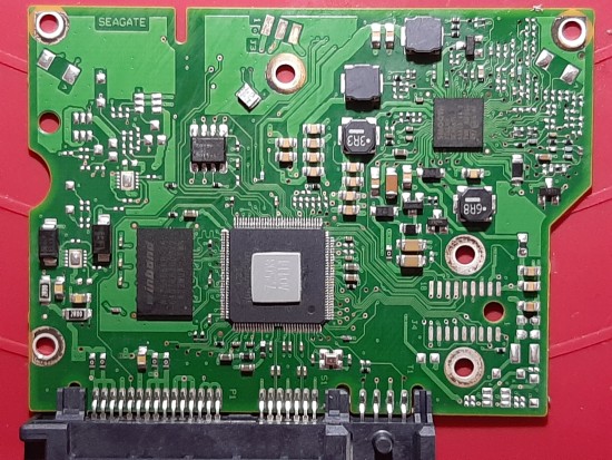

 Post subject: Re: Seagate Barracuda ST2000DM001 (2000GB)
PostPosted: June 11th, 2024, 3:04
Joined: June 6th, 2024, 4:22
Location: Italy
I post here a little update
I took the original PCB and I've mounted back the original BIOS chip
The HDA contacts was a bit oxidized and I cleaned them with an eraser and isopropyl alcohol. When I put the disk in the system the initial spinning sound can be heard but the diagnostics is always the same: No hard disk found
I've also check with a digital multimeter most of resistors, diodes and fuses and I cant find any obvious problem
As I said, with a new identical PCB but with a different BIOS chip, the system recognize the disk but with a wrong size
In attach the PCM image
Thanks in advance
